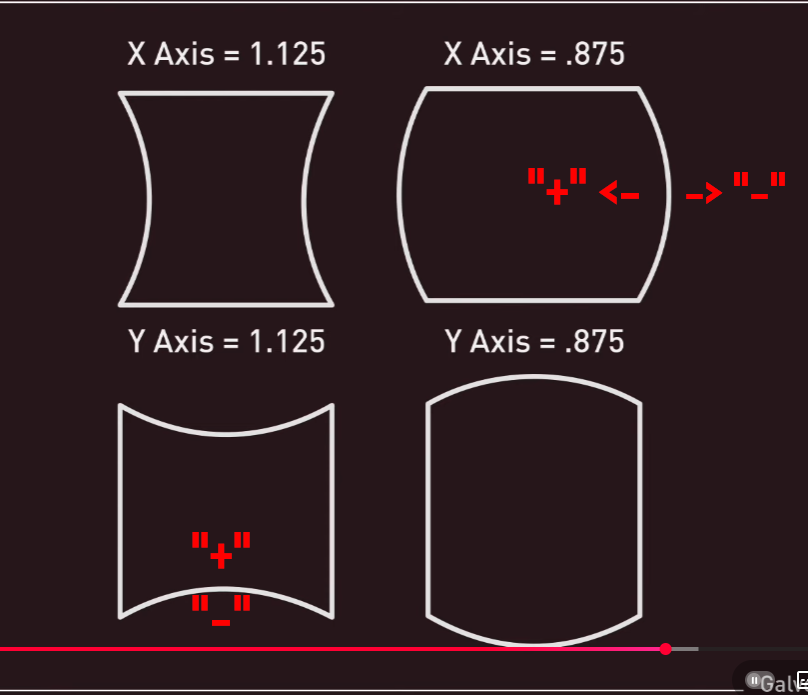

Also being a newbie with galvos, I had to struggle with the parameters for bulging, slant and trapezoid, which seemed to have sideeffects between themselves. But firstcof all it would be great to have help pop up with a graphics showing which change of parameters (lower / higher) has what effect. I had to make screenshots of your ancient (helpful, but not really up to date) video at youtube to be sure I chose the right direction …

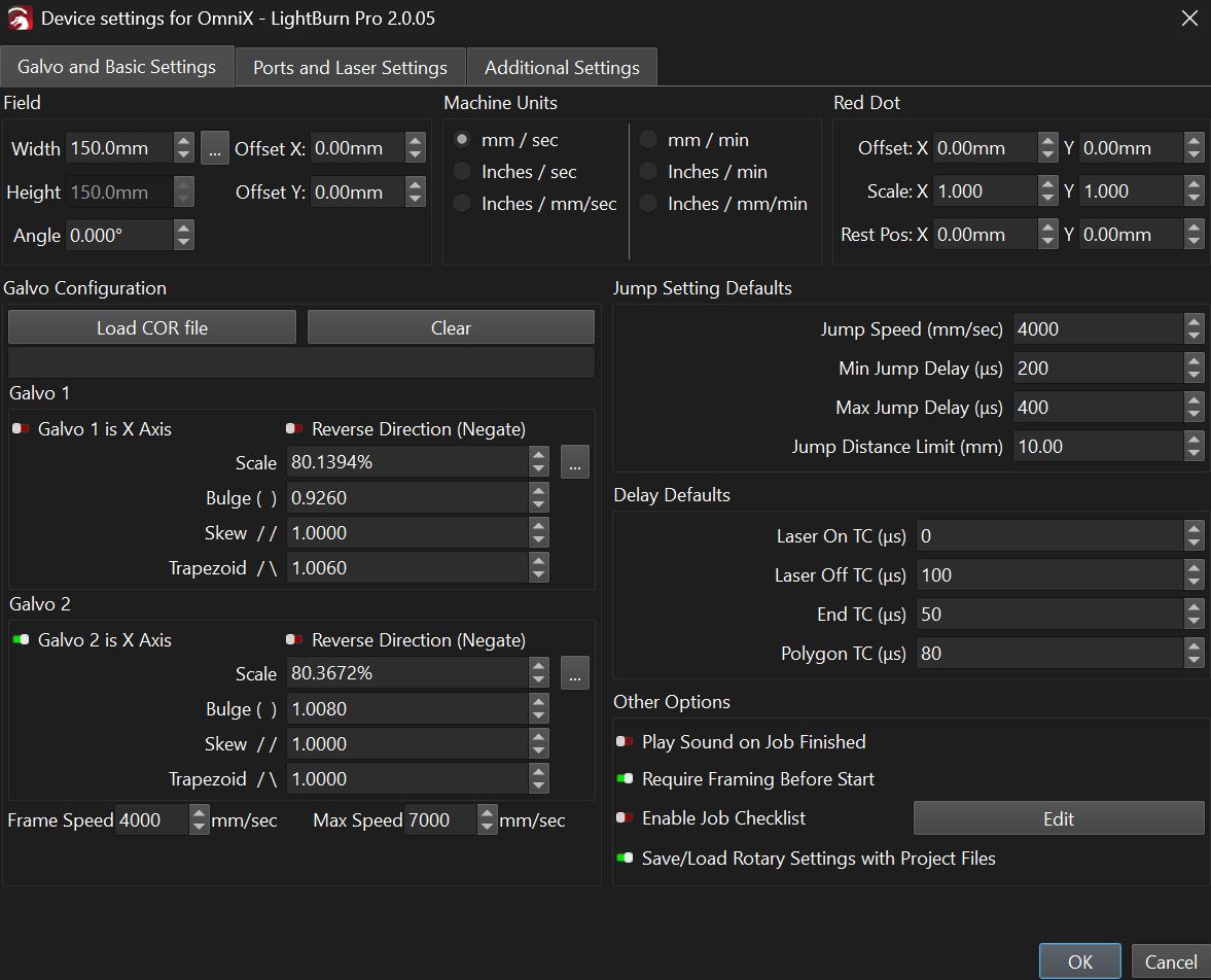

I don’t know whether it helps other Omni-X users (5 Watt UV Laser), but maybe this can serve as an orientation for calibrating:
Omni X 70x70 lens:
Omni X 5W 150x150 lens:
And the screenshots I took from the (“medieval”) LightBurn Video: LightBurn Galvo Lens Correction Guide (YouTube)

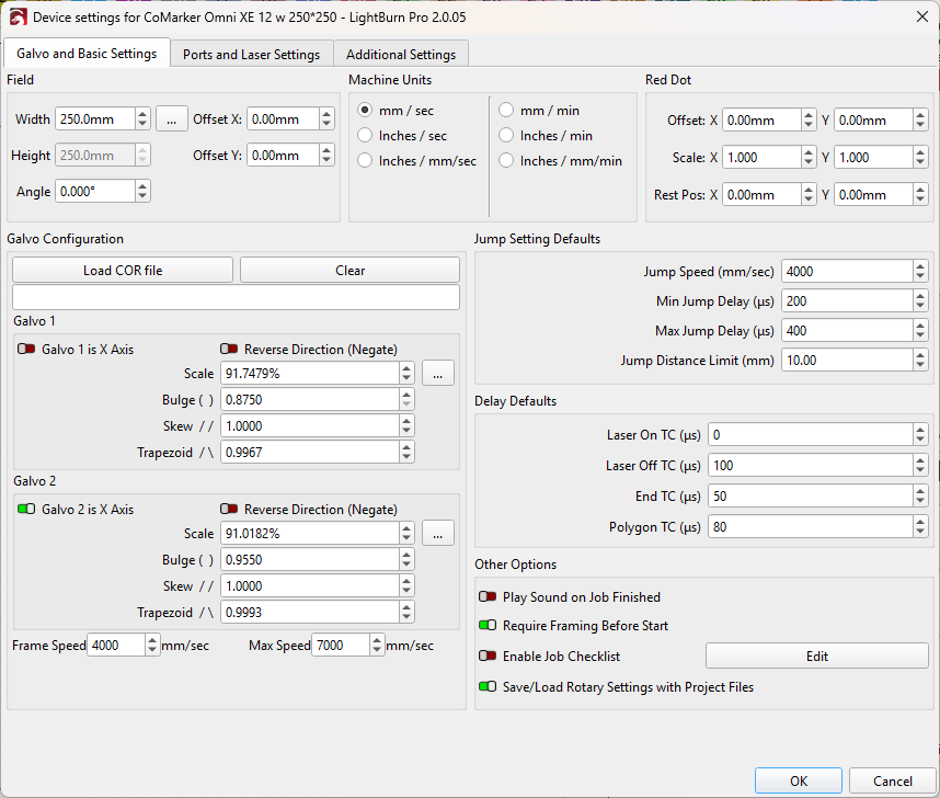

I have the new Onmi XE. the 12 Watt comes withe 250mm lense. I had no problen callibrating the 70mm but 250 is another story. The 9 point cal just isnt working. The scaling is way off. Im following this feed to see if anyone has found a fix.
9 point calibration often isn’t enough for super long lenses - a 25 point calibration is in the works to address this.

As Colin suggests to try it manually, why shouldn’t you start with one of the value presets above. Buy some black paper and after an hour you should have gotten a quite good setting for your Omni X.

Finally came up with settings. this was done manually
