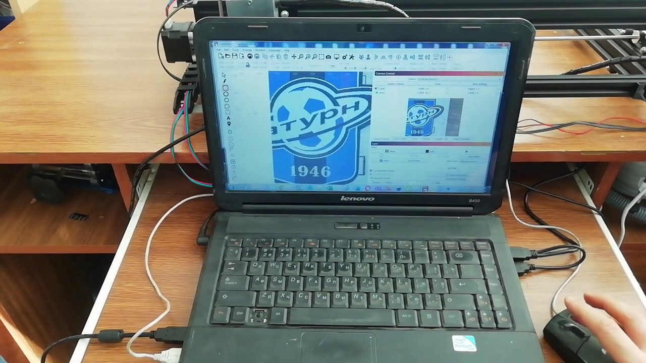

I have an idea that the camera should be aligned at the height of the work … You have the alignment on the table, but the engraving plane is much higher …
