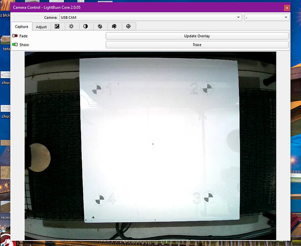

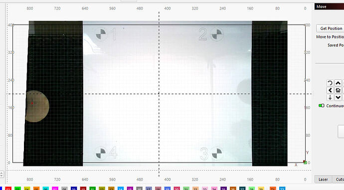

algo laser camera showed full bed in old version, now with up date some of it doesn’t show
have done recalibrate like 3 times camera set to standard as per algo set up video
when doing calibrate lens it looks really fish eyed , in old version was more flatter
can just see lazer left middle , but see how far center cross hair is out and when doing moves over numbers it is out my nearly 20 mm
MOVE ISSUE:
another thing i found feed rate is 0 every time LB is started old federate doesn’t save

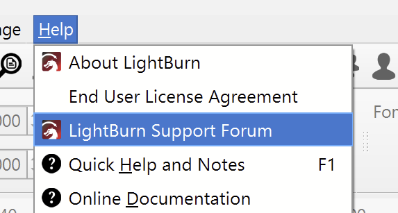

one more thing when clicking help forum , it now takes you to docs not forum

See if it helps, if you calibrate the camera lens with the new AprilTags card. The dots pattern should no longer be used.
Please follow the instructions for camera calibration with Tracking to see if it solves it for you too: Calibrate Camera Lens (Labs) - LightBurn Documentation
This feature is still in testing (Labs feature), but is currently the most precise way to calibrate your camera. It’s only accessible with a right click on the “Camera” window:
After this, perform another Camera Alignment as usual. You’ll need to engrave a new set of the four target markers. (Don’t use the old ones): Calibrate Camera Alignment - LightBurn Documentation

I can’t confirm this. This option correctly points to forum.lightburnsoftware.com

i used the april tag in latest update
which latest release do you recommend to use ?
will try the tag tracking option and see what happens
any idea why the preview when doing calibration is fisheyed in new version and not flat like in old version when ive clicked on standard, is this how it is meant to look now ?

2.0.05 is the latest release.
You could also try the PreRelease version 2.1 RC-2 . But it includes quite a few changes regarding camera setup, and the UI is not fully finished or documented yet.
I’m not sure which preview you mean here. Can you post a screenshot to explain?
