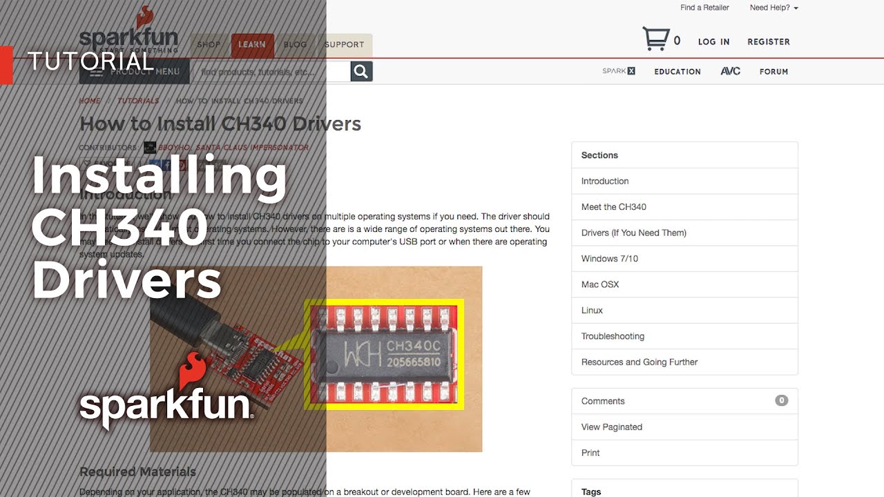

I use Linux, but there’s a utility that I use often, ‘lsusb’ apparently there is a similar animal in windows
 Might give this a shot
My little CNC shows ‘QinHeng Electronics HL-340 USB-Serial adapter’ with lsusb.
try also to follow this tutorial
