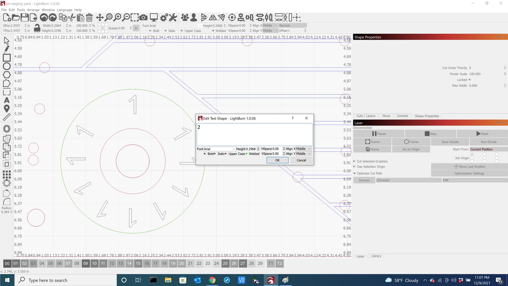

I make a circle and run numbers around the circle and if I do 1,2,3,4,5,6,7,8,9,10,11 Some number when I edit the text the number are distorted or missing. I been able to repeat ths BUG?

I trying to build and circle array starting 1 to 11. I try to edit the second number and it in these screen shots

I tried changing a few things. It may be a windows thing. Still not working-See picture 3 The number 2 disappears when I edit the numbers 1 to 2. and after I edit the number and confirm by entering the 2 disappears Not all numbers disappear. I tried a new drawing and it worked. It something in my file?

I found the bug. When I zoom in the 2,3 etc numbers disappear. If I zoom out the all the numbers appear.

Oh… I just recreated the issue. It’s only there if you edit the text from Edit Text Shape dialogue.
@Rick, something to take a look at.
Here’s what things look like right before opening the “Edit Shape Text” dialogue:
Then the ‘2’ disappears as soon as select “Edit Text Shape”:
It does not come back after hitting OK.
This is on version 1.0.06.
I can confirm this aspect of the bug as well. That’s weird. It reappears after zooming out to a certain level:
When visible, the number isn’t fully selectable but it does show some sort of blue dot handle:
If I move the blue dot, I can then select and move the number:

Also, @adeak1rr I don’t think I made it clear but I never saw the issue because I edited the numbers directly. As in double clicking on the number and editing in-place. The issue never arose there. You can use that method as an alternative to allow you to keep moving.

I am currently running a beta candidate (hint: note title bar :wink:) and I’m unable to reproduce. The issue may have been addressed already in this version, so I will check.
In the morning, I’ll try again with 1.0.06.
(results with your [prr staging yard] file, using 1.1.00 beta on mac)
