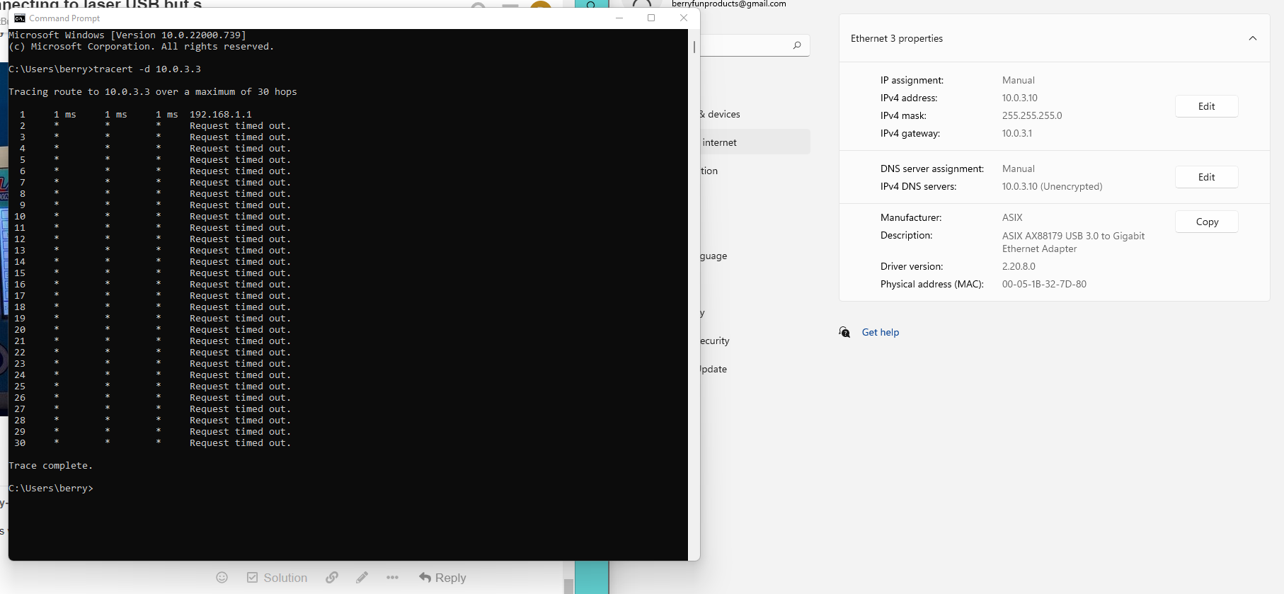

Did you already do this? If not, can you do it and then rerun the ping.
If you already did this, can you run this in command prompt:
tracert -d 10.0.3.3
Also, confirm that your computer and controller are connected through ethernet. Are there 2 lights on each side flickering?
i can only see mine on the computer side but i have a green and orange on my side

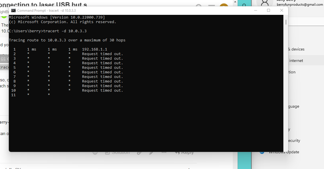

Can you run the tracert command from the previous post and return results? This should be working at this point assuming that the controller is setup.
and it’s still going same thing

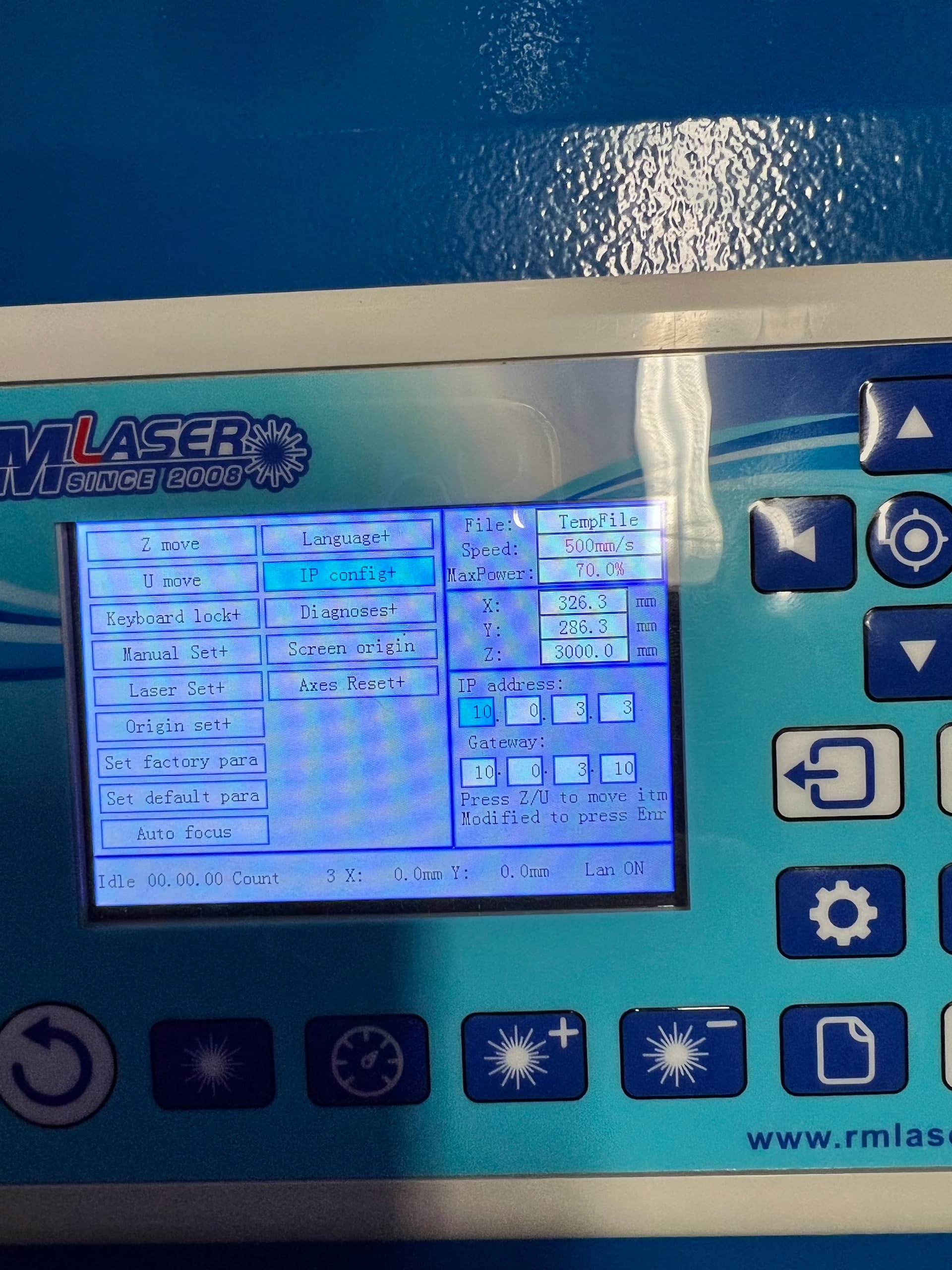

this is what my controller is set to right now
Somehow the connection to the laser is getting routed through your other network which we don’t want in this case.
Make one change please. Go back to your Manaul IP configuration and change the gateway to 10.0.3.3.

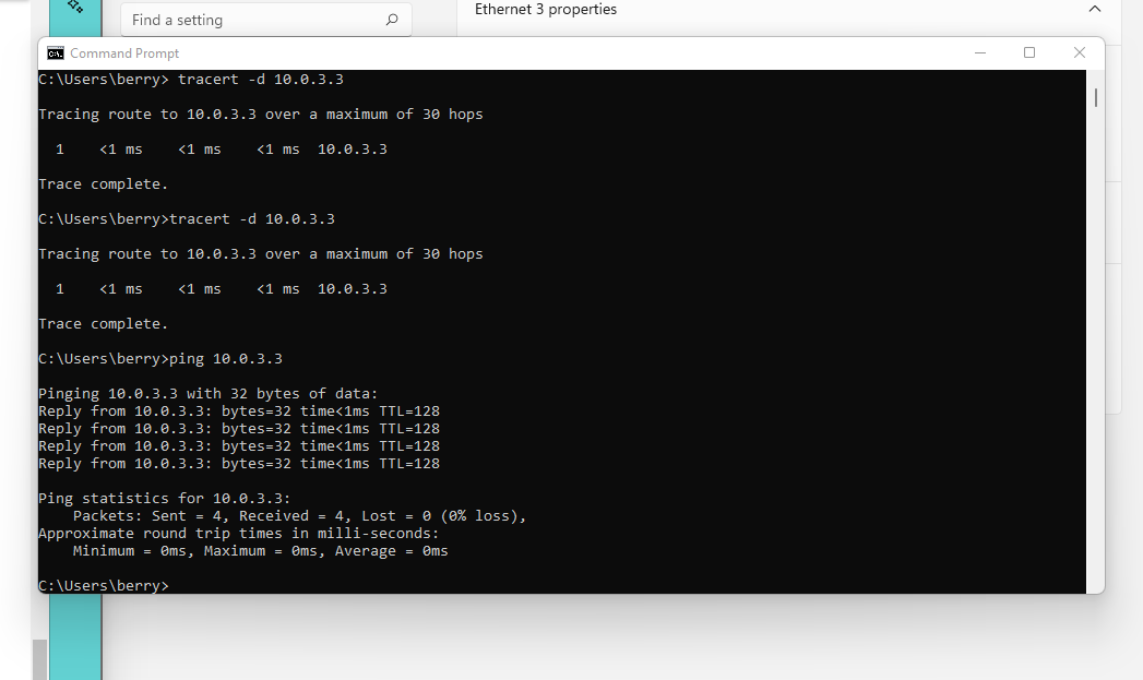

so i just plugged right into the control board or whatever it is and this is the results i got running both test
i opened up the machine right now and didn’t go through the back of the machine ports
This is what you want. I suspect it should work now.

oh my goodness - it is showing me my laser and ready so i am going to try to do something on light burn for the first time

Set the computers Ethernet port to the Ruida ‘gateway’ and use the Ruida IP to talk to it from Lightburn.
The gateways on each side are pointing to each other respectively so I think @Berry-Fun-Products should be good.
yes thank you again we are up and running - now i am just needing to learn how to run lightburn and use all the features. Thank you again for your help. we are just plugged straight into the controller through ethernet :slight_smile: :grin: :grinning:
