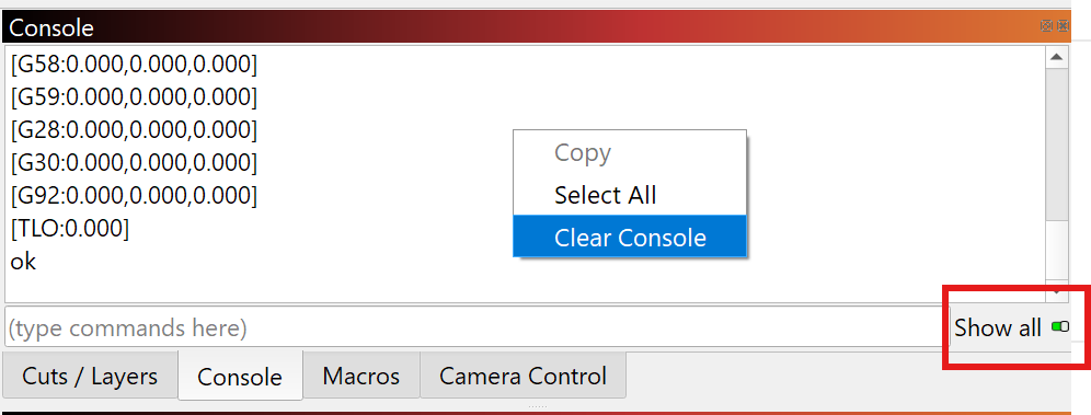

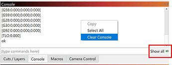

Please run this test:
to update my last answer, the air assist only worked for 2 seconds after the first M8 was entered I didn’t have enough time to enter the second one. When I did the air assist as off; and putting in the command again it turned back on for 10 seconds (with an additional M8 there after 5 seconds which didn’t change anything)
Full Output Below. After first M8 air assist only stayed on for 2 seconds; I tried it again and it stayed on for 10 seconds then shut off. I agree firmware bug looks likely but I am on latest, any idea what ticket or where they are with a fix - or any bug ticket numbers I can use to ask them?

And the test
Summary
$i
