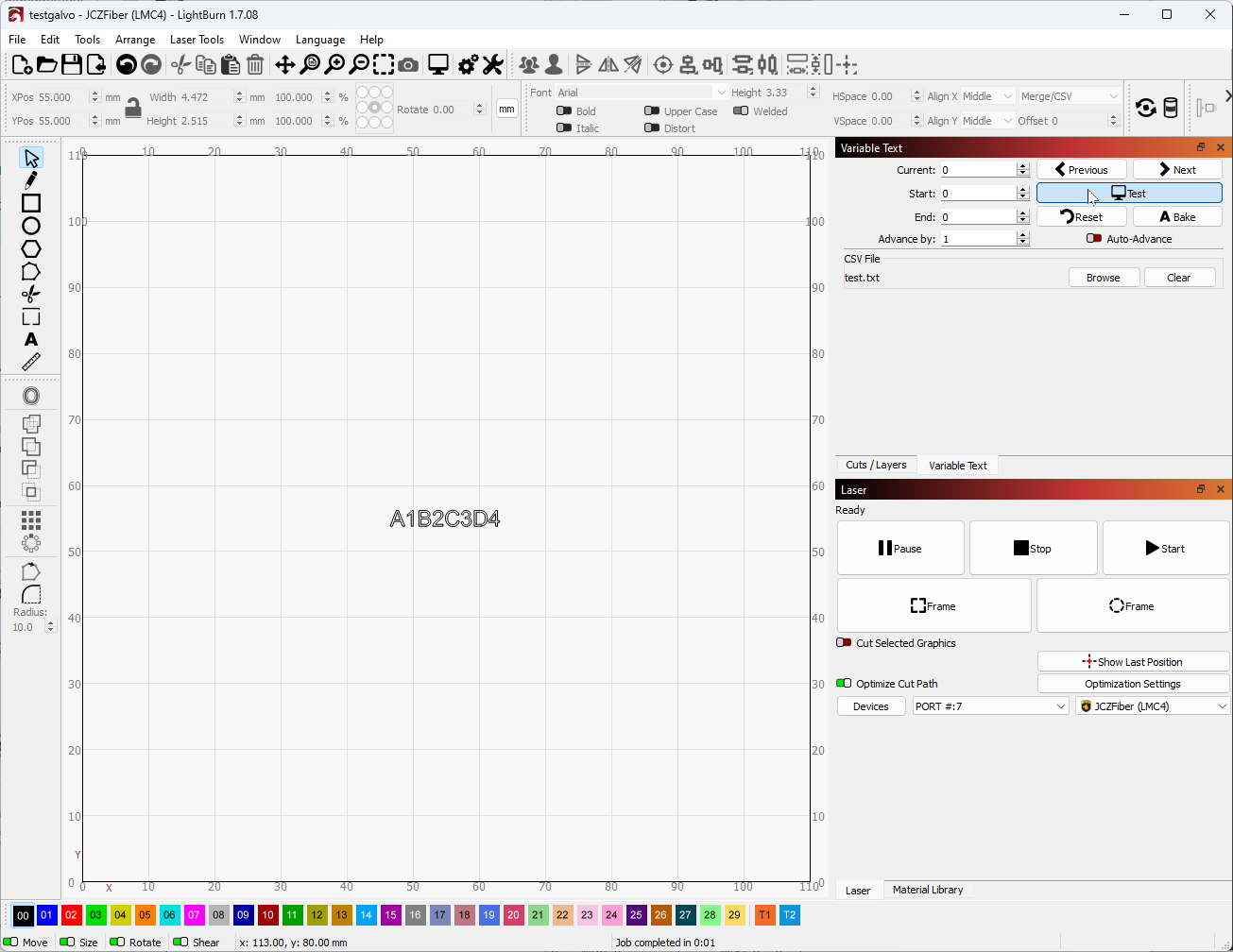

Here is a very basic example of a Python script that tells Lightburn to ‘Start’ whatever job it has loaded:
import socket
sock = socket.socket(socket.AF_INET, socket.SOCK_DGRAM)
sock.sendto(b"START", ("127.0.0.1", 19840))
For example,
(1) Have LightBurn open and variable text set to read the first column of “test.txt”.
Disable ‘Require framing before start’ in Device Settings.
(2) Write/Save ‘A1B2C3D4’ to test.txt file using any external program.
(3) Send the ‘START’ UDP message to LightBurn - Python is useful for this (as above).
If you don’t have Python setup just paste the line below into the Win+R Run dialog:
powershell -Command "$c=New-Object System.Net.Sockets.UdpClient; $d=[Text.Encoding]::ASCII.GetBytes('START'); $c.Send($d,$d.Length,'127.0.0.1',19840); $c.Close()"
The job should output immediately with the new text, now you cycle back to (2), rinse and repeat.
