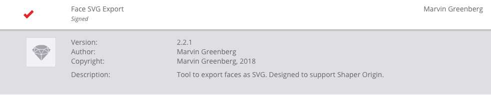

I use Sketchup, a lot, for buildings, mechanical devices, etc. Don’t use PDF - use a vector exporter.
I use this extension - available through the extension manager - and export vectors with zero problems.
