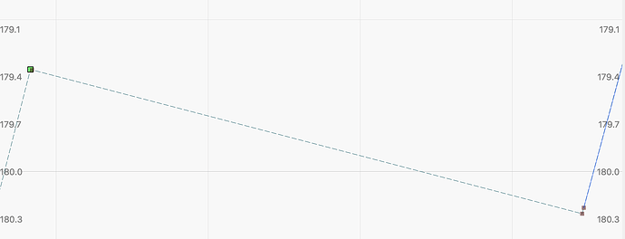

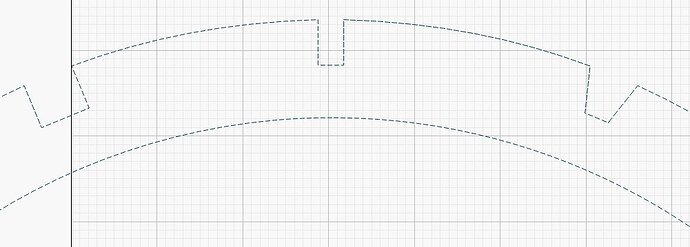

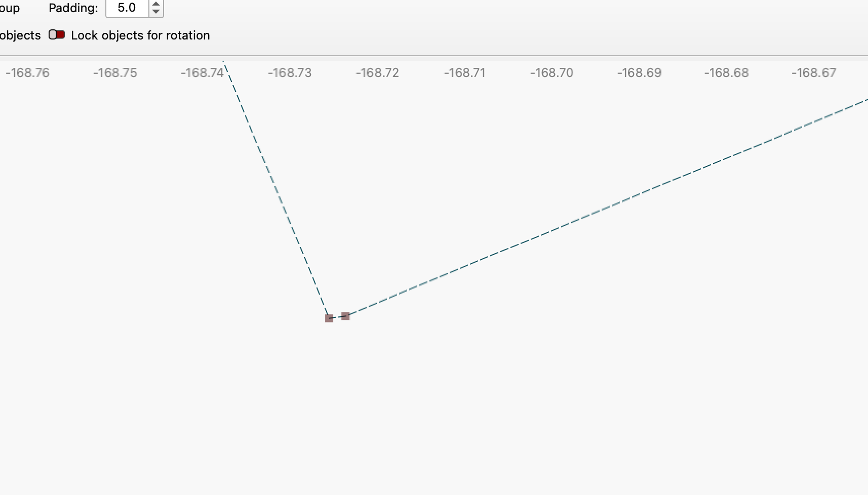

Your file has many “errors” that need to be fixed first before you can use the resizer tool. Here is a small example.

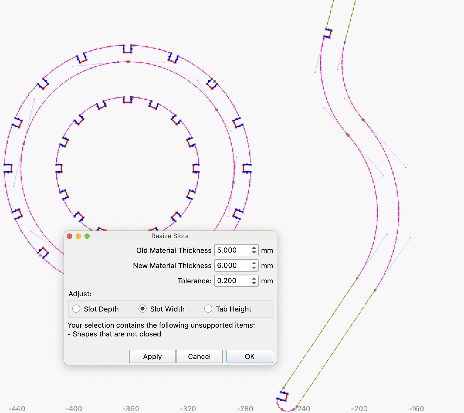

Hello,

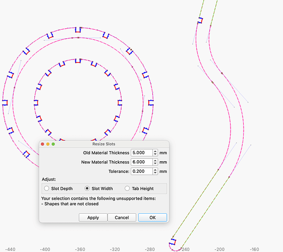

I tried it… it actually doesn’t work, see screenshot.

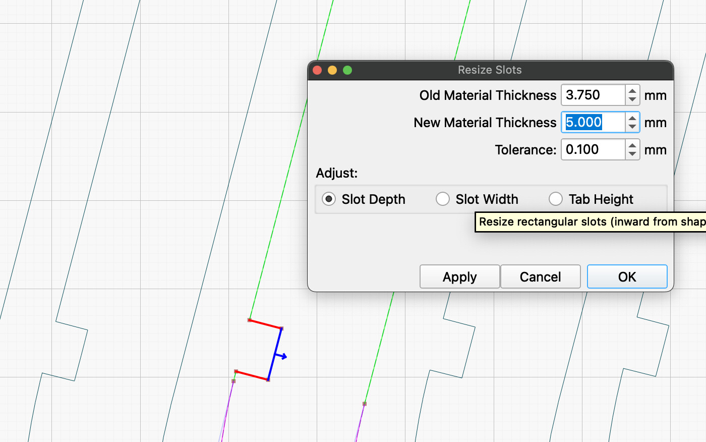

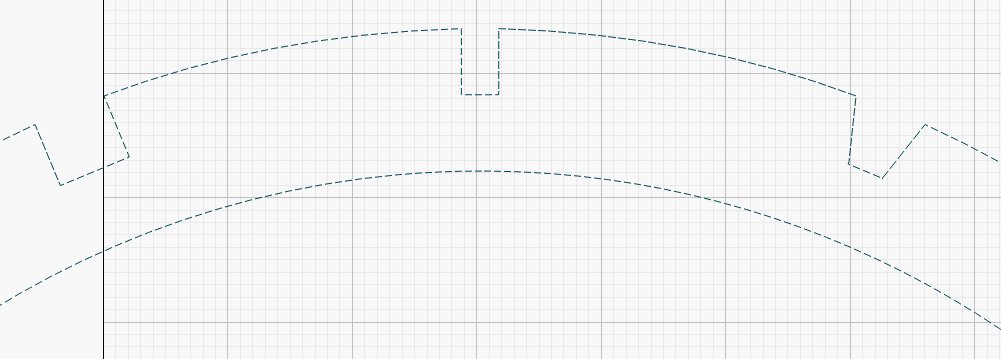

For the resize slots tool there must be exactly 4 nodes, parallel(ish) to each other and straight lines, no curves. No more, no less. This file has additional nodes in the slots area and the length is not a straight line, it is a slight curve.
Remove the extra nodes and the tool works.
This is just one slot. You will need to check each one individually and repair as necessary.

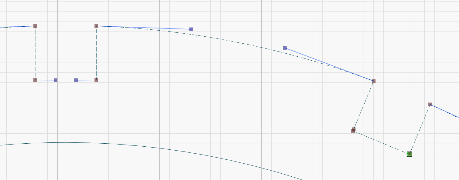

In this section, the top one has a curve along the bottom, the one on the right isn’t a curve, but has extra nodes. It will take a while to fix this file. Unfortunately, this is often the problem with purchased files.

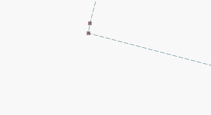

Thanks for this… I think what I am struglging with is seeing tese extra nodes and successfully removing them, without breaking the piece completely.
Perhaps in a short sentence you can explain exactly how to remove the extra nodes.

In node editor zoom in to identify the extra nodes, decide which one needs to be removed, click on it then press the D key on the keyboard. This will remove the selected node. You can also just hover over the node and press D, but if you inadvertantly have something else selected that will be deleted instead, which is why I suggest clickong on the node to be sure that’s the one being removed.
If vyou have a curve (identified by the handles) without an extra node, click that line and press the L key. That will restore the curve to a straight line.
