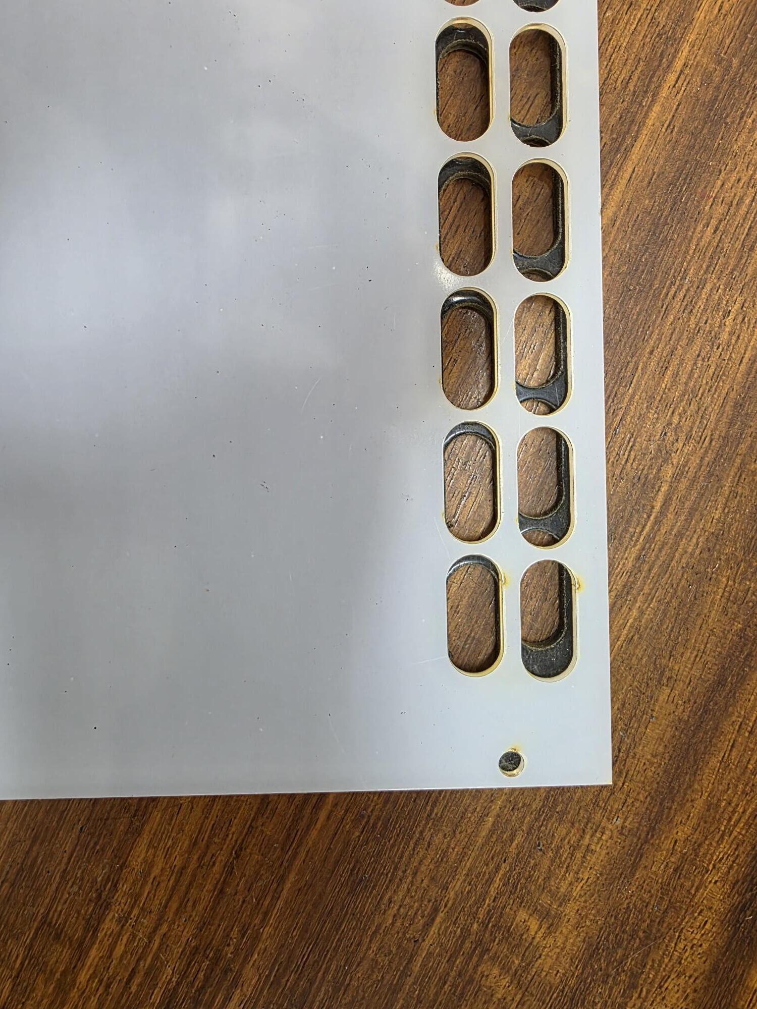

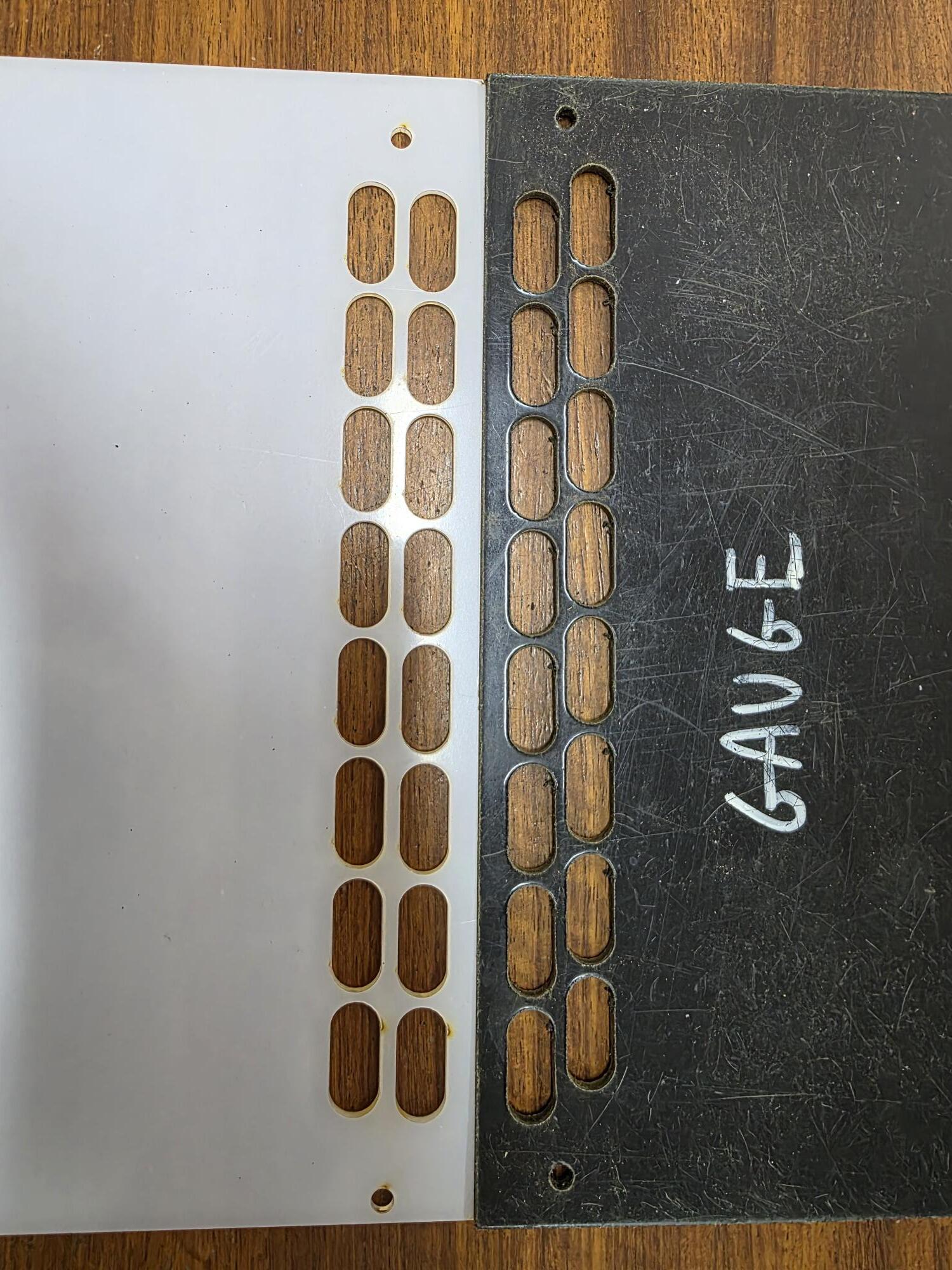

I am constantly having issues with my Koenig K1325 cutting wrong dimensions/tolerances when cutting multiple identical parts on the one sheet. Its randomized from sheet to sheet in terms of where it goes wrong. I have ensured sheets not moved, we have replaced belts, replaced sprockets and yet still getting random anomalies as if the software is sending the wrong sizing. Seems to make no difference between sending the drawing directly from the PC or sending it to the machine first.

I have switched it over to ethernet and see if we get a different result. Thanks for the advice. Here are some misalignment examples - the external dimensions are all right as are the dimensions of the slot ID’s but their alignments are all wrong. Its strangely randomized - meaning cuts further into the sheet are right so it’s not like it’s all wrong from a certain point or that the material has moved.
Assuming the machine has a Ruida-flavored controller (what’s the model number?), this could be a perverse instance of the PWM Rising Edge Valid mis-configuration:
It usually affects the alignment of engravings w.r.t. vectors, but can clobber pure vector layouts:
