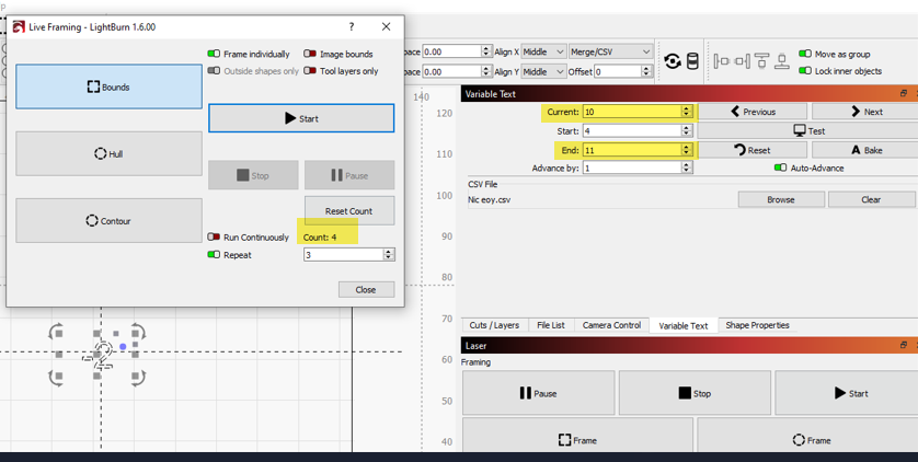

Is this possible to do in the current Lightburn? I’ve tried to set “Repeat” checkbox and set count, but foot pedal completely ignores and just continues counting up.

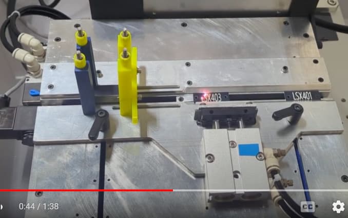

I make a lot of identification plates for automation and made an auto feeder that uses a Reprap firmware board. It uses 2 5V relays to receive the “Marking Complete” signal, does the auto feed and then send “Start Marking” signal back to galvo fiber laser.
The problem is that the auto feeder is stupid and has no way to monitor when finished. EZCAD2 had the ability to stop receiving the foot pedal, but I’m not a fan of it.
Maybe there’s an easier way for me to accomplish this, but I’m not aware. Please enlighten if some other solution could work that doesn’t need to worry about disabling foot pedal.
Video - https://youtu.be/PAuAWgLg8KE
Neat jig you’ve got there…

That, unfortunately, doesn’t solve my problem, but I think you summed up the issue for me. Lightburn doesn’t have an end of job, that I can find, but a end of current marking. Even selecting Repeat and setting number, if the foot pedal signal turns on, laser starts again and counter goes above threshold.
EZCAD2 had the option to brute force end of job by doing as I mentioned above by counting the full job number and entering that into the part counter box.
I use the variable text with CSV file to input data to laser and as soon as I load a file, Lightburn gives me exactly how many elements are in the array, which is great.
I think in my ideal world, either there was an option to end job at set value or option for variable text data to stop at end of file instead of restarting. I think my only other solution would be to design a more complicated auto feeder.

I do not think there is currently any means to prevent a job from starting again via the foot pedal signal if the job ‘Count’ reaches a certain number, nor if the ‘Current’ variable text record exceeds the configured ‘End’ record.
Having a way to prevent another ‘Start’ once the job count reaches a certain number would be very useful.

Is there a possibility of future patch to fix? Even though the input from foot pedal goes directly to galvo board, the software on PC handles what to do about the signal.
It seems like for galvo at least, the “Repeat” option has no function. I’ve tried it with on and off and it only does one cycle regardless of repeat quantity entered.

I’ve actually added code to handle this. It seems like a reasonable case, and if it all checks out it should be included in 1.7.
