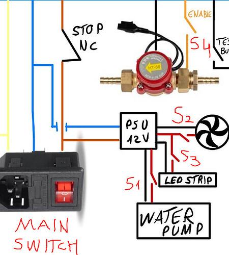

It’s true I haven’t properly marked it, but in the following images you’ll understand better:

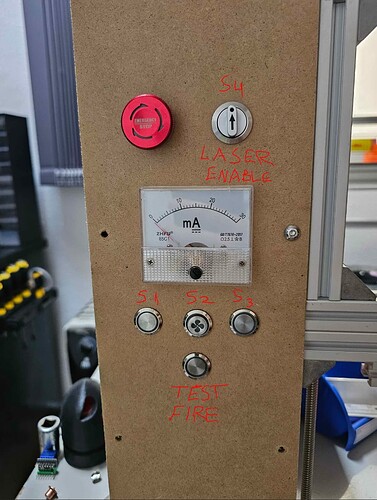

As you can see, my main switch is located at the beginning, on the same input socket with a built-in fuse, so turning on that switch would power both the laser power supply and the 12V one. If you look closely, between the 12V PSU and the extraction system, LEDs, and water pump, there are normally open switches that I’ve labeled as S1, S2, and S3 (latching switches) because I want to control them manually, as you can see on my control panel:
Regarding the ‘enable,’ it’s actually ‘laser enable’ and is controlled by a rotary switch. It’s an extra safety system that allows me to disable the laser without deactivating the controller, touch panel, and motors.

It’s confusing by the way it’s drawn.
If your stop switch is open, then nothing gets power even if the switch/fuse assembly is enabled. If the stop switch is is the emergency stop … that should work.
