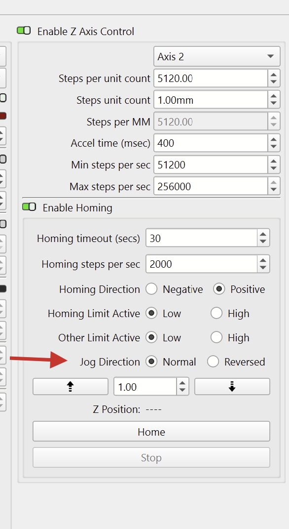

the change from 10 msec accel time to 400 fixed the problem, now moves up and down, just still in the oposite direction as shown in the up and down icons.

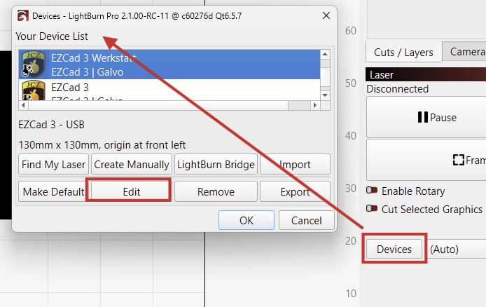

Can you change m_bInvert to 1 and import the file again?
(You don’t need to add a new device. Just select the current one in the Devices menu and edit it)
It did not change. still inverted.
Thanks to your feedback, we’ve added a Jog Direction invert option in the latest 2.1.02
Did you get a chance to test this on your machine?
yes it works now
