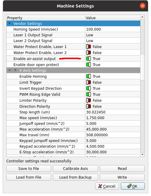

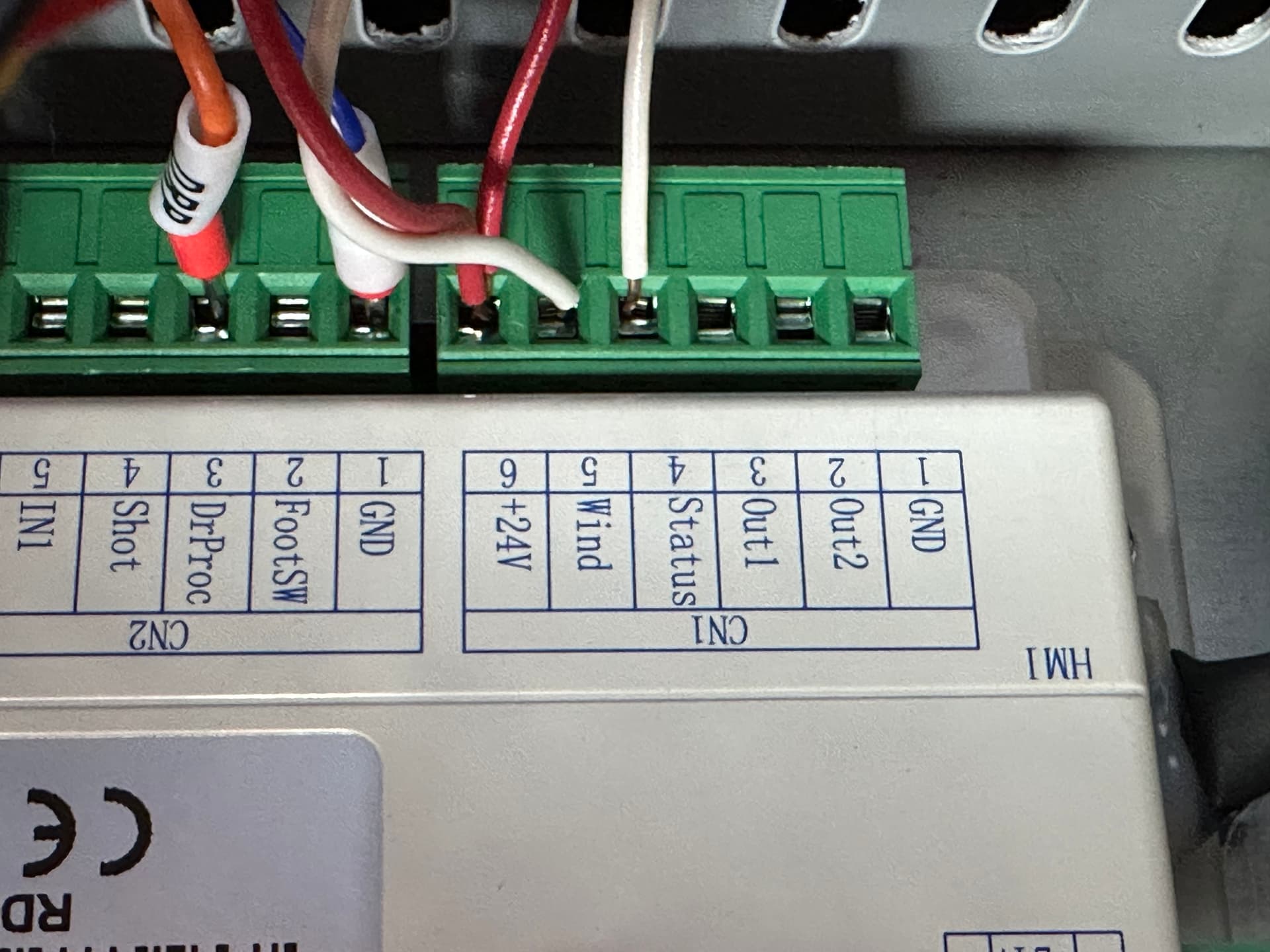

I have connected a dual solenoid system to my laser; however, air is not being emitted. For my high pressure solenoid, I have the positive end (red) attached to +24V and the negative end (white) wired to WIND (pin 5). For my low pressure solenoid, I have the positive end attached to +24V and the negative end wired to STATUS (pin 4). I have also included a diode in both of my solenoids. I have also checked and ensured that air assist is enabled in the machine settings by checking on both my controller and on LightBurn. I am not sure what is wrong. I am completely out of ideas. When running a job, regardless of whether air assist is turned on for a layer, the light for the low pressure solenoid lights up. I am not sure what to do. I would greatly appreciate any help. I’ve attached photos of my solenoids and wiring.

That setting does not appear in LightBurn’s Machine Settings list, but the Vendor Settings includes Enable the auxiliary air control, which must also be turned on.

I went into my controller, and I did not see an “aux air” option under the para settings. The only aux. air setting I can find in the controller settings is Menu → vendor settings → aux air enable. The setting is enabled. Is there another setting somewhere else that I am missing?
That’s the one some folks miss, but it sounds like you’ve got that part under control. Out of curiosity, in LightBurn Machine Settings does it also show the same thing? I know you set it from the controller, just wanted to make sure Lightburn got the message and it got written. When you get that sorted, I agree with Ed, in another post I showed how I used a dual relay ( Air assist diode - Community Laser Talk - LightBurn Software Forum) to control the solenoids on my 60W OMTECH. Hope you get it figured out.

That probably corresponds to the Enable the auxiliary air control setting on mine.

Would not having an SSR be causing my problems? I just don’t understand why the solenoids don’t seem to be working at all. The controller shouldn’t be an issue because I have a status lamp connected to 24, WIND, and Out1, and it works fine.
Which isn’t working?
Wind?
And on Wind you have a status showing it’s active?

Neither the low pressure solenoid or the high pressure solenoid are working. There is no air being put through whether I have the “air assist” parameter checked for a layer or not. I have double, triple checked that air assist is enabled in lightburn and on the controller. Is there a way to check that the WIND pin specifically is enabled separate from the “air assist enabled”?

Do you have indicators on the Wind and/or Status pins?
What do you mean by indicators? Like a light to tell if the pin is working? If so, no there is no light on my controller for my 24 and WIND pins.
Take a piece of wire and short the Ruida Status and/or Wind pin to ground.
That is all the Ruida does… You can do it manually and see if your solenoids are working…
You should either hear them or be able to feel the mechanical change from the vibration…
I don’t quite understand. So take a wire and connect it from the status/wind pin and connect it to the GND pin on the same line?
Your solenoid is connected to 24V, the other end to the Ruida Wind/Status. The Ruida is an open collector and effectively connects the pin to ground.
I’m saying you can do that manually and energize the solenoid… doesn’t matter who pulls it to ground.
Follow?
So to test it, I can leave the positives connected to 24 and take the negative wire of one of the solenoids and connect it to ground? This should activate the solenoid?
