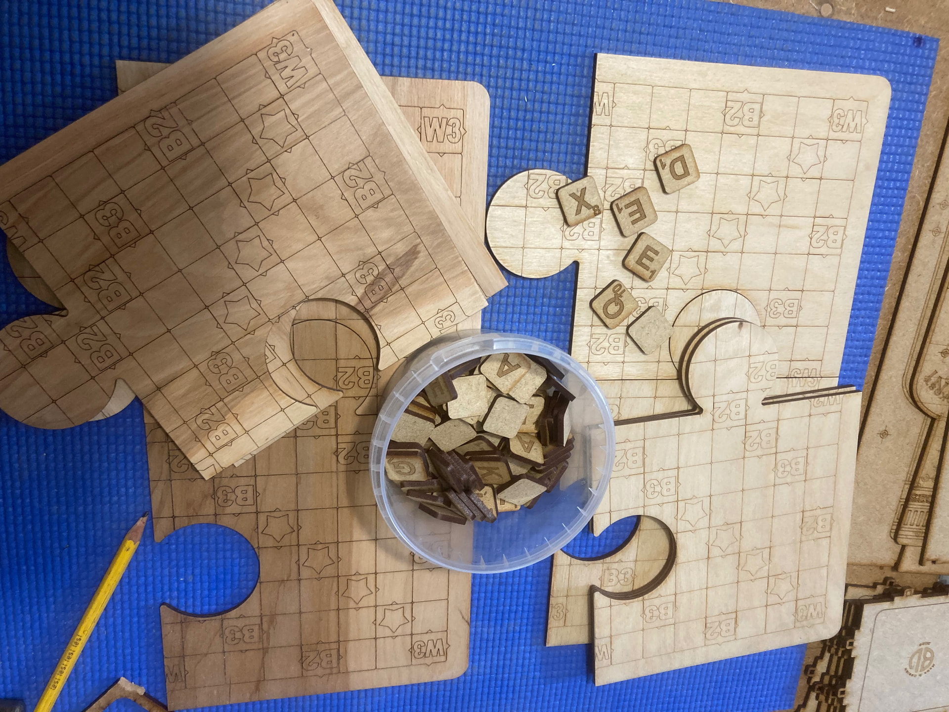

I am working on a project, where I have to engrave (fill) a bunch of small characters (scrabble game).
I now wonder, whether it will make a difference in terms of quality and speed, if I convert those characters to paths or not. What do you think?

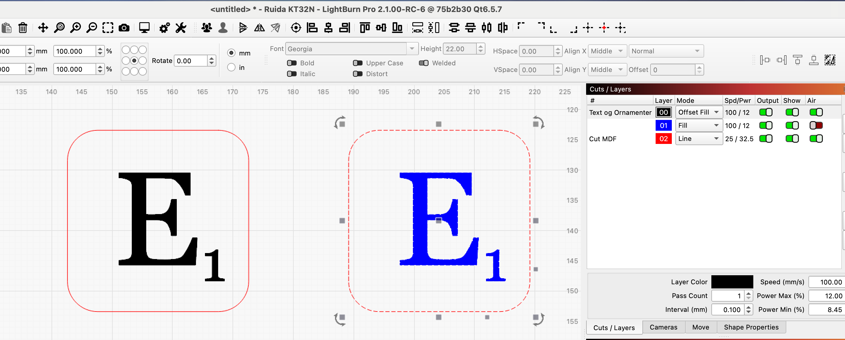

I made them with crosshatch and line mode afterwards, the design is only once, then it can be easily converted to shapes/path as desired. Finally I cut them out. Whether there is a time saving one way or the other, I have not tested. Try with the preview window and compare the different modes.
The time saving will be from changing to Offset fill, or setting to flood fill.

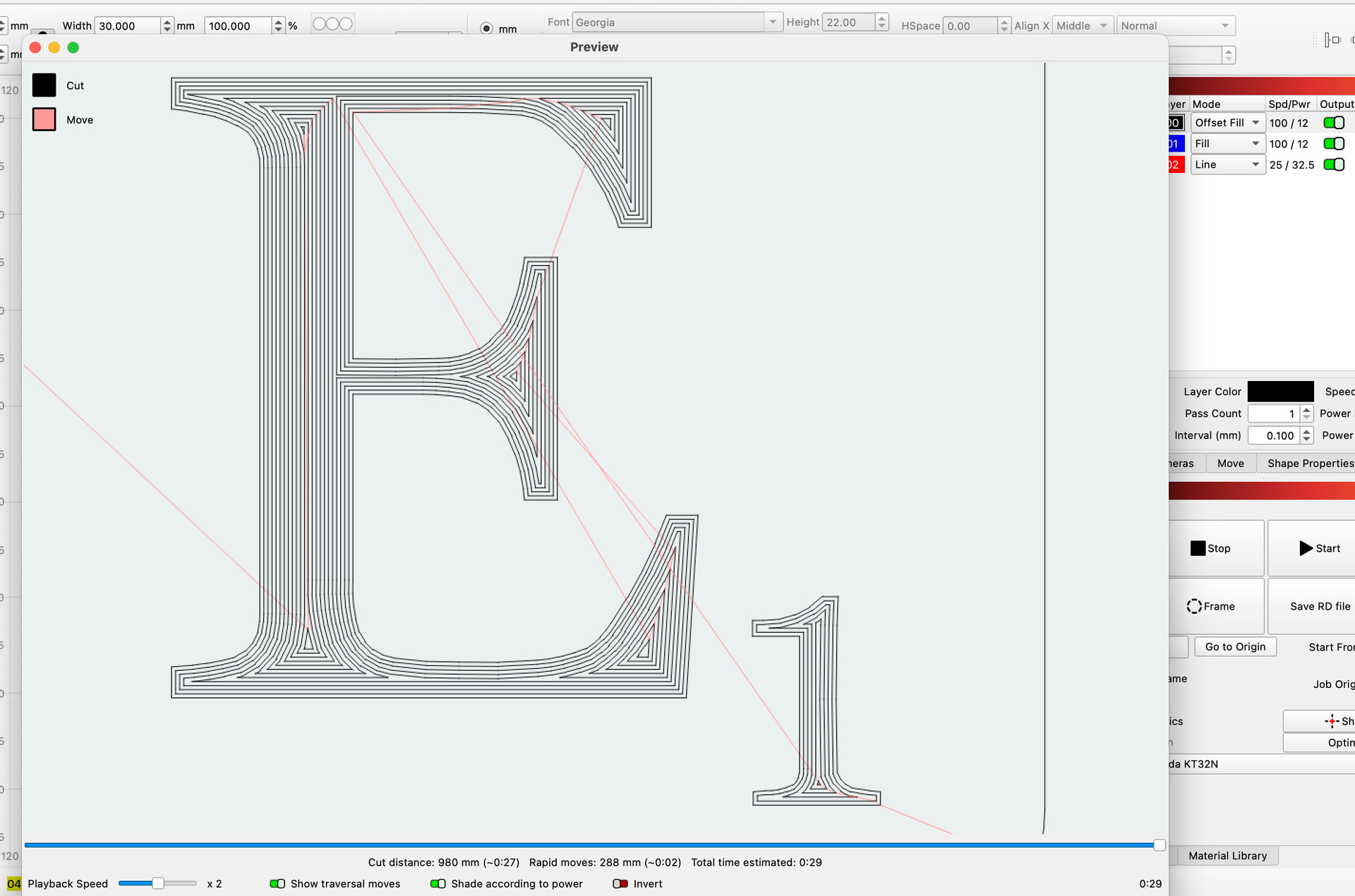

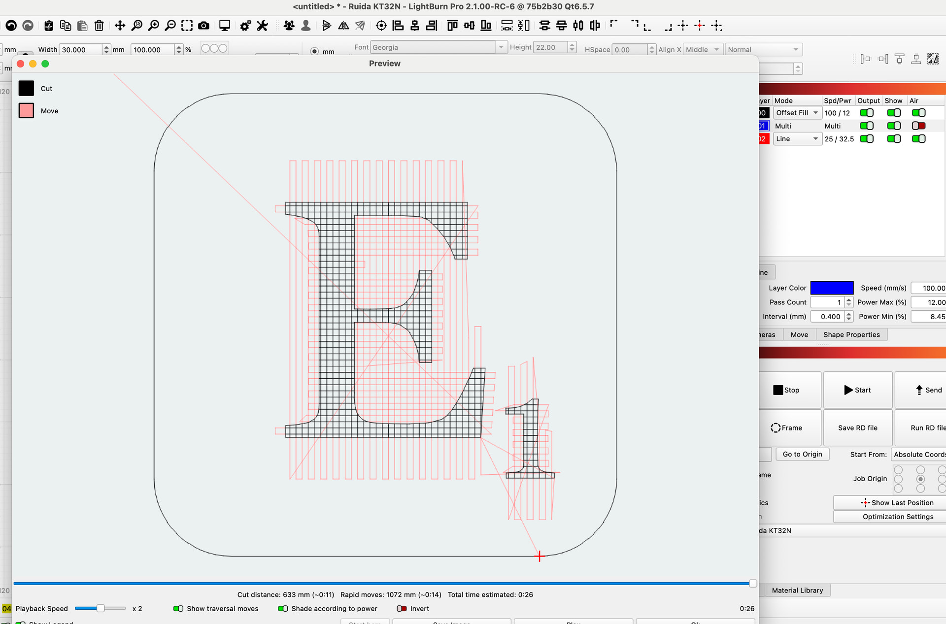

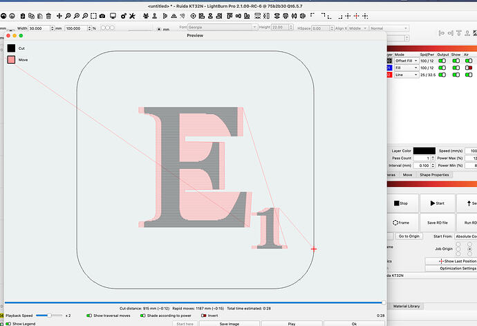

To explain why I think offsetfill is not suitable for the task, (on smaller and complex parts)
here are 3 pictures.
Same parameter, which in this case happens to give the same processing time, but the big difference is the quality or appearance of the result. We have had the topic before and I could show examples with ugly holes in shapes because offsetfill just could not do the job well enough.
In the last picture you can see the way I used Multi-Layer for the task and that is (for me) the prettiest result.

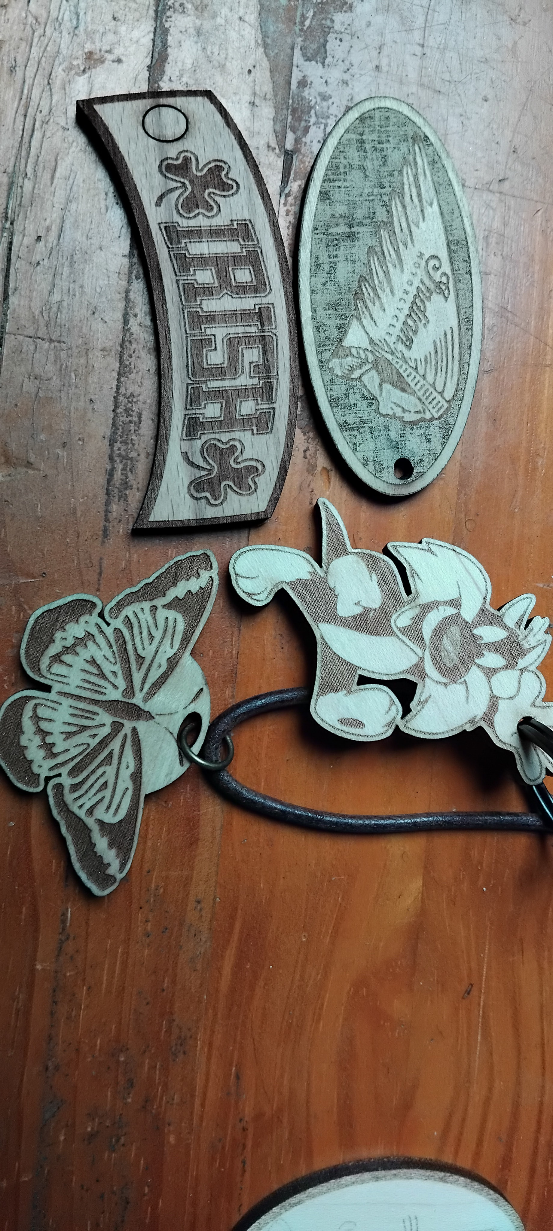

Off topic slightly, regarding the Birch 4mm ply that would not cut easily for me, I did a keyring of the Indian head that is used on the Indian motorcycle company logo. I traced the image and Offset the trace line outward and crosshatch engraved to the outer boundary where I had Offset inward.
The outer layer of the ply was so thin (unlike the reverse surface layer) that the lasering partially revealed..in patches, the layer below which is much darker, this gave the Indian head the raised appearance with a somewhat strange worn-cloth appearance around it..quite unique in my experience, I will include a photo tomorrow.
I had done a couple of these in mahogany and ash and they were OK but this one on the 4mm ply was elevated by this effect.
Just to say, that materials hold many unexpected qualities and taught me to consider even more carefully the potential of every aspect of something.

Nearly forgot to post the Indian head and the engraving around it which just starts to reveal the next layer of ply below.
Nice texture that actually looks way better than depicted in the photo and should look nice laqured, and some examples that hide a smokey cut-line and save sanding time.
