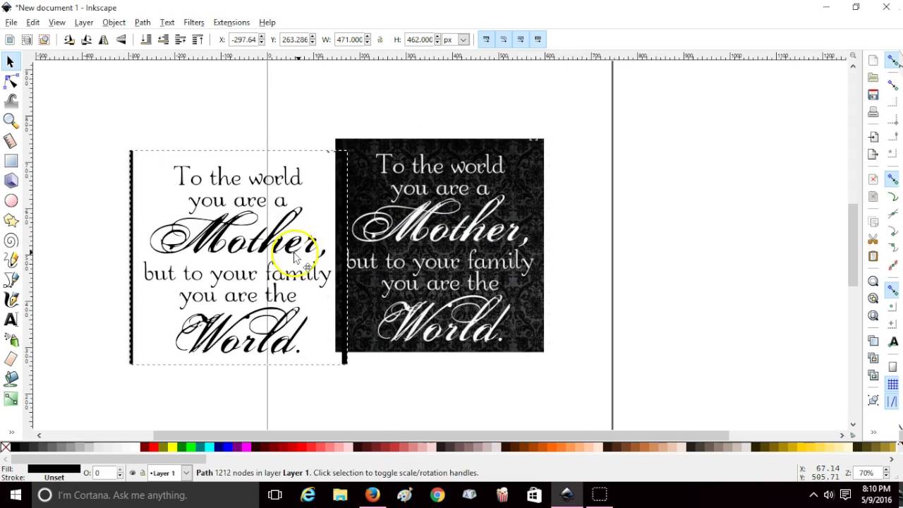

Watching, I see an image trace, going from a bitmap to vector, then vector path edits to remove unwanted elements of the original. LightBurn also offers an Image Trace feature.
