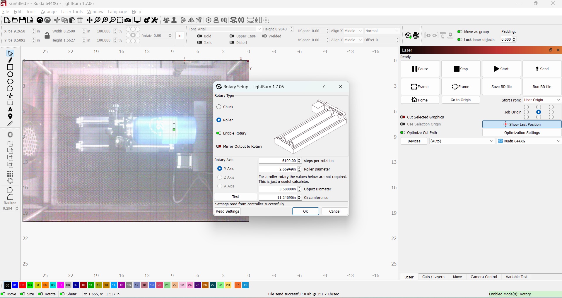

I am new to using a rotary tool. I understand that these things are difficult to setup for the first time based on all the forum results. I ran though testing and found the steps per rotation is 6100. The circumference of my object is 11.24690 inches. When I try to line out a rectangle on my object that is 11.24690"x.25" it works great in Absolute Coordinates mode. But when I switch over to User Origin mode I get the Frame Slop Error on the riudia controller. In my screen shot, I even reduced the rectangle to 1.5"x.25" and I still get the same error. I have an OMTech red and back 100 watt Co2 with a 28"x20" bed. Can someone please tell me what I am doing wrong?

Your setup as a roller type rotary, so the object diameter doesn’t matter to the machine. You can use it to compute the working area withing Lightburn.

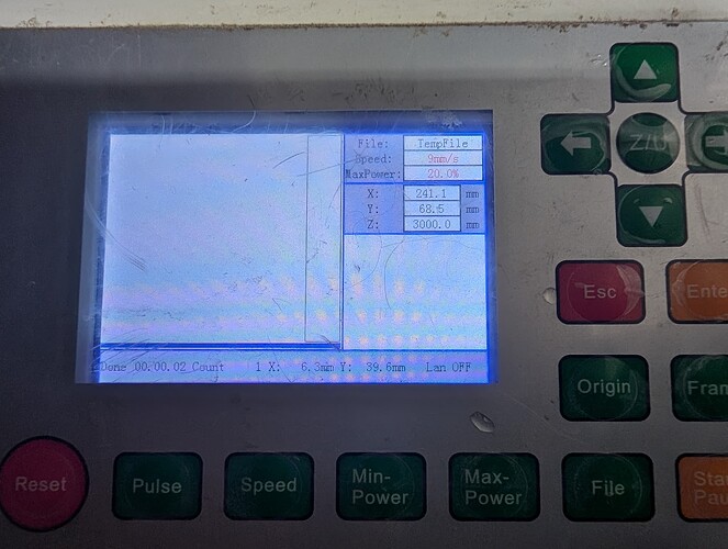

Something you need to look at. What is the Y position on your controller? If your Y position does not make sense to the controller when you send your file you will get this error. What I mean is if your Y position reads near 0 and your origin in lightburn is near 500 with the graphic going towards 0, the controller “knows” there is not enough room to run the project. Even though there is no limit to the travel of your rotary, your machine doesn’t know that.
Try this, if you use the center of graphic for origin, jog your rotary until the controller reads a Y position of 250 or thereabouts. If you use the bottom origin, rotate until it reads near 500 and if you use a top origin rotate it until it reads near 0. See if that solves your issue.

So @thelmuth - you got me onto this. The Y axis on the controller was at 0. And that makes perfect sense, I cannot start in the middle of my project and expect it to travel in the negative, right? So I bumped it up to 68mm (randomly large enough for a 1.5" rectangle) on the Y axis and it worked just fine. Such a simple solution, thank you!!
Now, I’m assuming I just need to make sure that the controller shows that I have enough distance to travel for each project I try to engrave and if it does not, then I just need to job my Y axis to the center of dimension
of whatever project I am doing, then I can place my item under the laser head where I want to start engraving. Is that sound about right or am I missing anything else?
That’s pretty much it. I generally do my rotary work with a lower right origin at top of tumbler and jog my Y axis to something in the 450-475 range. I have the same size bed as you. If I do happen to need a center origin I jog Y to around 250.
