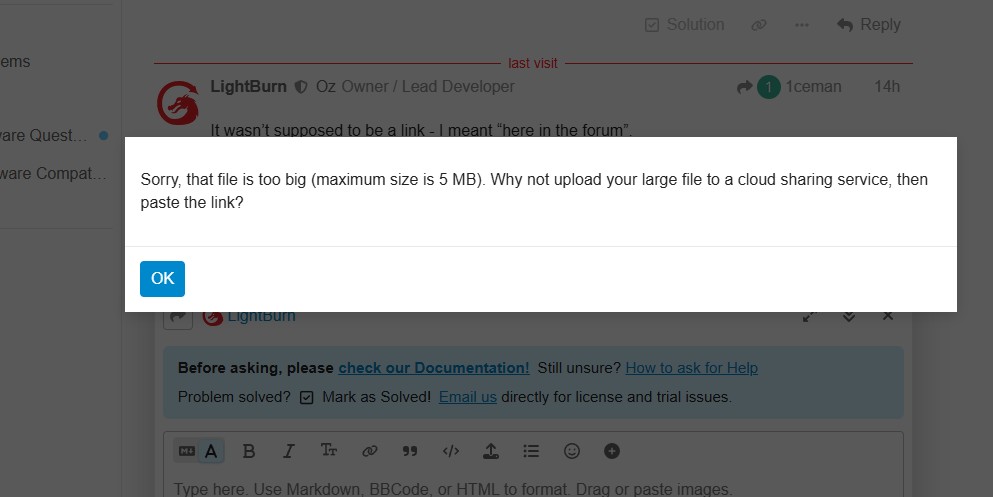

Here is the link as it was almost 5gb…

In the process of making this thread, it did decide to crash partially. Stuck on screen with blue circle for 15 min now. All I can do is force close it.Your site wouldnt allow me to upload the video file…
