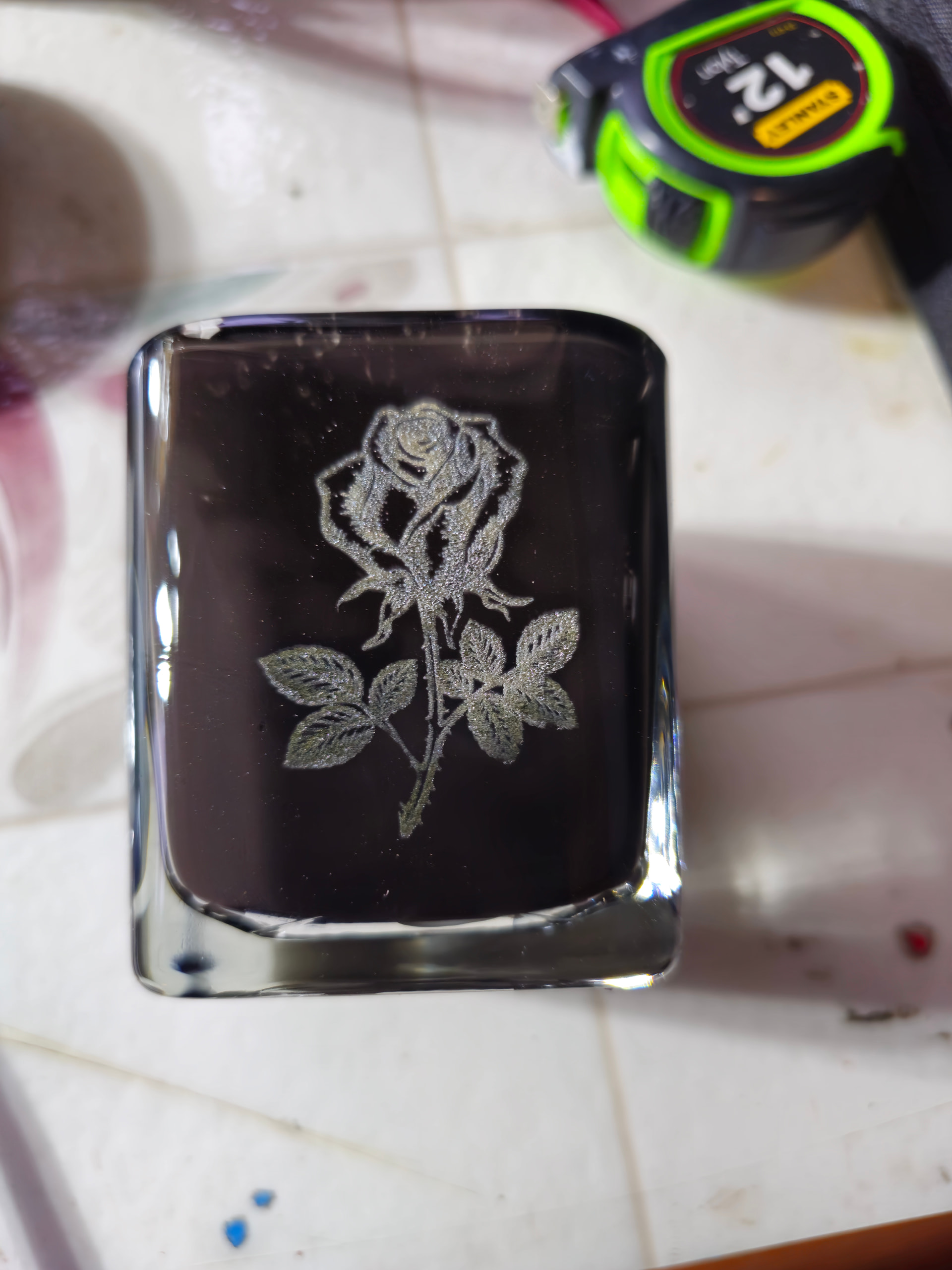

Hopefully, I’m getting closer to doing a decent job of engraving glass, but I have a different kind of question…
I like the way the engraving looks with the black background…before I wash it off. Is there a way to make that black background permanent and leave the cut glass clear? I was wondering if the engraving would work with some black paint other than tempera.
Thanks for any ideas.

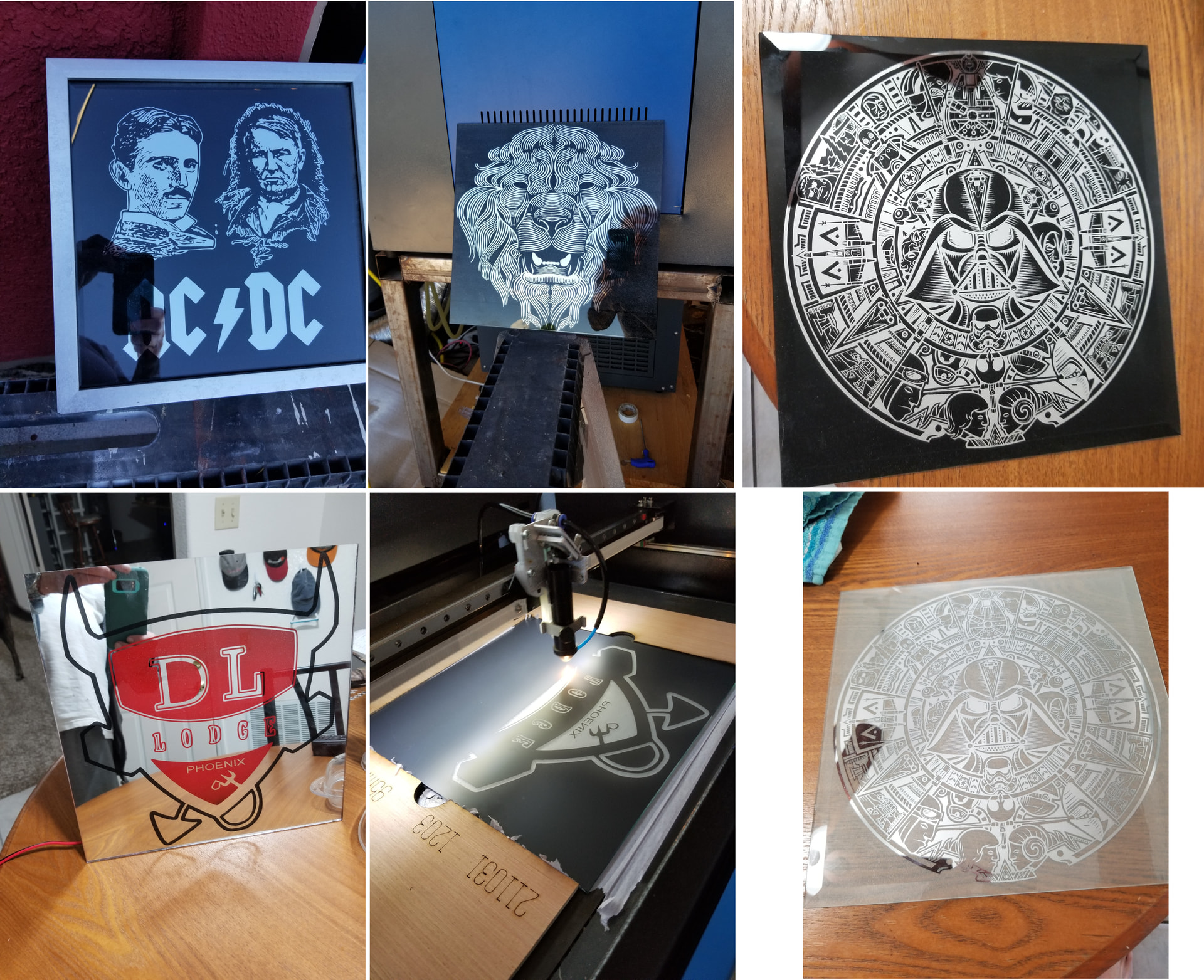

On my co2 machine I lase the back off mirror tiles and then paint the results to get good contrast. This is one that has been lased and you can see the glass isn’t clear.
After applying black acrylic paint to the back.

For mirrors, I’ve had success removing the silvering and leaving the glass unaffected 9smooth and clear.
I use contact paper (shelf liner) and apply it to the silvered back. Lase off the pattern with a low power setting that burns away the masking but doesn’t reach the glass. I then daub on some paint remover which removes the exposed silvering, but is adequately repelled by the mask.
RInse and peel off the mask.
Of course if you are going to paint, then the etched glass is a bonus since the roughed up surface provides a good tooth for the paint to adhere.
Most contact papers are vinyl or PVC which produces toxic fumes so I lase with strong cross flow air and ventilation in my spray booth.

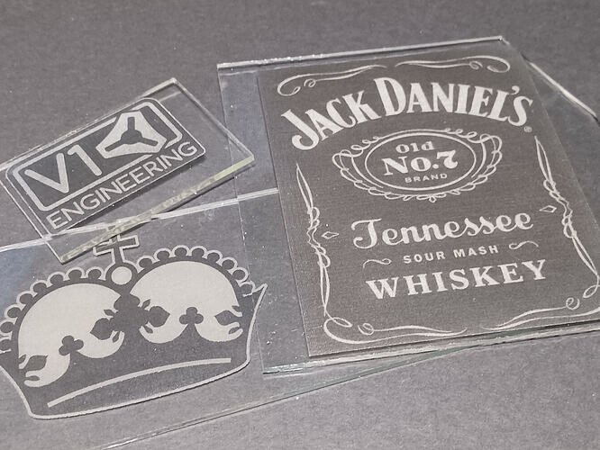

While I was experimenting with etching glass using my 10w diode laser I found that when I coated the glass with tempera paint I got a frosted image and when I tried the TiO2 mixture that I use for etching ceramic tiles, I would get a black etched result. There should be a way to mask and combine the two to get a design with both frosted and black in the same image as long as there was a way to index the workpiece in the exact same position after cleaning the first coating off and applying the second coating.
A visible light laser cannot directly etch clear materials. The beam passes through without doing any damage. You used Tempera paint to absorb the lasers emf, so the glass shatters. This leaves the frosted results.
When you use TiO2, the laser heats this and creates a molecular bond to the glass of the tile, creating the black results..
