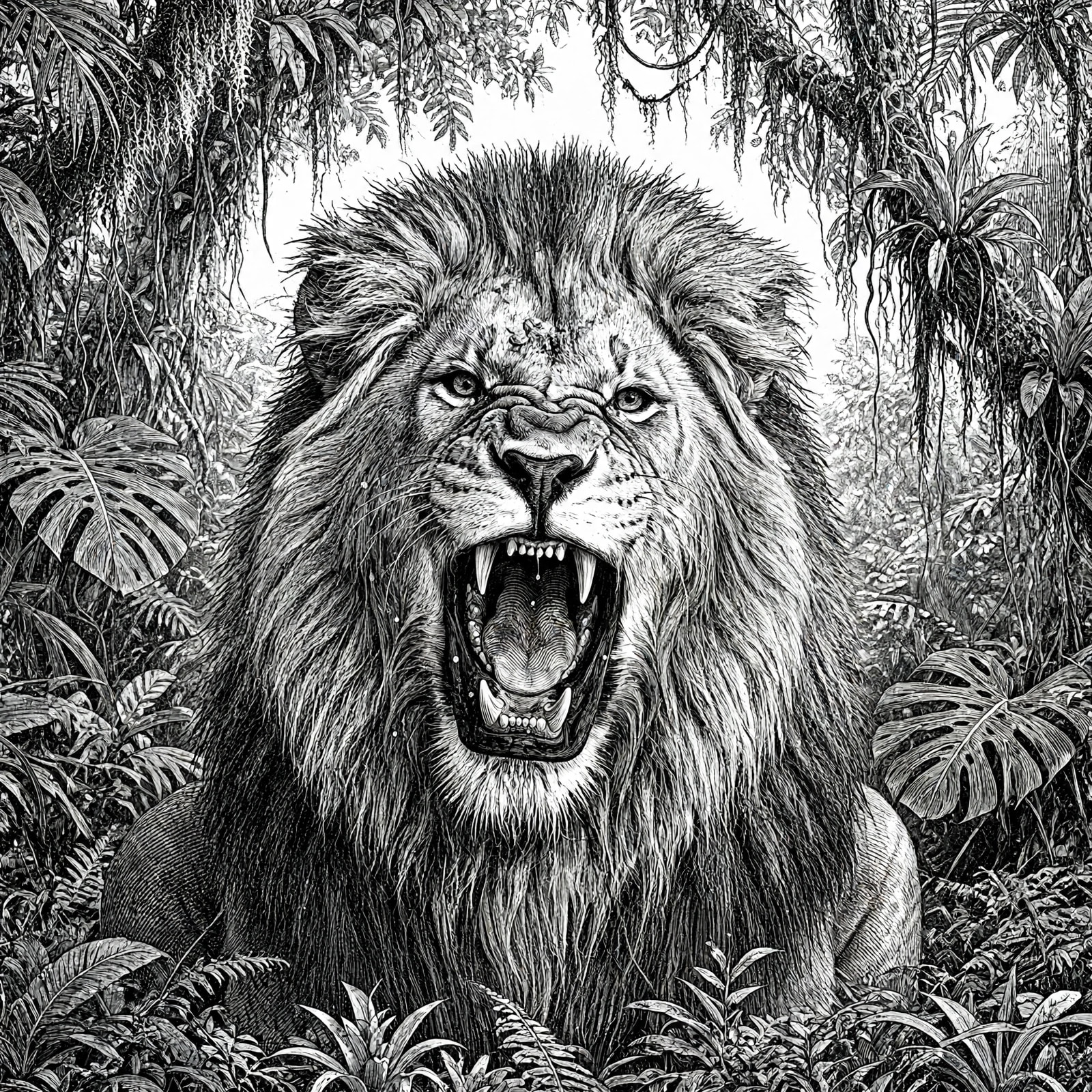

You mentioned the blurred background of the lion. I told it to add a jungle setting behind the lion.
How about this.
This script created this.
Create A highly detailed, high-contrast black and white Vintage Engraving / Etching style illustration of this image. Use crisp ink line art, vintage woodcut aesthetics, and clean hatching/cross-hatching for shading. Grayscale, no color, clean white background, sharp vector-like paths, optimized for laser engraving." Yes it took some artistic license in creating it. Some of the detail changes, i don’t have much control ver this. I might be able to, but I like what it did.
I asked it to extend the top and bottom to make is square. Not is can be engraved on a tile or slate, etc. it did narrow the lions head a little, but if no one had set the original they wouldn’t know.
I might have been able to tell it to create the jungle background and the place the lions head into that, but it think the would make for a lot of trial and error to make it look right. This is like trying to do photoshop version 1 but using words only, lots of limitations.
You could stretch it out and then crop the sides back to a square image. That would be the easiest.
Things evolved I now have a matching set of 5 African cats in a square format here is one of them. All have the same foliage. They are 8bit .png

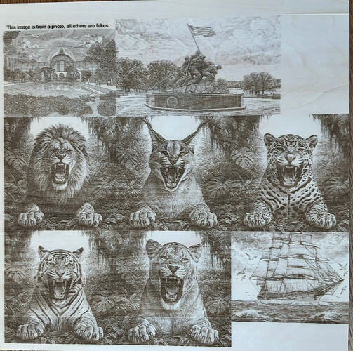

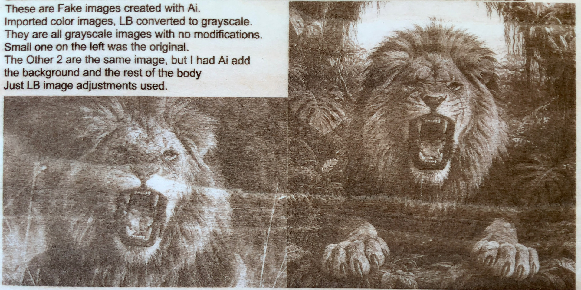

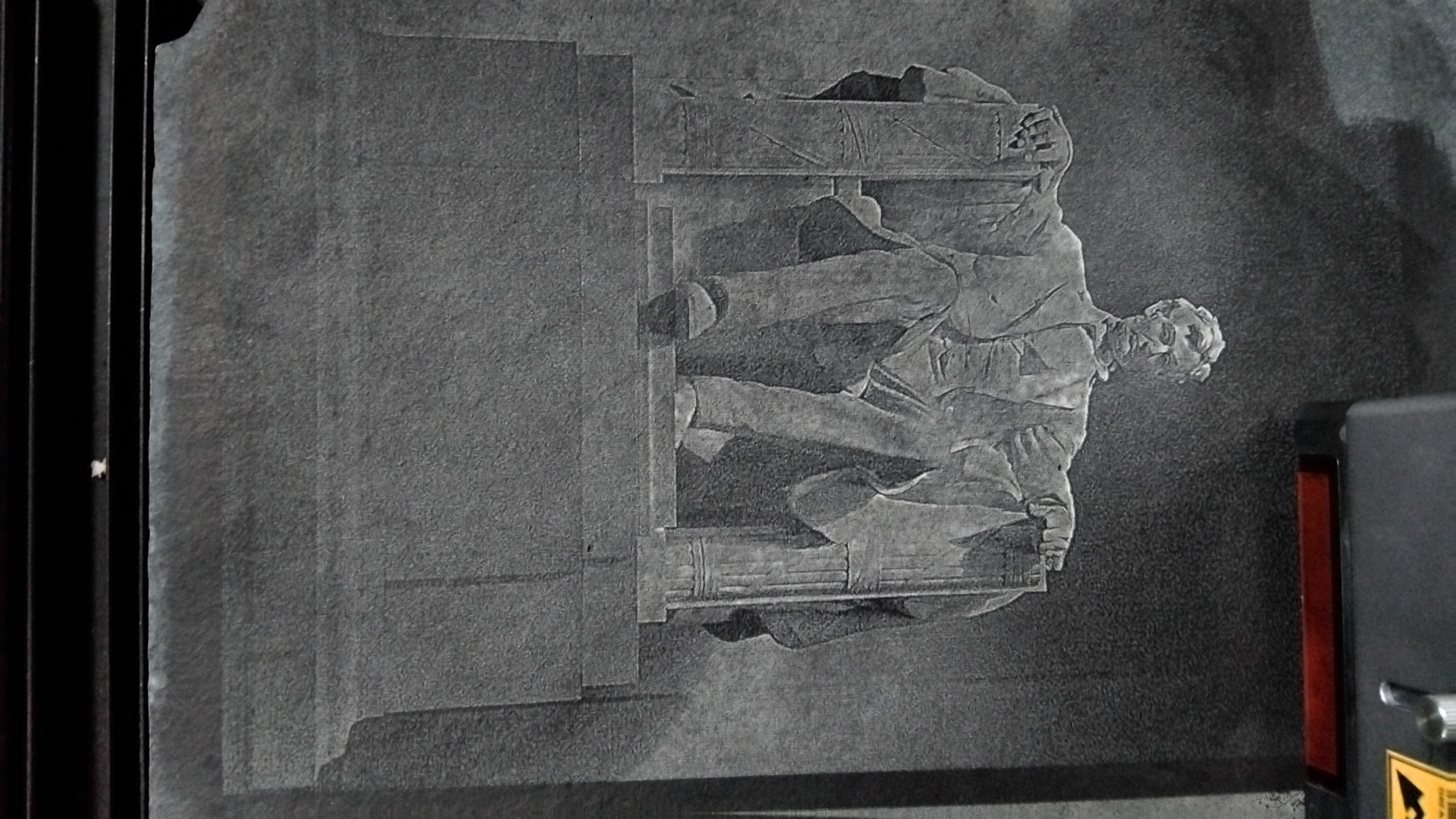

I’m in the process of burning a board with 3 versions of image adjustments of the memorial, q1 of the Cuttysark, and 5 different African Cats. The cats are a set. I’m anxious to try one on slate.
I’ve got some slate cleaning off out in the rain, it’s not top quality..best I could get but the polishing pads and fittings arrived Friday and the multispeed angle grinder gets here Tuesday from Austria so I’ll see if I can improve on those surfaces.

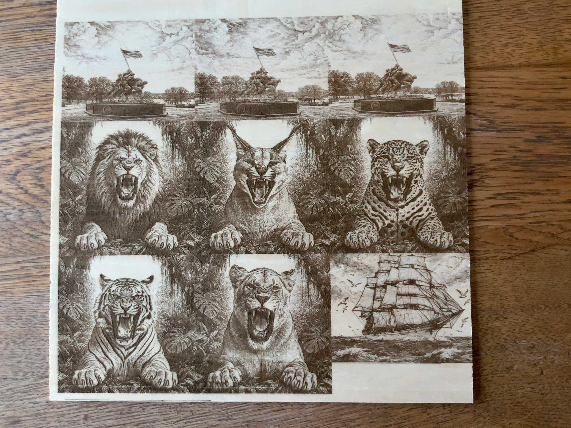

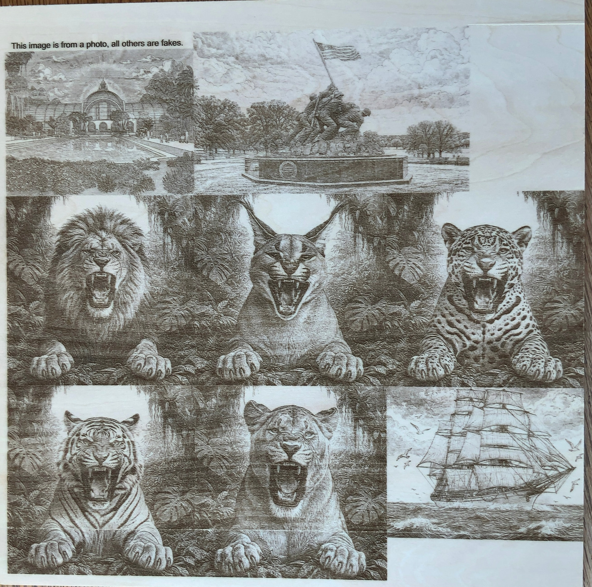

I will be posting a 12” square test board with all Ai images. My new cat image set 3 different power settings of the last monument image I posted, and a fine detailed image of the Cuttysark. I’ll get around to that later today.

Here is the ship image, it has some really fine detail, and it did well burning it as a 4” image on Baltic birch ply. I’ll post images of some tests I did yesterday when I am more awake. Is is 4:30 a.m. currently.

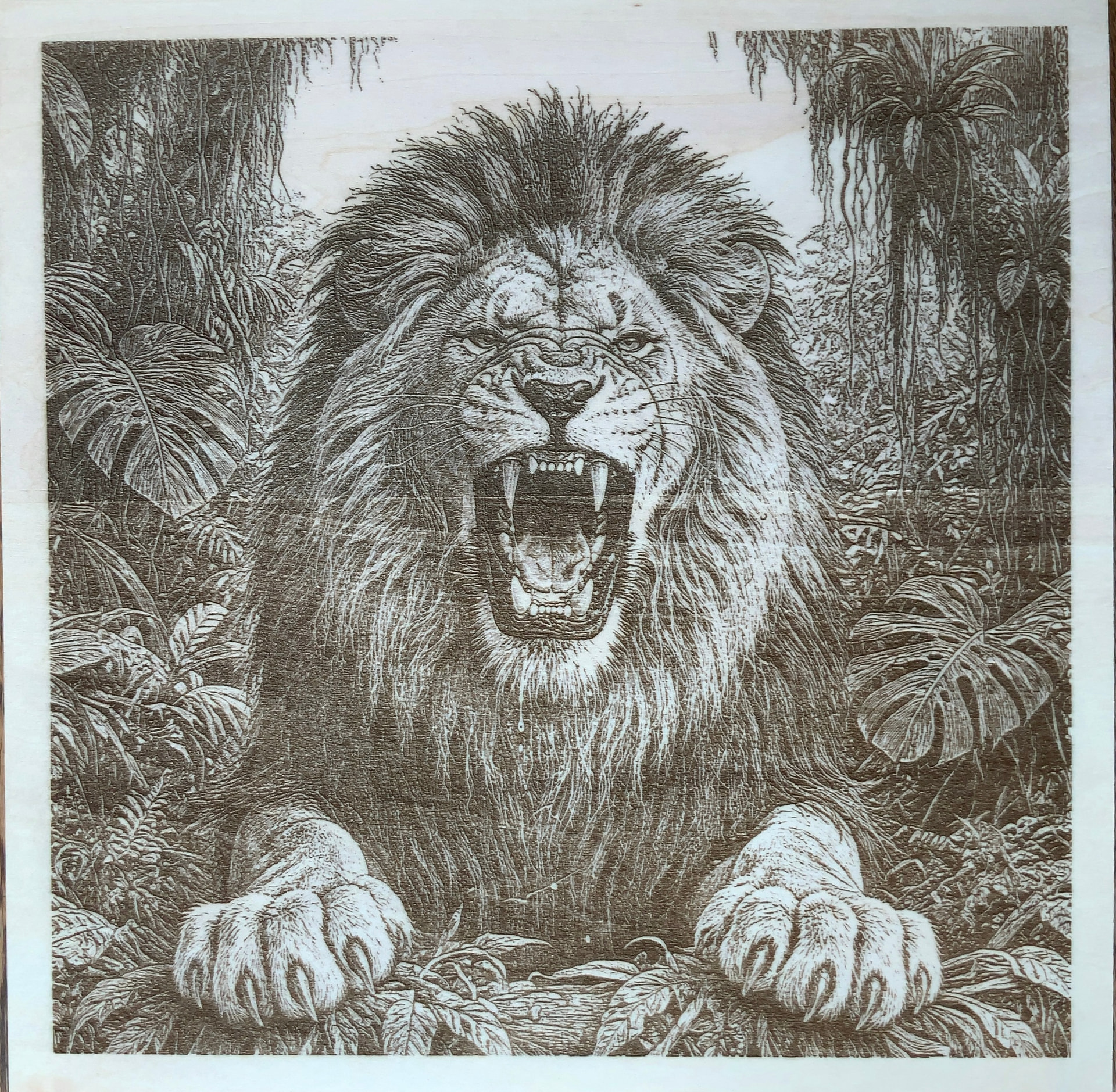

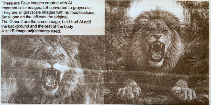

Here are a couple of tests. All have been reduced to fit on a 12” square of basswood ply.
I didn’t do any adjustments on the ship, and that turned out pretty good.
I didn’t do any 3 different adjustment settings on the monuments. I think that the middle one is best and at that size needs mor sharpening.All the cats used one of my standard preset adjustments. They turned out pretty good, but I need to come up with a different set for the large lion, not enough detail (see lion image above.
I hate the backside of the ply, because it made up of scrap pieces butted together.
working on new settings. ill be posting new tests when I get them done.

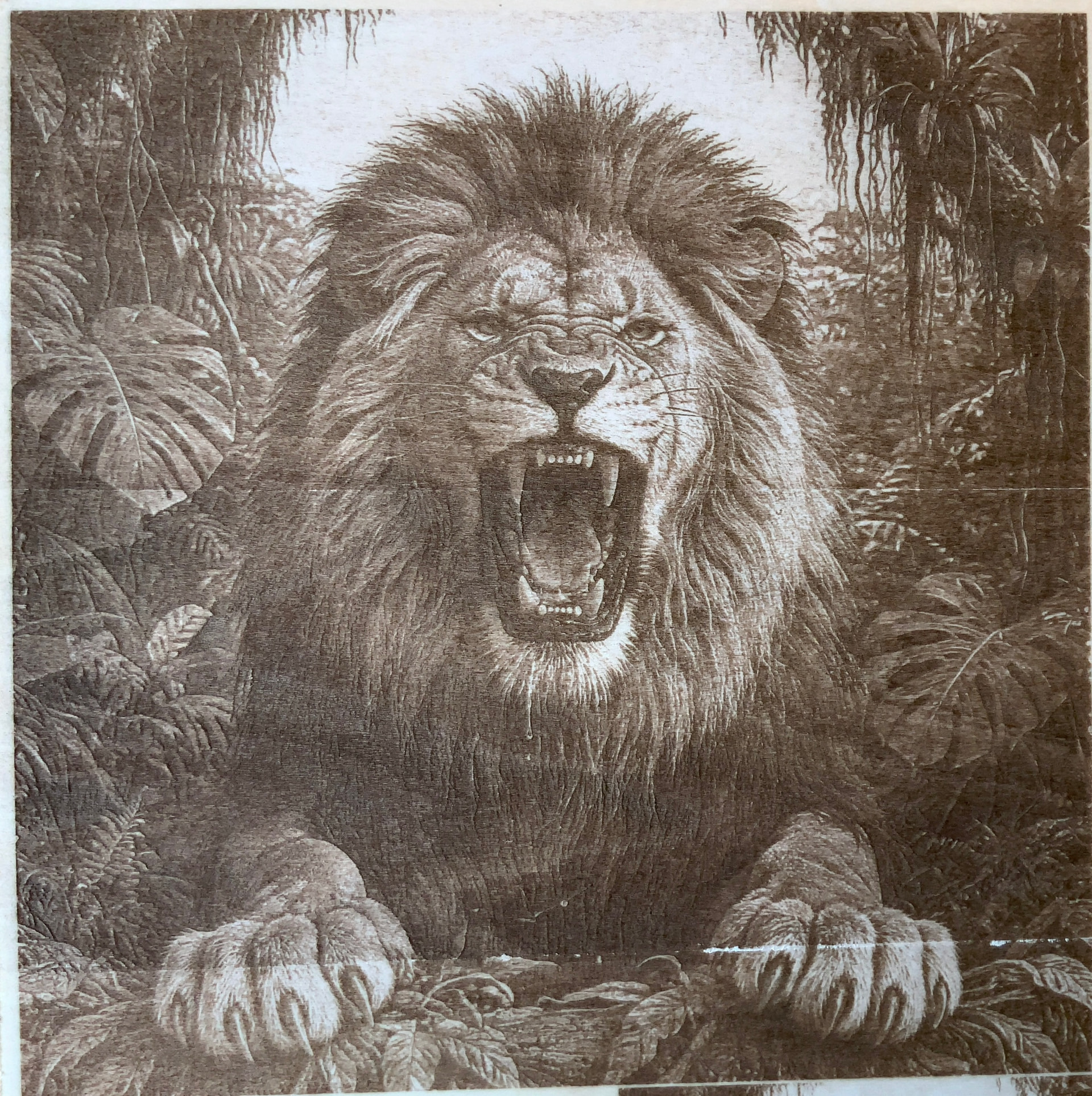

Here is the exact same files, but I changed the adjust image settings. A lot more detail. The memorial looks a lot better. The ship looks better as well, A lot more finer line detail.
I had to recreate this color image from the image where I added the foliage to incorporate the lower body and top of his head.the Color lion has the feeling of 1950 color postcart. Definitely not photo realistic, but cool.
I had an idea, and decided to take the color image with no script modifications into LB and let it make the grayscale image. Then I applied my new set of adjustments to the images. So these are basically what you would get from a digital camera, and LB doing all the work.
Even more detail. This surprised me a lot.

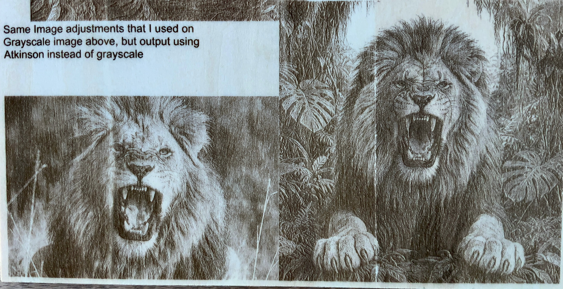

The side by side image the large lion is 4”, the big image is the same settings, but is 7” not 11”
This are my grayscale images of the 2 smaller lions.
This is the same 2 images using the exact same settings and power as above, but changed to Atkinson.
Interesting what my iPad camera does with the lighting from the ambient light and flash.
So you be the judge. The grayscale image looks more lick a photograph, and the Atkinson looks more like it is from a computer. Although the lower image is brighter.like I said it all depends on what you are trying to achieve.
Please excuse the crappy scrap of plywood I used.
