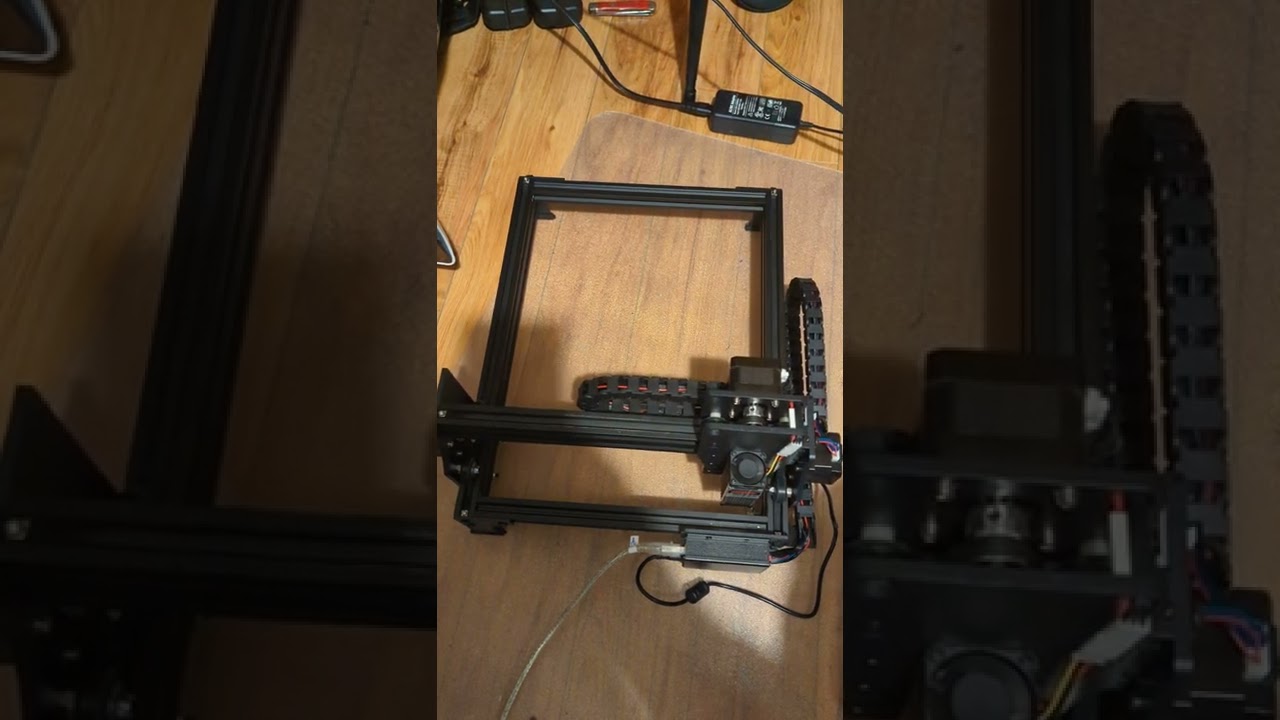

What you descirbed Berainib is exactly what happens. Here is a video showing what happens. After it pulls away from hitting the switches a second time it shows this in the console.
Console Error
ok
ALARM:2
G-code motion target exceeds machine travel. Machine position safely retained. Alarm may be unlocked. (Right-click the ‘Devices’ button to reset the connection)
[MSG:Reset to continue]
ok
Grbl 1.1f [‘$’ for help]
JL3_GRBL_v1.0
[MSG:‘$H’|‘$X’ to unlock]
[MSG:Caution: Unlocked]
ok
Video

As @01power indicated the stops are not really being used as a traditional homing switch since we’ve defined this as the far corner from origin. This should be theoretically okay as there are other lasers that home away from origin.
I think what’s happening is that since you have soft limits currently enabled ($20=1) that at some point in the cycle it’s going past the defined 220x290.
There may be a few conditions as to why but not certain at this point.
  1. Your homing pull-off $27=2 is insufficient and is sitting beyond the boundary of 220x290.
  2. I’m not sure if origin after homing is established after the first contact with the limit switches or with the second. It’s possible that if it’s with the first contact that the second contact is exceeding work area.
I can think of a few remedies including turning off soft-limits or changing your origin position but let’s see what the current situation is first.
Can you run this immediately following a homing cycle?
Here is the command after the homing cycle.
<Idle|WPos:220.000,290.000,0.000|FS:0,0|WCO:-220.000,-290.000,0.000>
ok
I was able to click “go to origin” and make a grid to see if it works.
So I think you have a few options.
  1. Disable soft-limits - this will almost certainly work but removes one safeguard to prevent crashing in some scenarios. If you want to do this $20=0
  2. Increase homing pull-off - this might work. Not sure. Right now the homing cycle has the head pulling away from the switches by 2 mm. Increasing this might relieve the issue. $27=3
  3. Move origin to lower-right - I think this might work but can’t come up with a complete model in my mind of how to do this so don’t want to send you down this path.
Take a pick as to what you’d rather do. You may want to take a backup of your configuration in Machine Settings before playing around.
