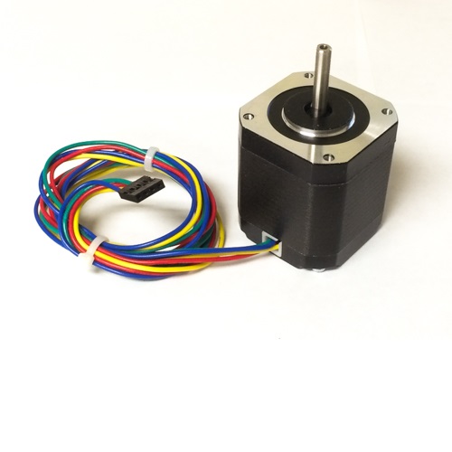

I’m using these steppers

I’m currently running them with 24 volts at 2,84 amps and 6400 pluses per rev.

well it work. I turned down the amperage on the stepper drivers and things starting cutting straight. What I’m not sure of is, where the stepper just getting hot and losing steps or was my power supply not keeping up. I have a 6.5 amp power supply so that seems unlikely but, I was pretty sure the amperage i was using was appropriate for my steppers. I’m going to replace the power supply with a new 10 amp version just to be on the safe side. Right now i’m just happy to be burning again.

Steppers “bounce” when they take single steps, and if the supply current is too high, it can actually make resonance worse, not better, particularly if the stepper isn’t damped with enough weight. It’s not impossible that the current was just set too high for the X axis, though that is pretty rare.
