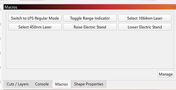

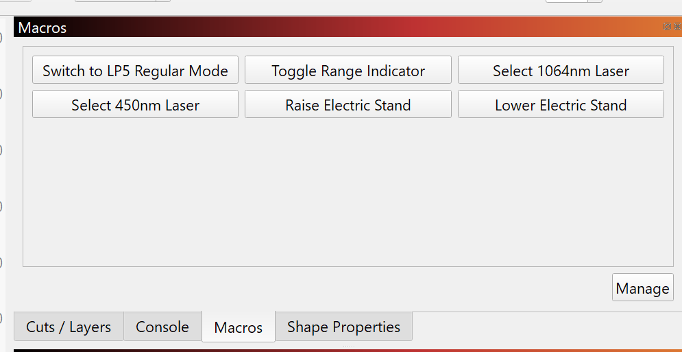

In LightBurn version 2.0, we moved the macros from the Console Window to a dedicated Macros Window:
I don’t have access to an LP5 yet to confirm this, but for framing to work on this one, you need to first change to the 450nm Laser by selecting the appropriate macro and hold down the Shift key when clicking ā€œFrameā€.

Did you run the macro called ā€œSelect 450nm Laserā€ and held down the shift-key of your keyboard when you clicked on ā€œFramingā€?

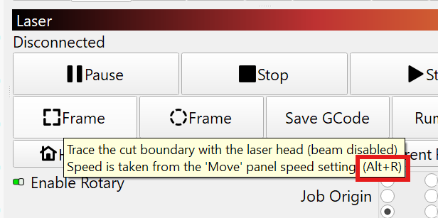

The Key combination for Framing is Alt + R
You can find most key combinations in the Tooltips - Hover over a button to see this:
These hotkeys can also be modified at ā€œFile > Preferences > Edit Hotkeysā€

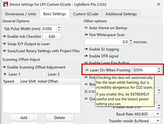

But!: The laser is not on during framing by default, hence the need to hold the shift-key when you click ā€œFrameā€.
(There is an option in the Device Settings to enable ā€œLaser On When Framingā€, but it’s disabled in the device settings and I’d like to make sure, it works with our dev’s instructions before changing anything)

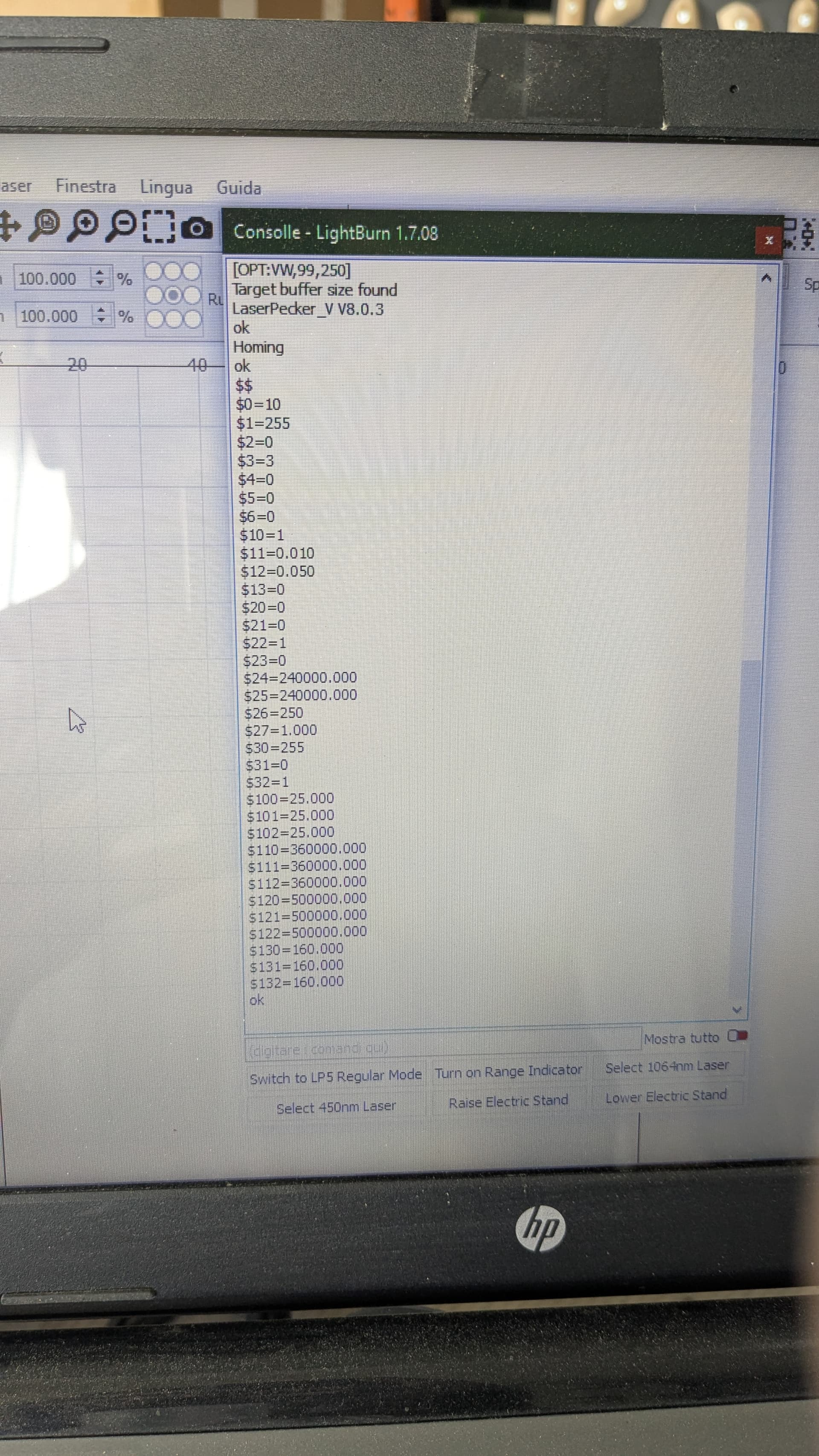

Please send us the reply of this command in the Console Window, so we can see your firmware settings and evaluate whether there are additional steps needed. Enter this in the command prompt and press ā€˜Enter’: $$

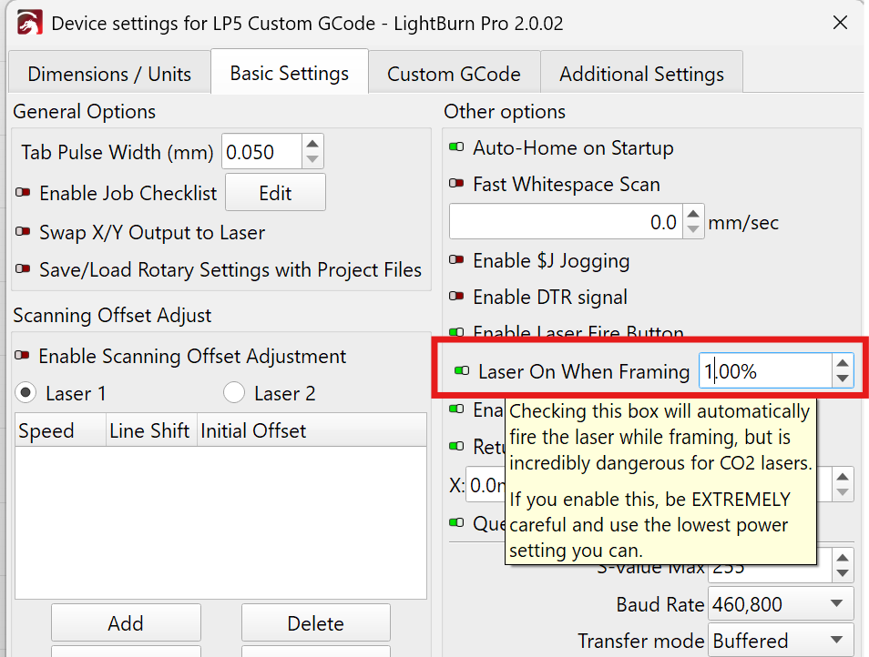

If willing, in order to get a well-working device profile for everyone else, could you answer these questions:
  • Did you have to change anything else besides our instructions?
  • Paste us the reply from the console when you enter this command: $$
    (I would like to double-check on the firmware settings for $30 specifically.)

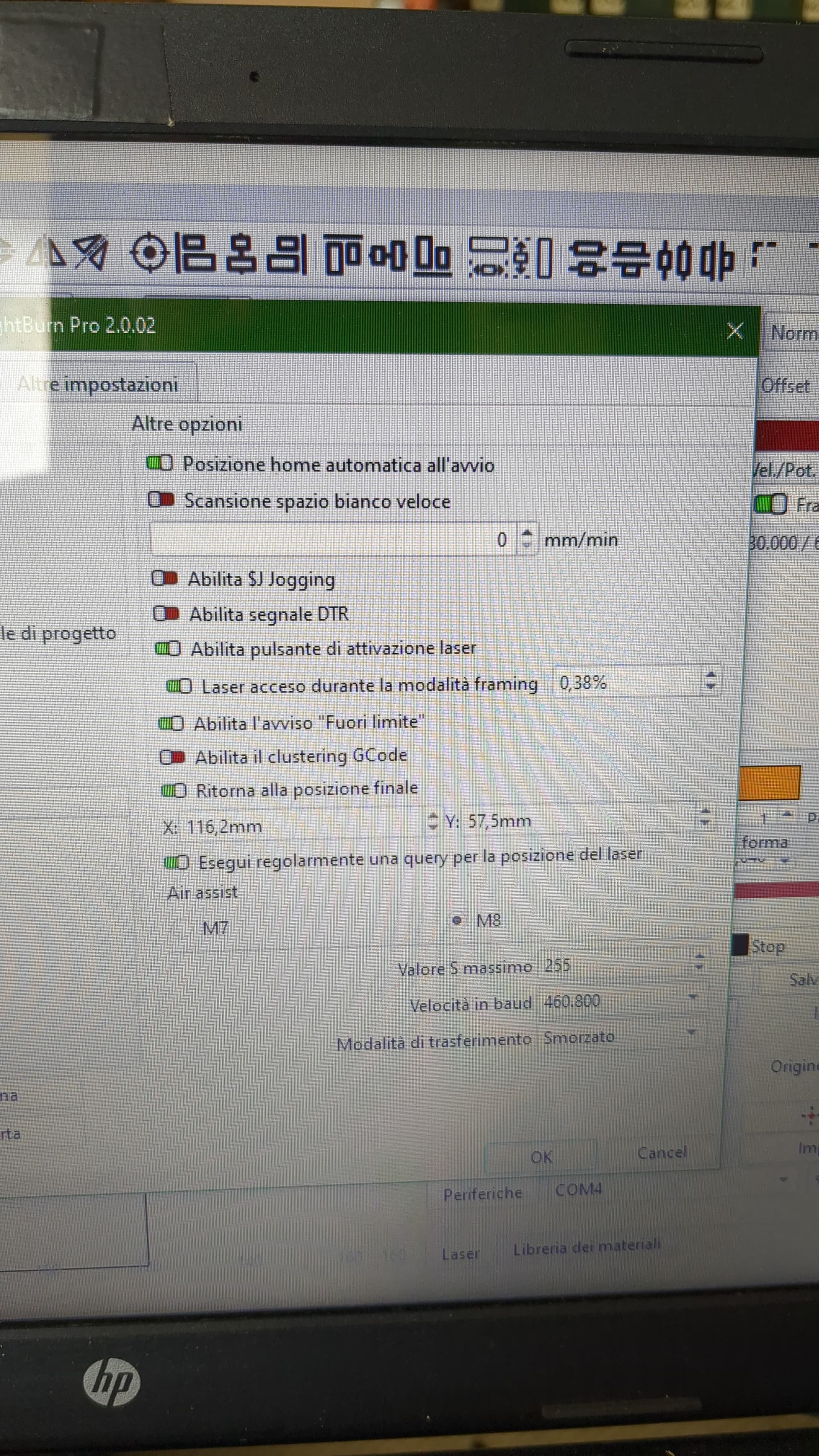

  • If you enable ā€œLaser On When Framingā€ in the Device Settings and set 1% next to it:
    Does the laser still turn on, when you click ā€œFrameā€ without holding the shift-key?

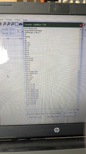

where do you put the $$ symbols?
Go to ā€œWindow > Consoleā€
And enter $$ here (with your laser connected). Then press the ā€œenterā€ key on the keyboard.
After this, right-click above it, choose ā€œSelect Allā€, copy everything, and paste it in a reply.

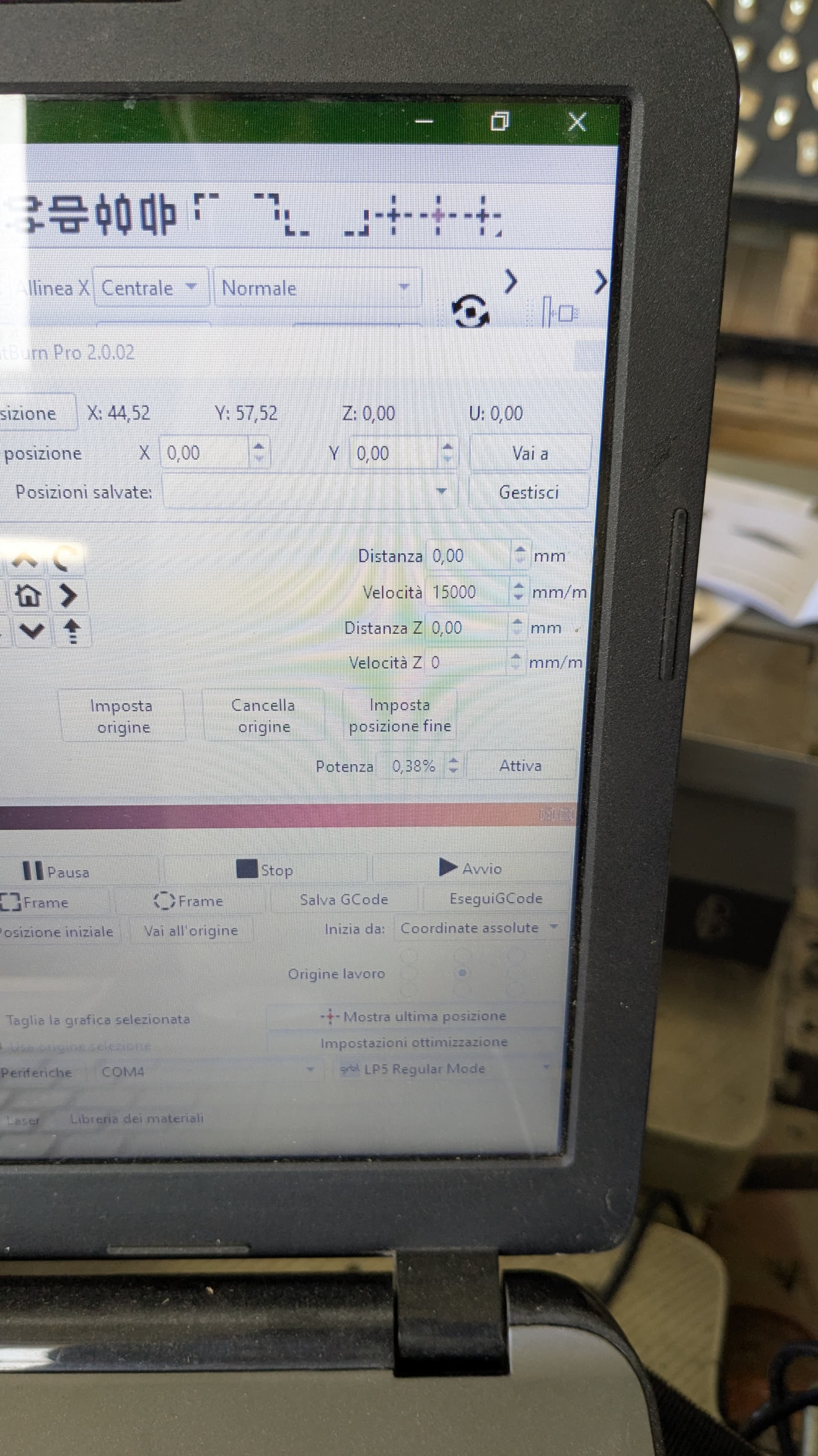

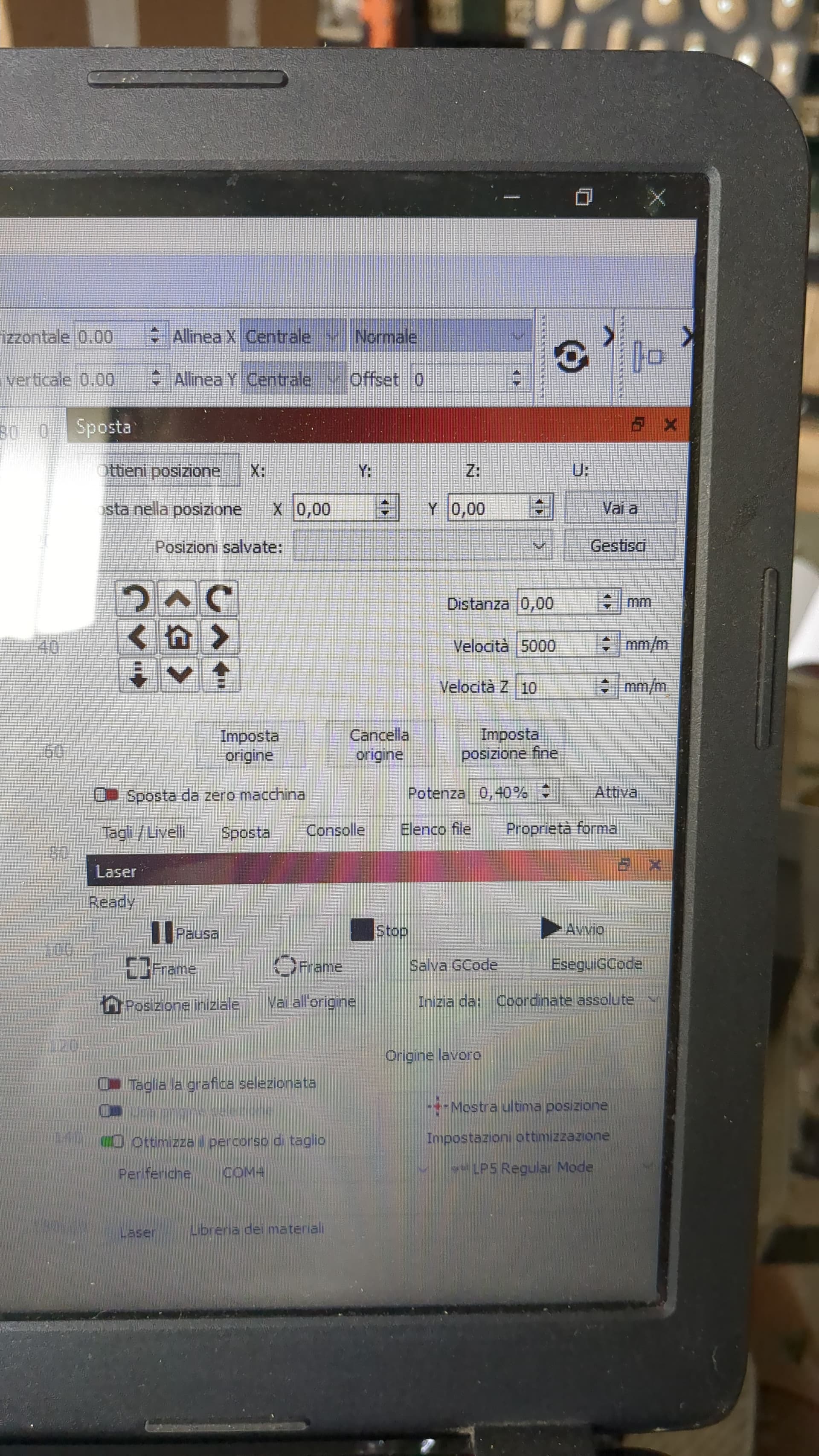

the minimum power at which the frame starts (which I set to continuous mode) is 0.4%

Perfect, thank you for the picture! The value for $30 is at 225 and matches the S-Value in our Device Profile. - That’s good.
Good to hear. Does the laser still turn on, when you click ā€œFrameā€ without holding the shift-key? (You will need to enable ā€œLaser On When Framingā€ in the Device Settings)

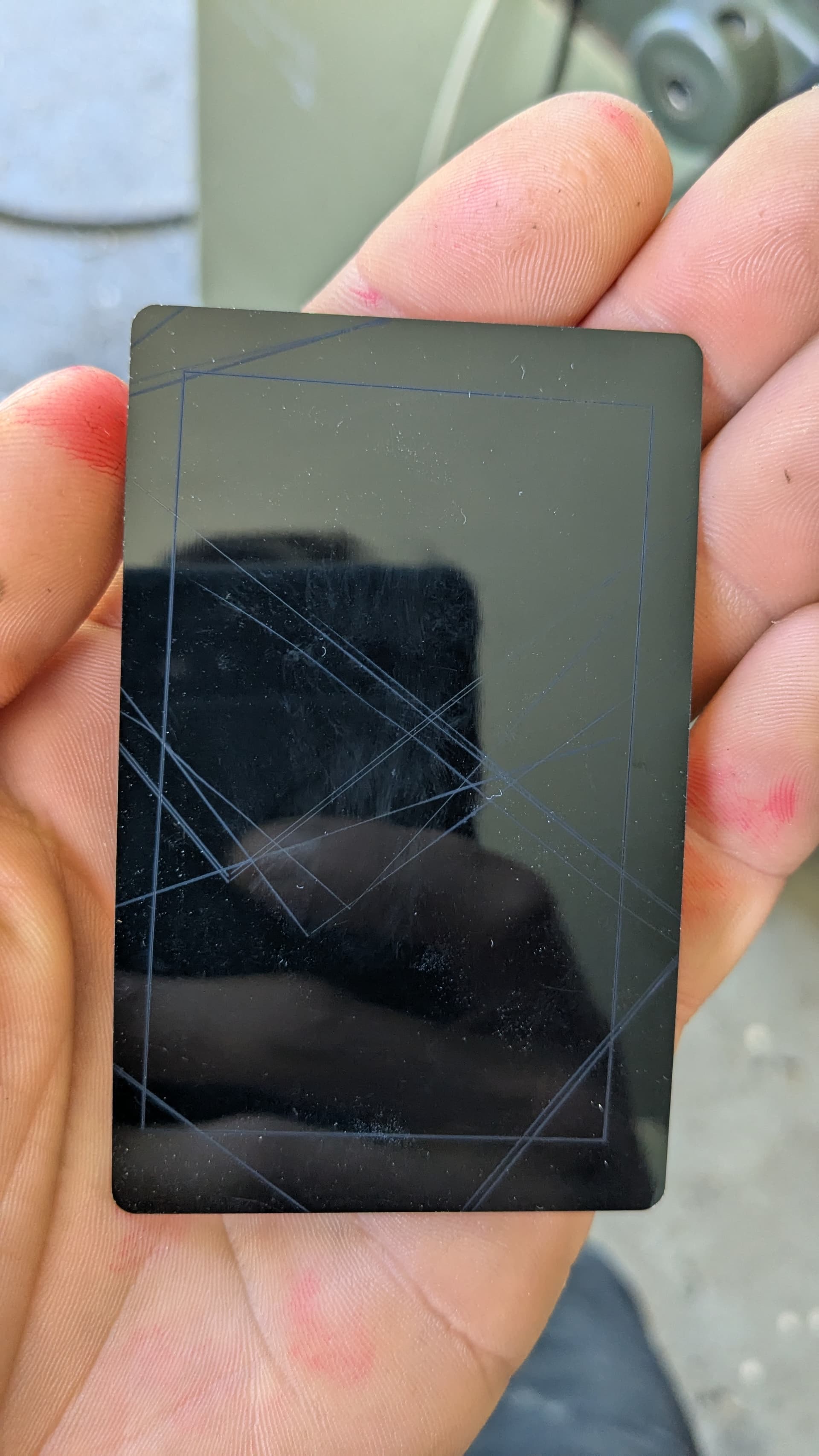

I updated the software to the latest version. Now I could lower the power during the framing phase to 0.38%. The problem is that even then it still leaves marks on the object.
