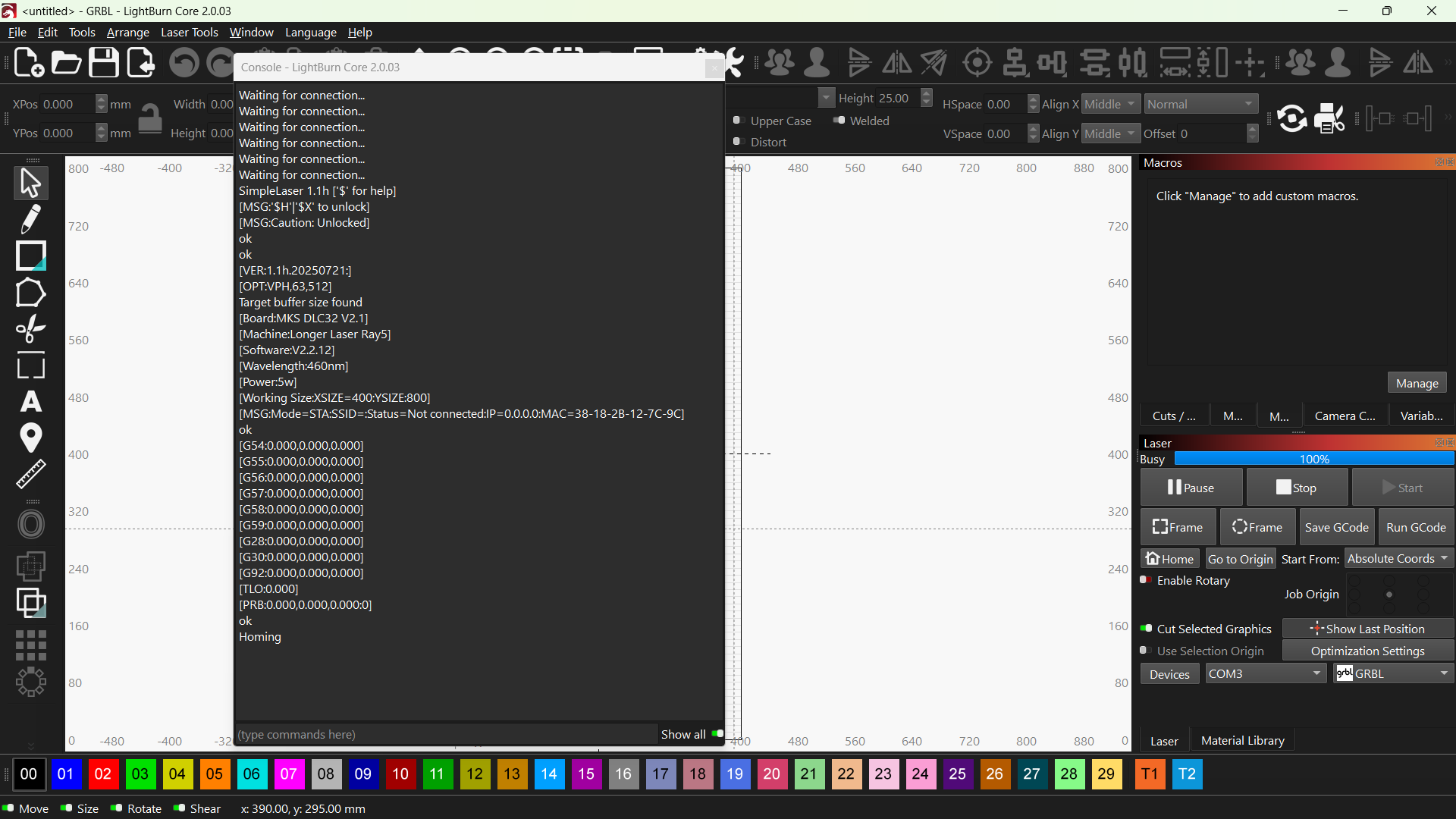

The Laser is throwing a code if I move in the Y direction on one computer and the other Y direction on the other computer. I do not have something right the in settings or a slight possibility that something is wrong with the machine. Probably settings.

I’ll screenshot the codes and the settings to get them looked over.

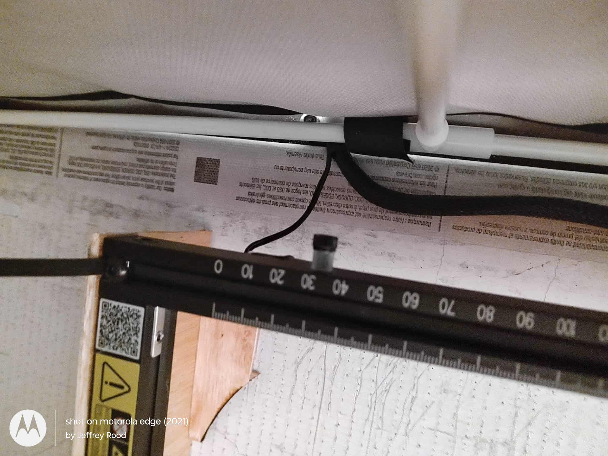

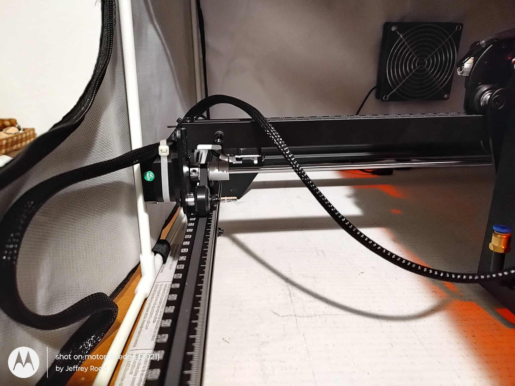

This is after I deleted the previous setup and did it manually. It is not jogging and when you hit home it runs to the lower left corner by the controller and crashes into the rails.

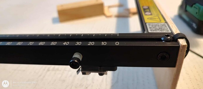

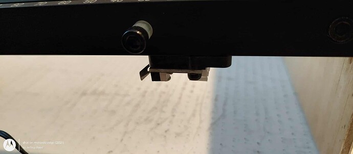

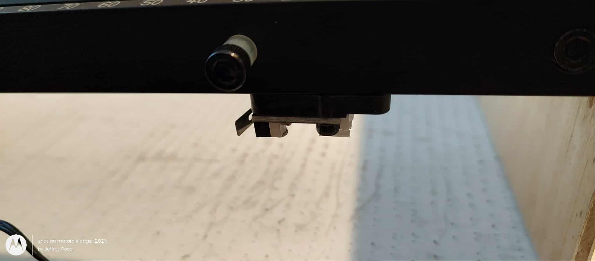

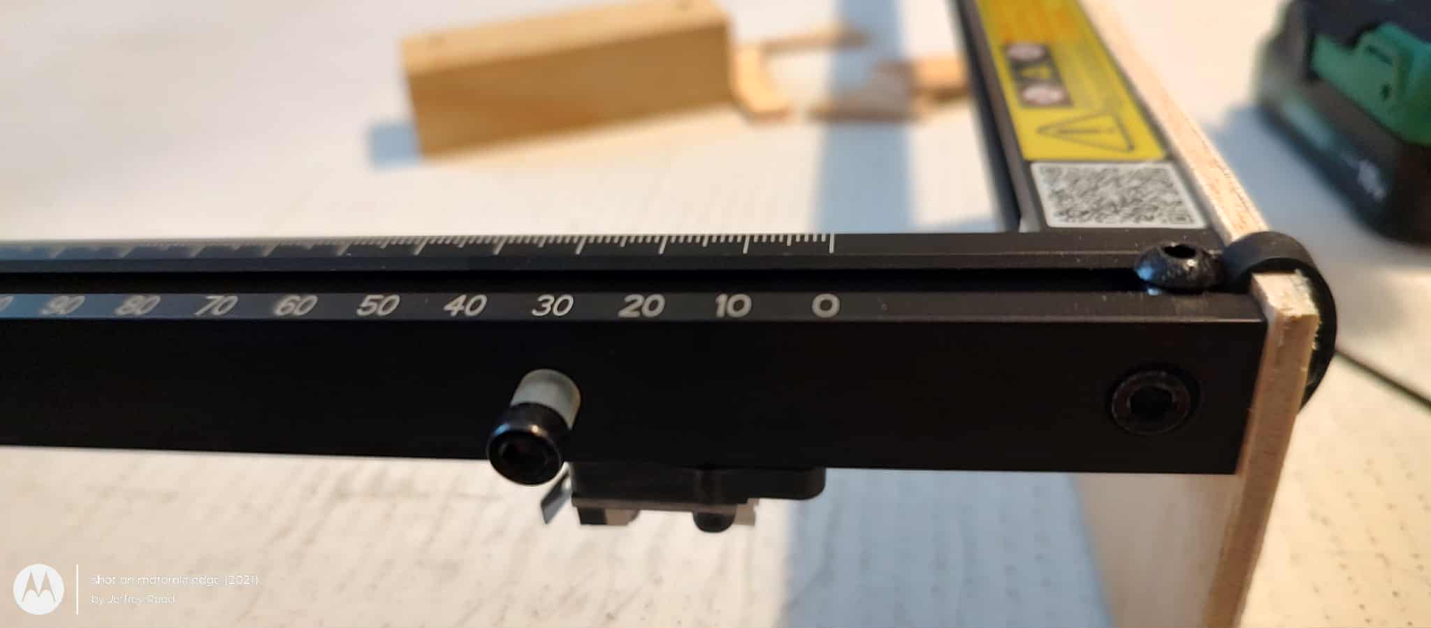

Does it have limit switches, and where are they located?
I have asked someone with Longer for some help with the location of the switches but I am waiting for the answers.
I know something has to be moved. What I don’t understand is why it stops sometimes in the middle of the bed.
I see limit switches, but it is difficult to tell where they are located, and whether it is 2 or 4 of them. The lower (front) left is a common location for them.
Those are mechanical, so you will hear them click when actuated. With power off, manually move the laser to the front left and see if you can hear them click. If not, try the other corners one at a time.
We need to know which corner should be the Home corner. Until we know that, it will be difficult to proceed.

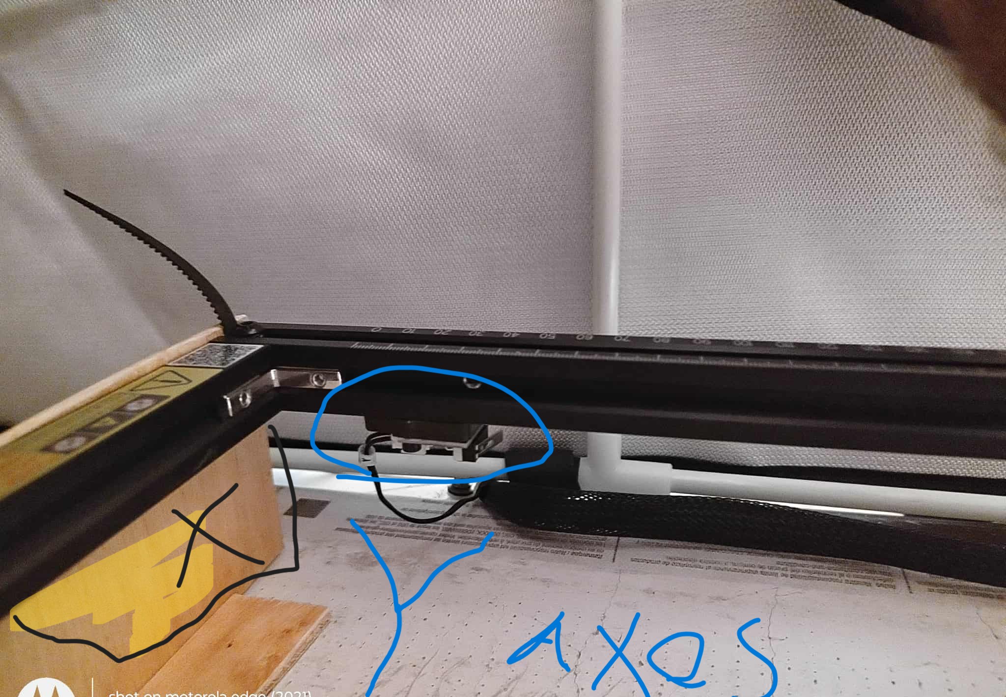

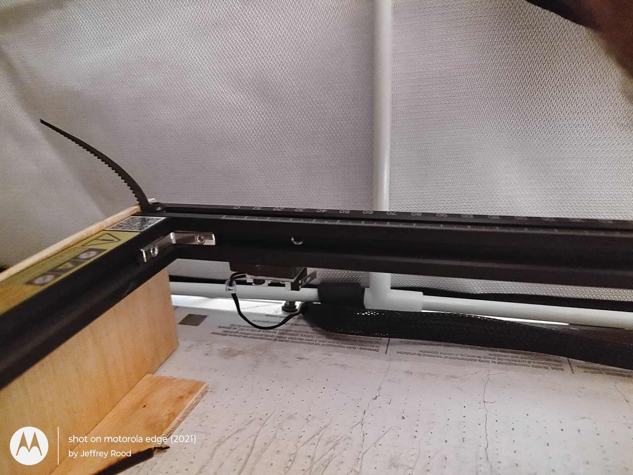

Just out of curosity, did you assemble the machine and install the limit switches?
This first pic is the Y axes limit switch. the Luan on the right is where I removed the control box to be outside of the enclosure. It is mounted right outside of the enclosure. the limit switch is clicking. Yes I unboxed and built it with the extended Y axes rails.
I have contacted Longer again trying to get any help from their side. My XTool D1 does not have limit switches and it homes and knows where to go. That is the only experience that I have so this is strange to me. Thanks for helping out what you can.
