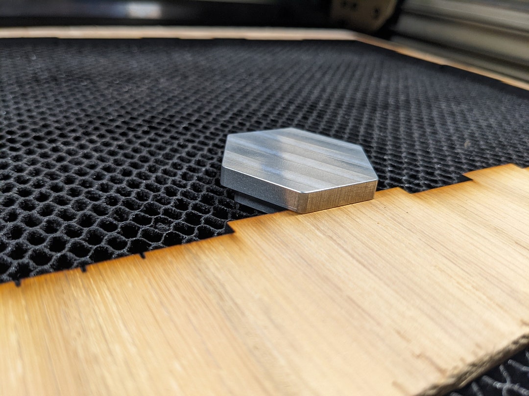

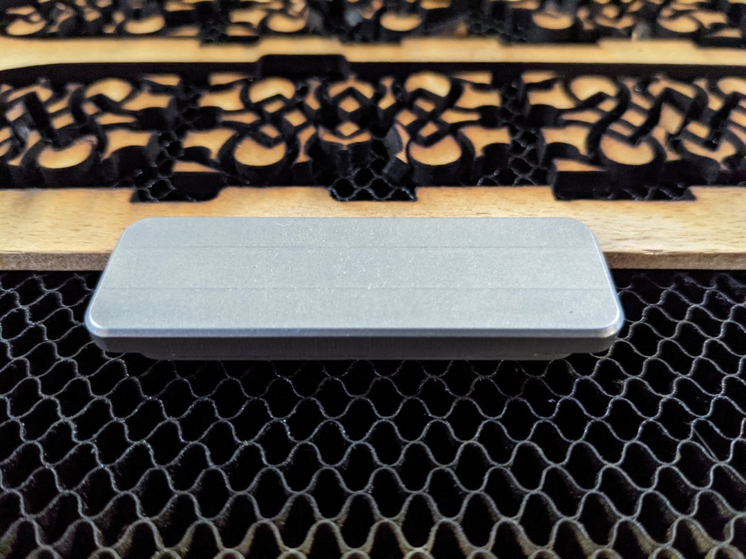

I found that by placing steel blocks such as these helped with keeping the material even
Also these type of magnets that are milled to hold down 3mm and 6mm/1/4in work well. I bought some very well made here in USA ![]()
Also other longer versions available

I have found ways (although I really like those magnets you linked to) to hold down my work when cutting on the knife blades and directly on the honeycomb, but when I use the golf spikes, the unevenness of the honeycomb and any warping of the material makes the boards wobble because the surface area is now (MUCH less) a handful of points rather than a somewhat flat surface. And it is almost impossible to implement a way to hold the material down to the spikes without adding more unevenness (I have tried). Not sure if this is making any sense.
