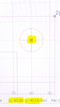

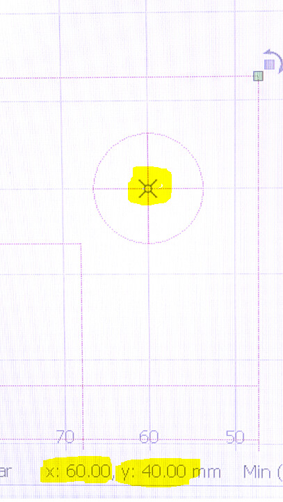

From what I understand you’re trying to adapt the laser to the jig, but I think it’s easier if you adapt the jig to the laser, i.e. if you take your jig and set the target in this example at X=60 Y=40 add another target also integer to make it easier,
and fix the jig I think you’ll get what you want.
For repeatability, you can have a base that is fixed to the laser or rests on reference points (for example, a right-angled piece) with two shafts at the points of the targets and then just place all the jigs you make on top of that and everything will be fine.
You can also add 2 more targets to validate the alignment.

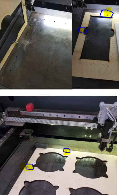

Here is an example
Notice the 2 screws

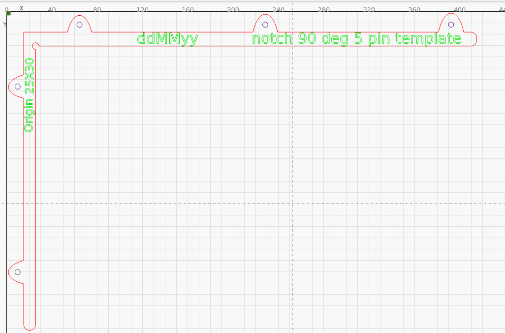

I believe that @ednisley has an angle plate at a corner.
I use this one quite a bit… not really targeted to any one particular size… Just a known origin and square with the machine.
I enter the 25x30 values in to move the machine to that spot, then set a user origin.
Sorry I don’t have a photo of it in the machine…
IIRC, that’s @jkwilborn (who’s faster on the Reply button than I am).
I generally use fixtures with targets aligning a tool-layer template with Print-and-Cut. That eliminates the need for the screws: no matter where the fixture sits, the template is exactly aligned with it:
I hold the fixture in place with tape or some such, which is permanent enough for a day in the Basement Shop. If I were in production, screws would make more sense.
