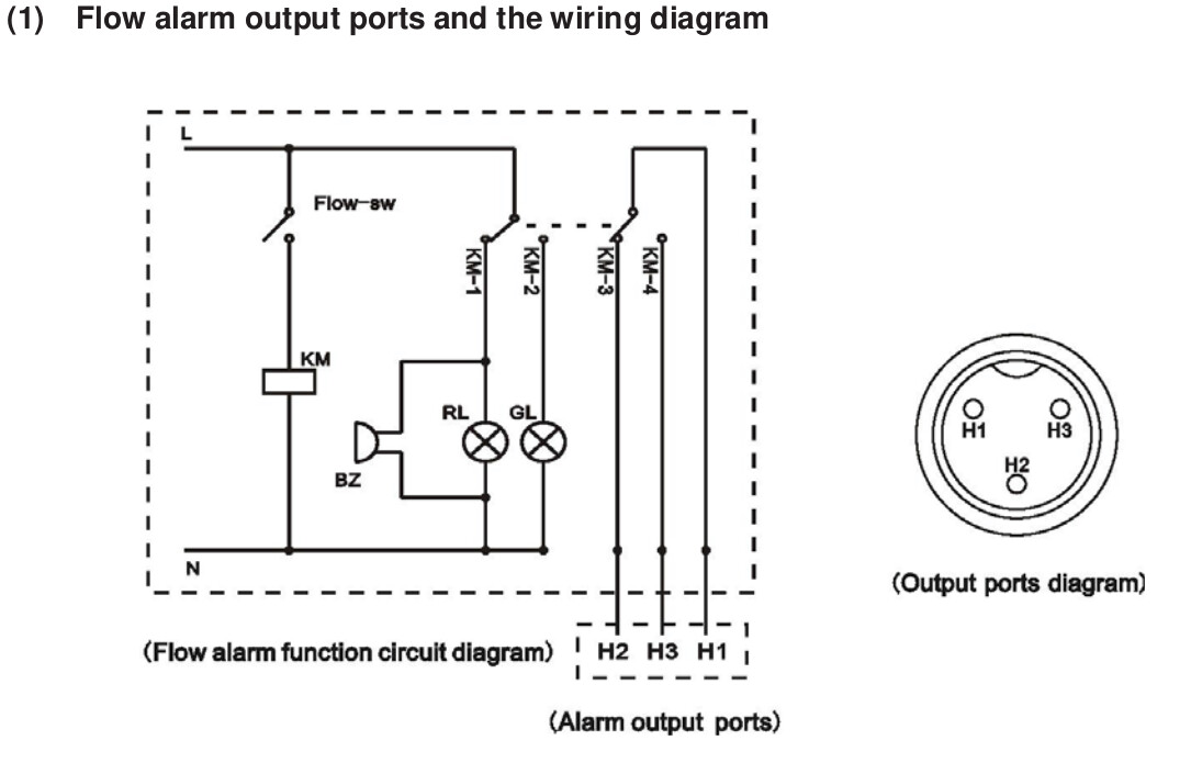

I have a 900x1200 dual head Chinese laser using the CW5200 cooler. The 5200 cools 2 tubes. When one of my water protecter switches went bad, I turned off water protection alarm and stop in the Ruida software. The CW coolers beep if there is not enough pressure. if the cooler is running you can squeeze the coolant tube to see if the beep alarm is working. I am still using the same tubes for 9 years…
I’d suggest you take a few minutes and connect the 5202 to the Ruida. It will stop the Ruida if there is a failure, allowing you to continue when corrected.
The way you have it wired, it’s guaranteed lost job. If you forget to turn on the chiller, you have no warning.
Wired to the controller it covers all the bases…
These are pretty smart machines… I might not be like you, I get focused on my work and don’t/can’t remember the simple stuff… much easier to wire it up like it was designed and have it watch itself instead of me watching both the machine and the job.

Hi Debbie, I am not very good at electronics, but if if you think there is a water switch problem and the software will allow you to temporarily bypass the switch and that make it work, then that would be an easy and cheap way of troubleshooting the issue. In your original post you mentioned a water chiller error. I do have the directions to read the controller data, but the water protection switches are probably listed as on or off in the read. Someone else could tell you how to change the parameters and bypass that switch for testing purposes.
The ability to disable the water protection in the Ruida was advanced to her in post 10.
