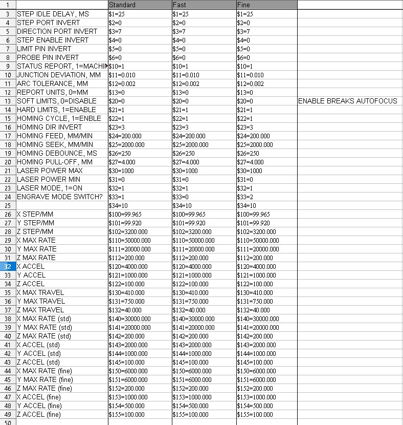

Noticed something odd…
$140-$155 seem to be using non-standard values. I think these may be the mode switch values.
When I first connected this machine, find device identified it as GRBL-LPC, but I was advised here to change it to GRBL. I have no idea if a different flavor of GRBL would interpret these values differently, but the machine seems to be operating as expected other than not reporting these non-standard values correctly in Machine Settings and being unable to read or control the mode from lightburn.
Thoughts?

Comparing $$ outputs while the three different engrave modes are active, the only line that changes is $33.
Fast mode has $33=0
Standard mode has $33=1
Fine mode has $33=2
This must be the switch
I also have $34=10 for all three modes. I can’t figure out what $34 is supposed to do.
Confirmed. $33 is the mode switch and can be controlled by macro or console within Lightburn. Current mode updates on the touchscreen for verification after sending the code.

And I also now have the default accelerations to tune these modes as well as the preview/simulation timings (too bad these values aren’t updated in preview, but I’ll run in std 95% of the time anyway, so that’s what I’ll plug into it.). Fast mode needs to have the Y axis accel softened slightly to be even vaguely useful. Possibly because of the longer belts in the extensions.
