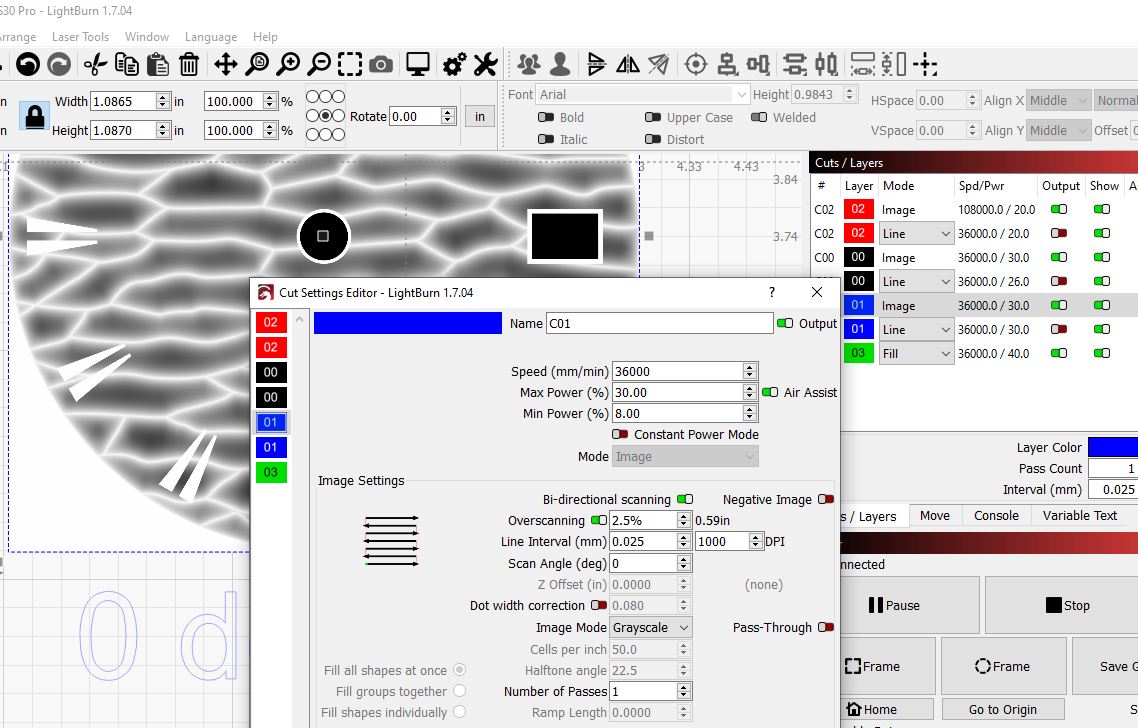

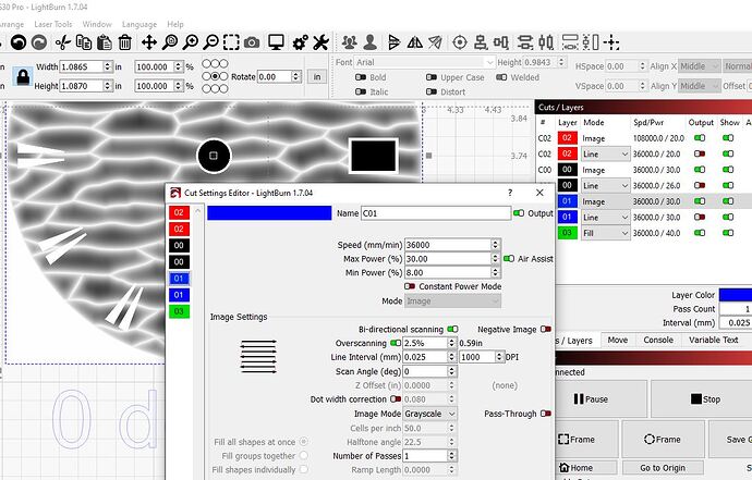

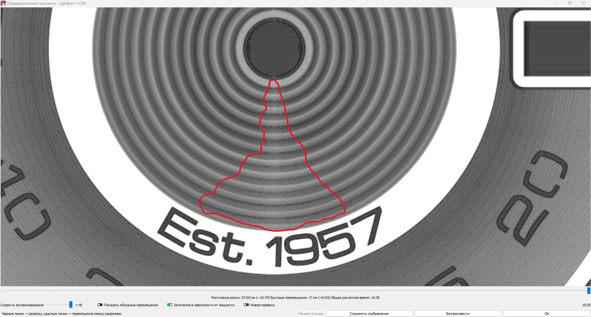

I'll bet you $100 that the problem isn't with the files or my hardware. Grayscale - The problem is still not solved

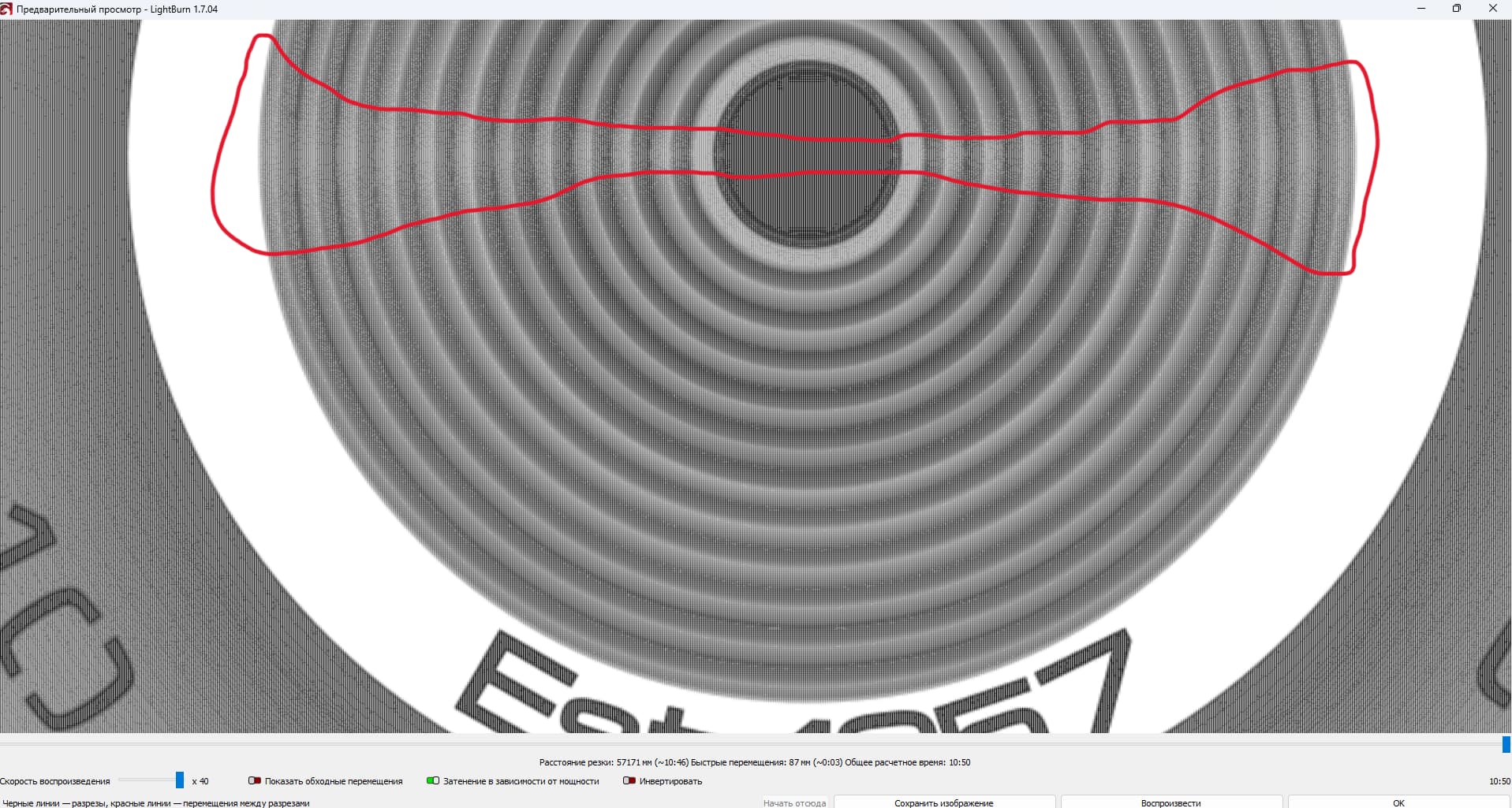

With a big preview window and a little one, I centered the problematic zone in the window and pressed “+” key (repeated 10 times and checking preview each time) and no artifacts.

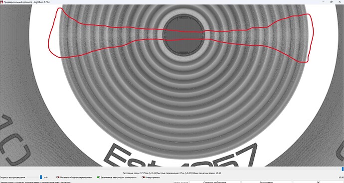

The vertical ones are moire patterns, but the middle lines are not moire. I described it here:
Grayscale - The problem is still not solved - LightBurn Software Questions - LightBurn Software Forum
Can you post the power graph for your laser source? There is a breakpoint at certain frequencies per each q pulse.
Q pulse 200
break point 40 kHz is the maximum (all test measurements are made at this frequency by the laser manufacturer), everything below is engraved with a drop in power. But I do not see a relationship. The frequency does not change. Q pulse is constant

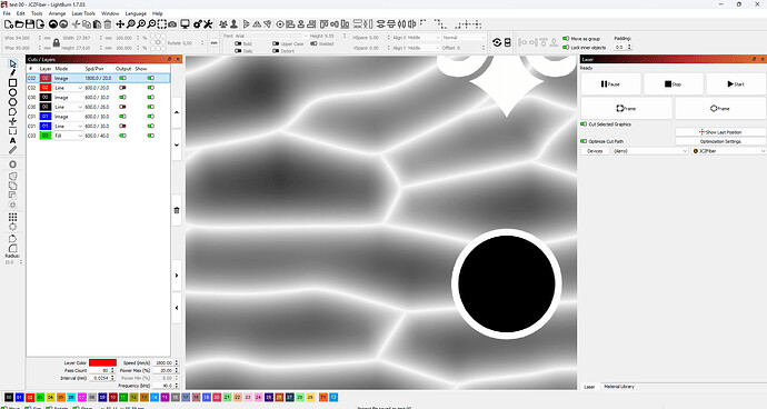

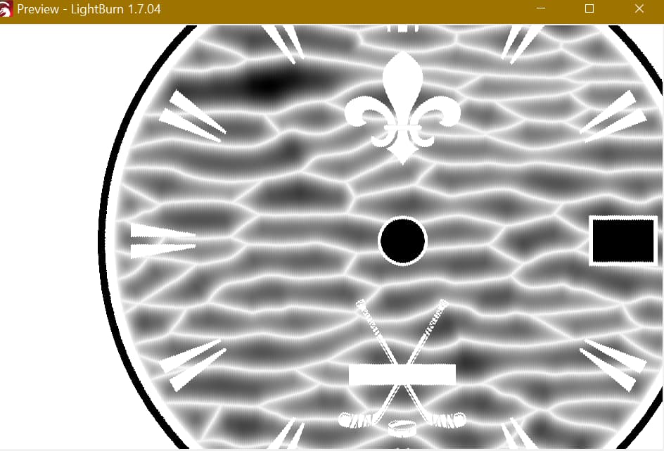

Unless there is a difference in the rendering engines, I concur it is a laser issue (yes, I know you said not to say that). I loaded your test file and looked for the artifacts, I found none.
I tried different frequencies. The result does not change. You will not believe how much metal I ruined lol. I changed the laser settings, delays, image resolutions. I use more than just this image. The result is very similar
artifacts appear in the preview. It just looks great in the program window
Can you upload my file to your machine? Because the guys who upload the file don’t have fiber optics. Thanks.
Sure, what materia did you dial it in for? I am working on a way to induce the same issue. Really want the $100!

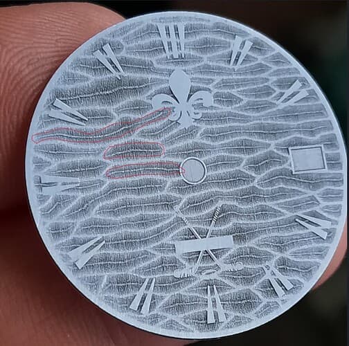

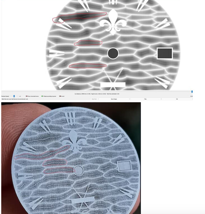

What you are showing here in these posts is an artifact in the drawing of the preview itself. There is no guarantee that the machine output will have the same issue. The lines being drawn on the display will either overlap slightly, or have small gaps, and that is the cause of these small artifacts.
In those places where the preview shows more gray lines, the laser power is reduced and the engraving in these places will be weaker. This can be seen in this screenshot. These are not moires

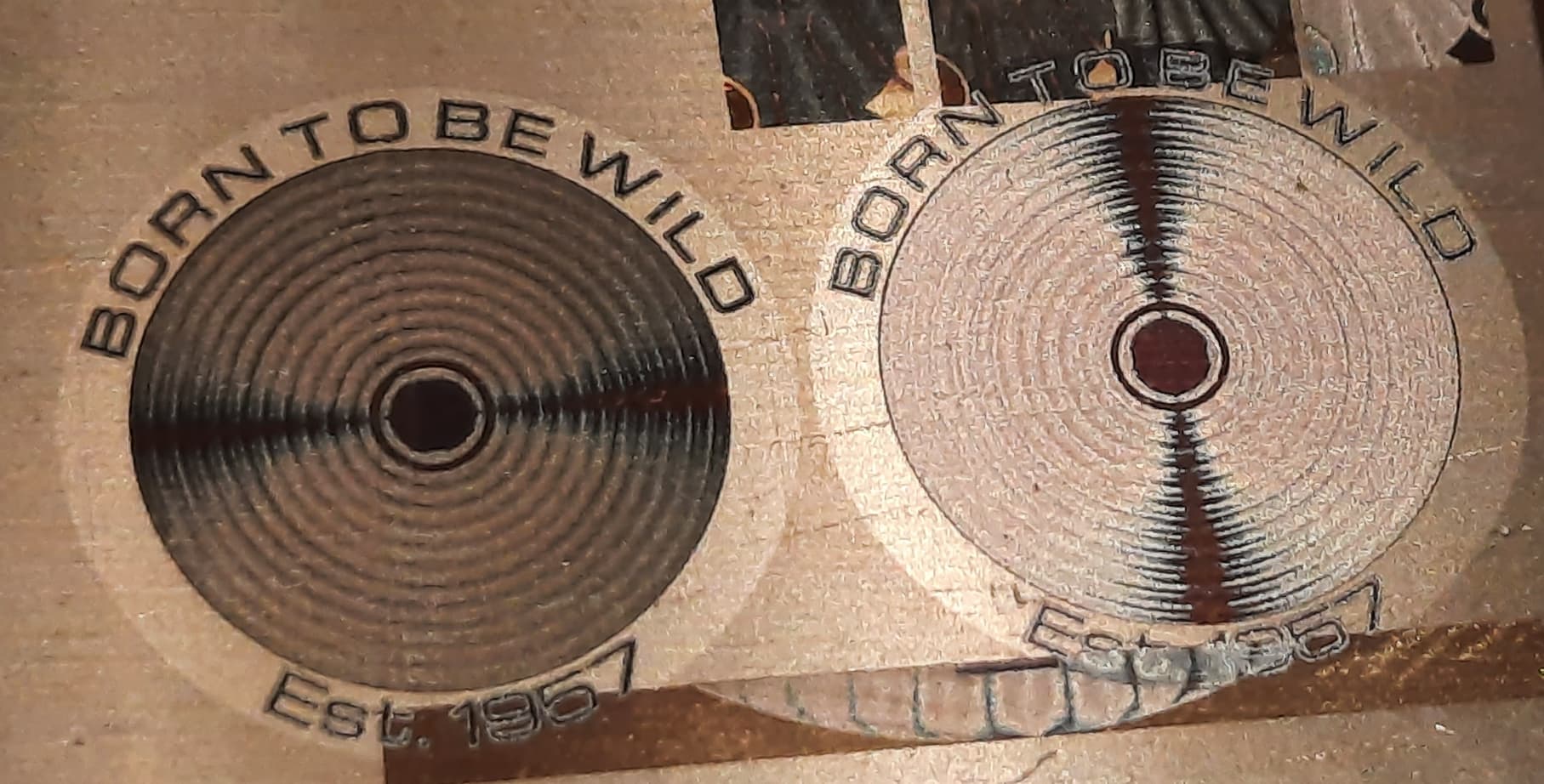

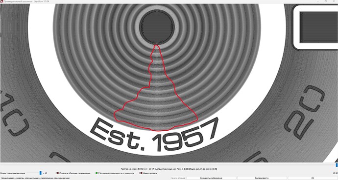

It’s not just this drawing, there are many other drawings with this problem.

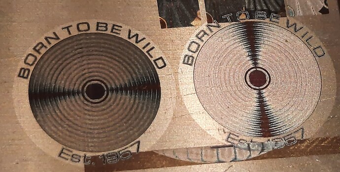

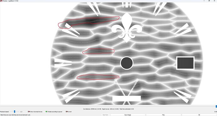

Here’s another example. In the preview, lighter dots appear in this area and they are visible when engraving. They are less engraved than the rest of the background.
When changing the angle by 90 degrees These artifacts also move as shown below

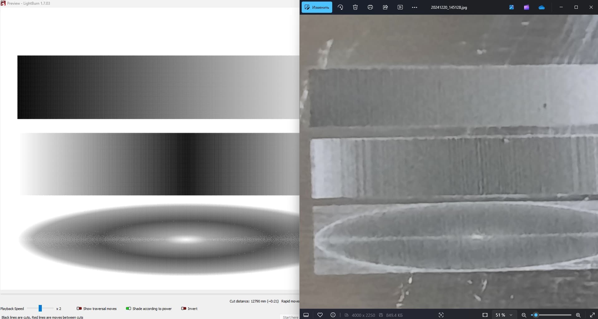

This is what it looks like on metal (This is definitely not a distortion in the preview):
