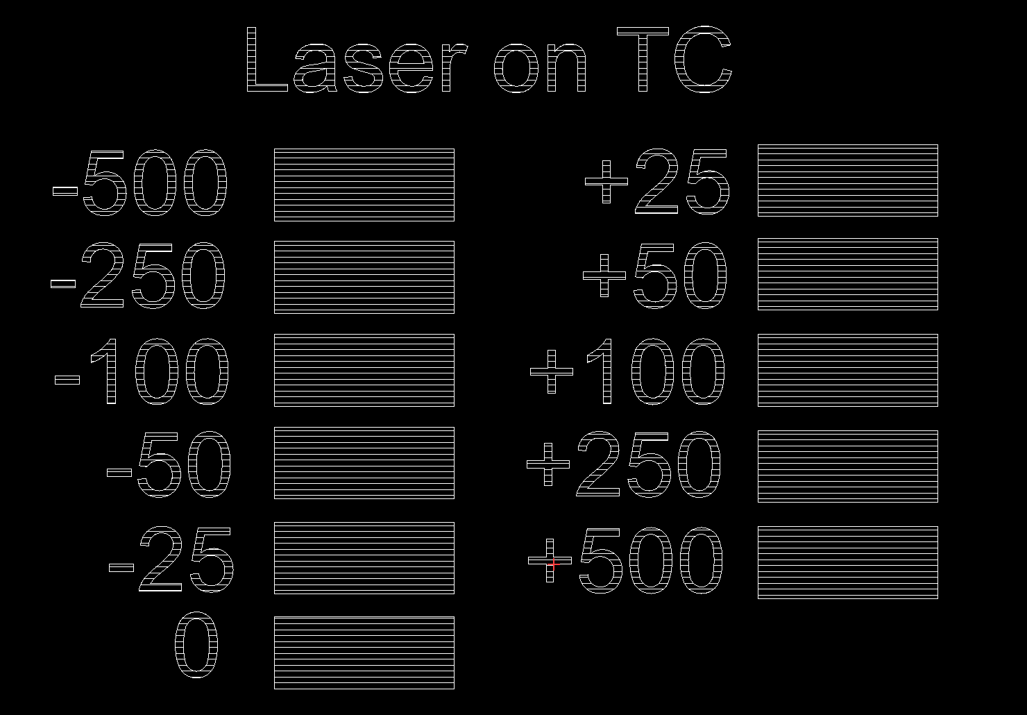

You may need to increase your “Laser On TC”.
That’s the “microseconds the laser will wait to fire after the mirrors begin to move. Too high a value will leave gaps, while too low a value may cause excessive burning at the start of a cut.”
Can you run the attached file and send us pictures of the result? You are looking for a range where the starting lines are just touching, without any gaps or burn-in at the beginning.
Laser-ON-TC-Calibration-negative.lbrn2 (96.2 KB)

If you increase TON, it will shift the start point to the right. If you increase TOFF, it will shift the stop point to the right.
You need to make a horizontal raster bar with this feature and two vertical reference lines vectored above it at the 4mm and 5mm point.

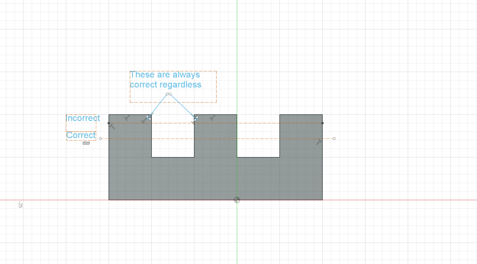

This is not a timing problem and CANNOT be improved with tuning. Say you have a horizontal line that has 1mm on, then 1mm off, then on, off, and ends with on. Three 1mm dashes with two 1mm gaps of white space in between.
The middle “on” will be correct, as it is at CV.
The start and ends will have an overburn. The cut is in the correct place. The overburn is just inside the start/stop lines.
Increasing TON delay would shift the margins of the second (middle) and third “on” start point as well, which would be incorrect. This would detune the galvo and would have sweeping negative consequences. Once you go bidir or rotation, the start points won’t line up due to direction changes and it basically doesn’t work.
This could be “fixed” when anything moves the margin of the design further out, so all 3 dashes are treated like the middle dash. For example, I add a very thin black line to the Fill operation 0.5mm to the left and right of the outer dashes. Assuming LB is configured to scan all at once, not individual features, and we’re scanning horizontally, then LB will see that line as content and have to start and stop the line scan 0.5mm further out. That’s all that we need to do so the left and right 1mm features are already at CV and have no overburn.
Unfortunately, I can’t just add an extra line that actually gets burned, as it would come out in the final design. I did wonder if we could “trick” LB by making a thin offset line that LB would recognize it as a new boundary outside the object needing to be filled, but so narrow that LB’s code might decide it should not actually fire there.
Basically if the code just took the content and did say a 0.5mm Offset around it to determine a raster line’s start and stop points, even though there’s no content to fire on there, that mostly does it. It’s not actually right because if you were burning a single horizontally aligned square with the raster lines going horizontal, it would think it needs to scan a 0.5 mm line of white space above and below the actual rectangle (if we’re literally just doing a “dumb” Offset to create the boundary).

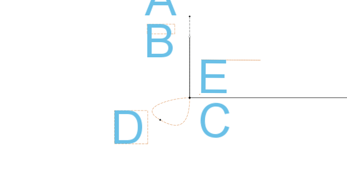

We don’t have to take this one on right now, but the same problem does exist with vector lines. We do see the vector lines are overburned at start/stop/corners/tight curves at higher speeds due to this. That’s got some ways to correct it,.but they’re somewhat situation-dependent. The Ruida on a CO2 laser automatically calcs the ratio of its current speed to the commanded speed and uses that ratio to scale back the laser power. I do see that this sort of power scaling problematic because the BJJCZ apparently does not implement this, but it’s a deeper problem in that at least the JPT M7’s control interface uses a long, slow packet to perform a power level change so that’s probably not an option because it can’t be done at high speed. Also, I’m not sure if changing the power level when moving slower than the commanded speed would be the ideal response or not. And it’s assuming the mirrors move with constant acceleration, which isn’t actually the case. The Ruida was the one creating the steps and doing the accel calcs (which are not as simple as a fixed accel, it does slightly different things for curves vs corners etc), so it always knows its instantaneous velocity exactly. LB would only be guessing.

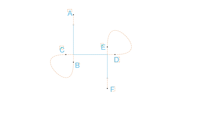

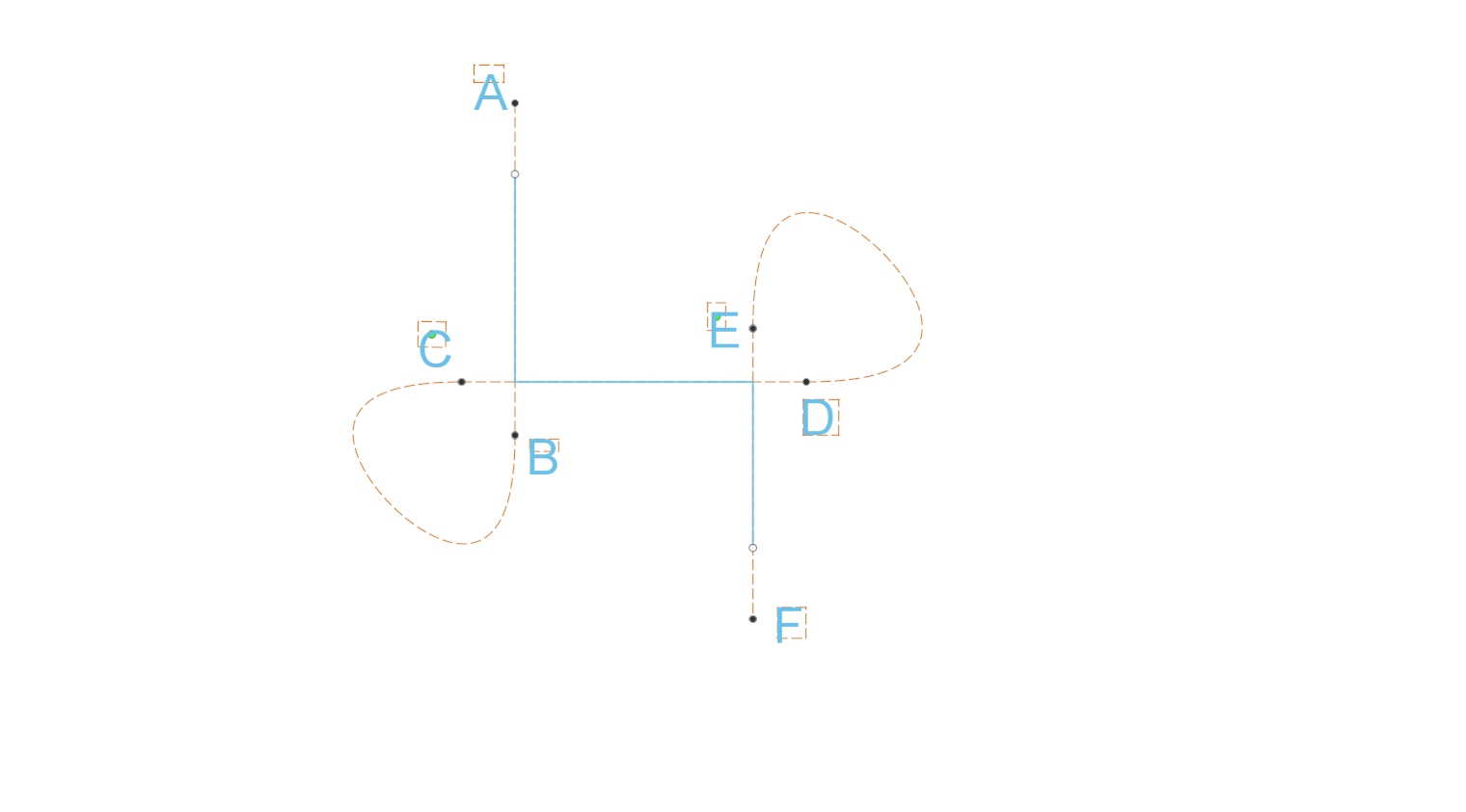

What LB could do is apply an overscan margin to the start/stop of every vector- that would have to be an option the user could turn on or off for each layer. In that case, it would not actually corner, but this. The dotted line is the mirror path, but it only fires on the solid lines.
LB would command a vector move from A to B, the C to D, and E to F. This not only corrects power inconsistency but rounding and any residual mirror wobble. It’s a bit slower, but much more accurate. But, in practice, it’s likely FASTER- you are free to speed up the mm/s as fast as it can go because there won’t be any rounding of corners, wobble, and power inconsistency.
Of course that’s obvious for straight vectors at right angles. But if the design’s vectors covered by vector A-B and C-D were at 170 deg from each other, this probably wouldn’t make sense to stay at CV as it passes the first corner, cut off the beam, overshoot with beam off, then swing around to point C. There are different options there, usually just a max cut-off angle of how sharp a corner has to be to do an overscan.
Tight curves are even tougher questions. My question here- I’ve already seen and understood that the JPT M7’s data interface just can’t accept power change commands at high speed. But we don’t even want that. We want the pulses to be equally spaced. Does the data interface allow the pulse freq to be changes at high speed, or is that the same data interface speed limitation? Basically, when the user asks for a line 1000mm/s 100KHz 60ns, and it’s in a tight curve where it’s doing 700mm/s instantaneous speed, the freq needs to reduce to 70KHz. Again, at that, LB could only, at best, guess what speed the mirrors are actually going. Is it even possible to write the change to freq at high speed, or does the laser source have a slow data packet interface for setting power, q-pulse, and freq and can only respond at high speed to a simple on’/off signal? I guess I need to crack open the manual again and answer that myself first.
See, yeah, this is what I’m saying. The raster needs to overscan, but so does vector. The line is matchsticked because it’s not CV yet. It’s running slow but still running at the commanded power without scaling back, and it’s getting too much energy per mm. It needs to overscan.

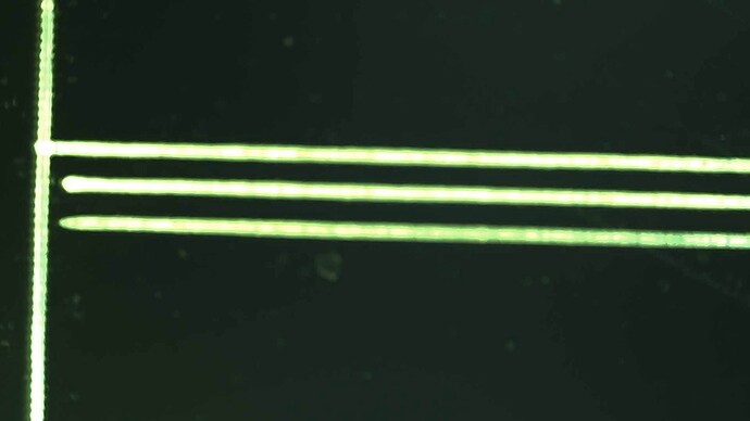

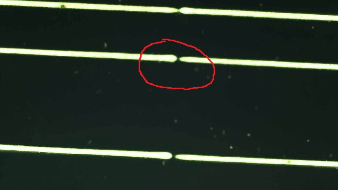

I have been doing a lot of TC testing and got a 2000X usb microscope to really have a look. Even at my steel engraving at 1900mm/s issues can be seen.
And setting your TCs on the aluminum cards at slow speeds does no good, need to set them for the speed and materials you are using. I like the option to override the settings on a per sub layer basis LB offers. Make a lot of use of that.

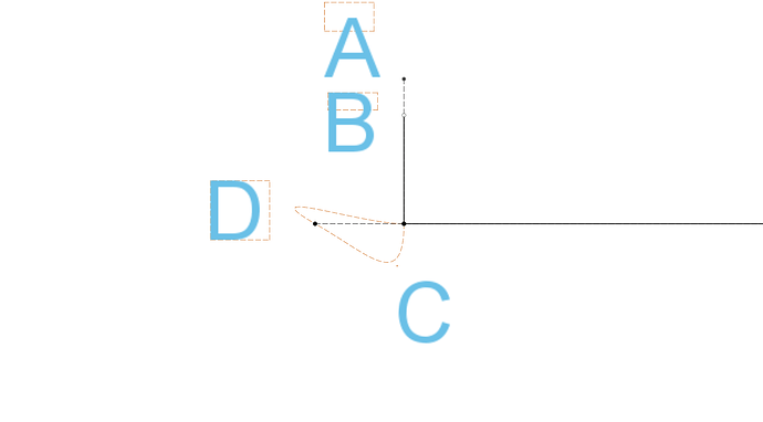

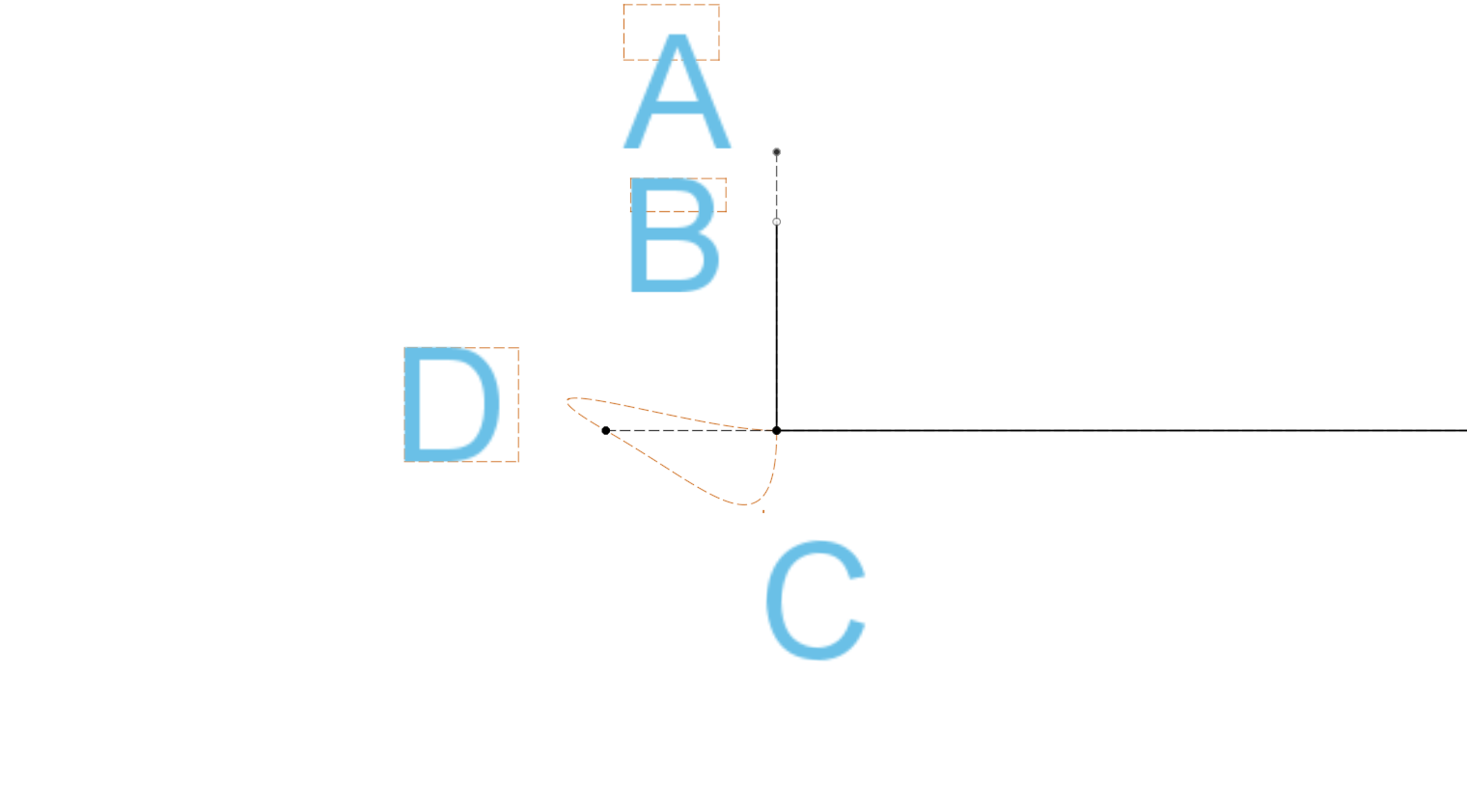

OK, I see that my diagram of vector overscan actually wouldn’t travel along the dotted line. It commanded to these points, it would physically do something like this:
The travel from (renamed) point C does not need to run out in a straight line. Once it passes C and turns the beam off, it should immediately move to the set-up point D to pass through C again. But, as shown for this 90 deg angle, that would make the continuous spline path have to reverse upon itself.
The fast, accurate way to do this:
We designate a virtual turn-around point D and move it so that the Y acceleration/jerk is reduced enough by the time it does the X+ pass through C (now called “point E”, it’s coincident with C but occurs at a different time and direction) that there’s no ringing.

In my examples exactly the opposite, fat matchheads at the ends and narrow tails at the starts.

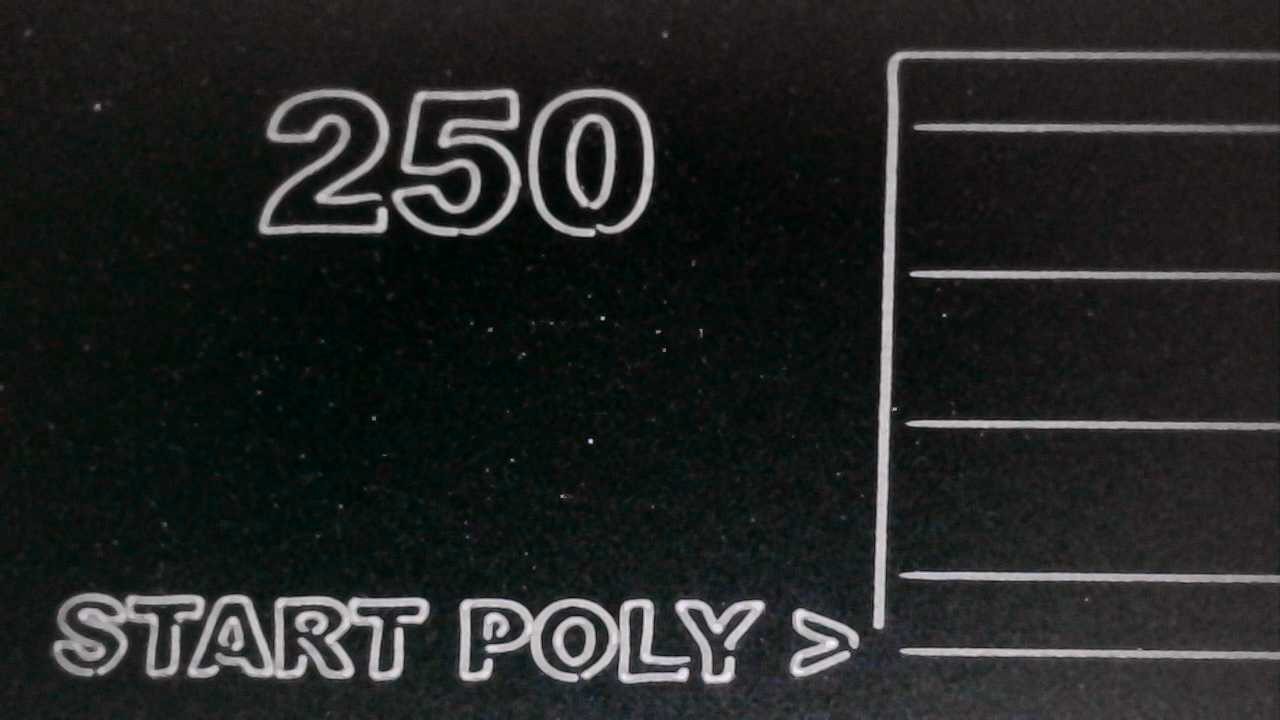

Here is a bidirectional test, starts bottom left, draws a polygon, then first line up from the bottom Starts left runs to right, second line up right to left, etc. I’m pretty dialed in but still can see matchstick at the ends and thin at the start.
Here are some left to right no bidirectional. Poly CCW
None of this is really that noticeable without the zoom, but when matching splits on my X table it makes a noticeable effect.

I may be barking up the wrong tree here though. My USB microscope released the magic blue smoke the other day, so no means to test myself.

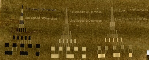

I ran Danny’s test at three different speeds on a Gweike G2 Pro. My main takeaway was that the ideal delay and jump settings are depending on the marking speed - not a huge surprise.
I’d be interested if you could gather more evidence showing that Galvo overscan would offer advantages, that timing adjustments alone can’t replicate.
Wow, 15000mm/s? That’s crazy!
The most common galvo used on fiber/MOPA is the SG7110. Spec is supposed to be 8000mm/s travel and 5000mm/s for marking. Actually, it looks like you can still ask for speeds up to 8000mm/s while marking, it sounds like they just don’t recommend it because of reduced quality.

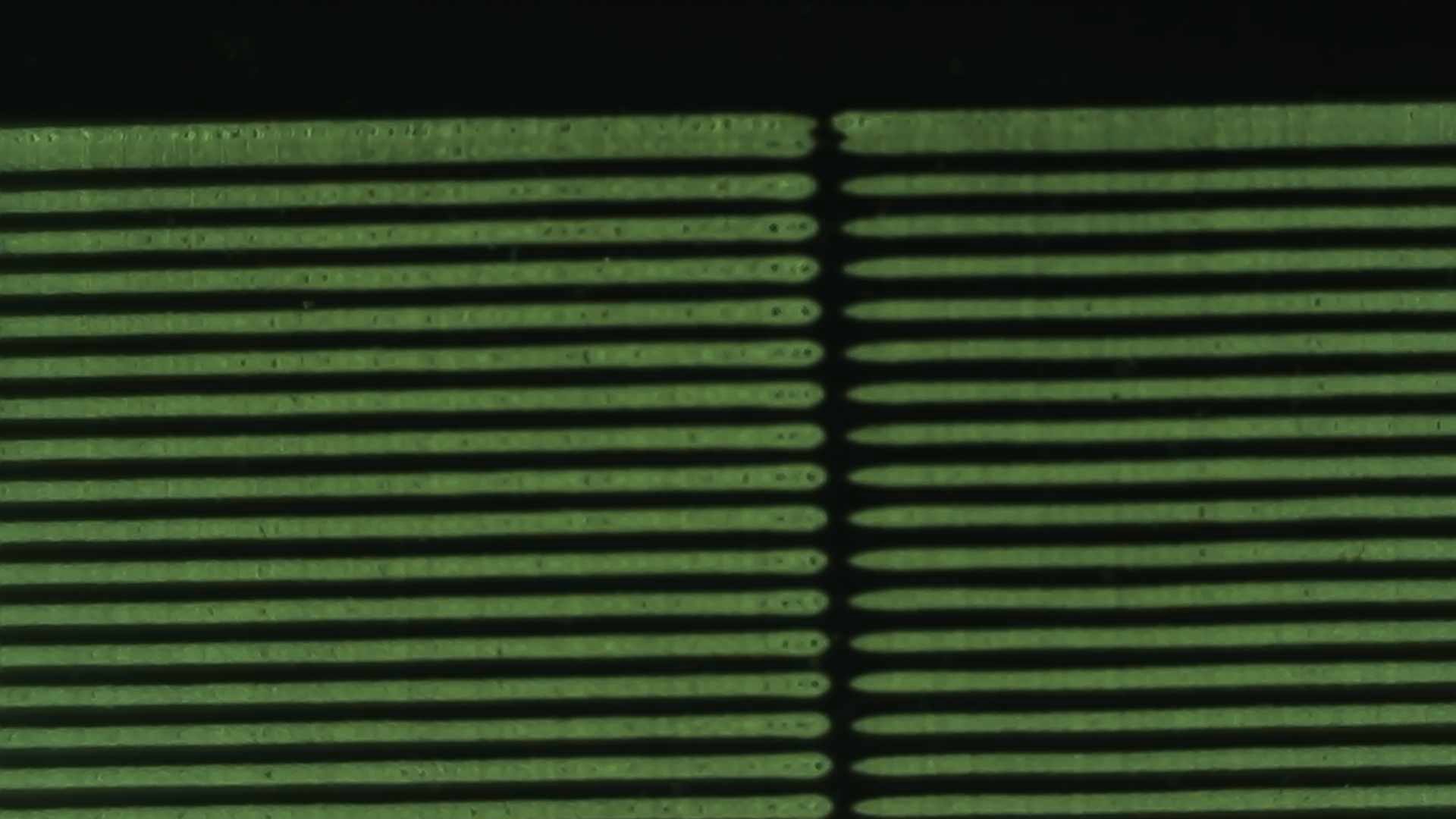

The thing is, I’d expect to see a SHIFT. Specifically, to the right, if the unidirectional raster takes it left-to-right.
What you’re showing, though, is that total on-time is contracting. the left starting edge is lagging. But the right edge ends too early. I am indeed surprised if this is accurate.
I would have expected that if there was a change in timing, it would shift both edges equally. Why would it be ending the beam prematurely?
I even see this at 5000mm/s. Start is a little late, end is a little early.

This does show the importance of the timing test for sure! You see what this means? If you were to do a crosshatch raster at 15000mm/s, the first pass burns the left side 0.03mm too short and the right side is 0.09mm too short. But the top and bottom of the rectangle of course just line up.
The crosshatch 90 deg pass, however, will miss the top 0.03mm and bottom 0.09mm of the rectangle. It will burn over the portion missed by the first pass, so there’s a smaller rectangular region which sees two burns but all 4 sides have an inside margin that was only burned once. If a feature in the artwork is smaller than the margin size to begin with, it will see only one pass out of two. Doesn’t matter which pass hits and which skips it, it’s only hit by one pass.
If you want to show off your scanner one more time, do 15000mm/s raster on a high resolution image in single dir, bidir, and 45 deg rotation bidir.
Then correct the timing, check it with the test to see if it’s exact at 15000mm/s, and redo the same rasters.
