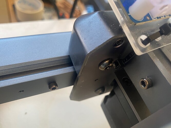

Hello, I have new laser Ortur Laser Master 3 20W. It is my second laser, I have already 10W, which works completely fine. Now I assembled this new laser and have problem with laser moving. My problem is quite described here: Laser head hits sides and corners at times
Homing is fine, problem is hitting the sides when manually controlling and hitting when I frame something on the edge of the laser.
Bed size is correct: 400x380mm
I tried plugged and unplugged all the wires.
My lightburn license recently expired. Could it be a problem?

When I move the old laser out of bounds it beeps and Alarm 2 appears. But this new one is trying to move further through the frame. As if the new laser doesn’t know where its limits are.
Do a homing cycle and check which position is reported in the move window when you click on the get position button. Next, make sure that $20=1 and $21=1 in firmware settings and the values of $130 and $131 reflect the actual workspace size (be aware that most lasers have a slightly smaller workspace than advertised, you can measure it using the move buttons which is the farthest position it can go without hitting the frame. Or, just subtract 10mm of the advertised distance).
Thank you, I appreciate your help. After homing the coordinates are 0. I checked $20=1, $21=1, that was ok. Then I checked $131 and there was diffrence between the actual size. I edited it, but still no change.

the 20w laser module is bigger than the 10w.
did you mount the screw correctly along the Y tracks so that when it homes the laser module doesn’t hit the frame?

Thank you. I made a video, but I don´t know where i can upload it.
I tried to enable only soft limits, then only hard limits, then both, but nothing happend.
I wrote to Ortur, but they replied I should only restore the settings.
I think it must be something simple that i’m missing.
Yes, I got that right.
Depends on how many switched there are on each axis. If only one per axis you can only do homing and need to be aware of travel limits yourself.
