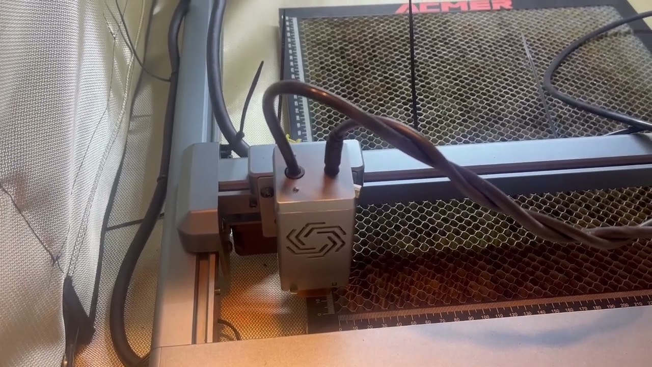

Laser head hitting the sides

There is the video of my problem.
Not sure why you are moving it into the rails here.
Why are you starting so close to the rail and trying to frame it to the right? If you want to work in that area you should set your job origin to lower right instead of lower left.
I don’t want to start job here. It’s just an example of the laser head hitting the sides. It shouldn’t happen. This should trigger Alarm 2 and prevent further movement.
But you do. You move it into the rails and then tell it to frame. That’s you that drives the laser into the frame.
Which position is displayed in the move window? I can’t see it in the video, the resolution is too low.
It hits the sides on the left side, up and down. This right sight was an example.
The position on the first video is X: 400 and Y: 0.
There is video of my old laser. It stops when i try to move it into the rails.

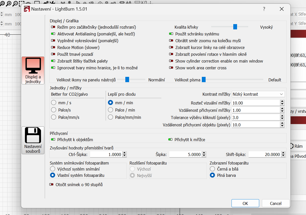

Now let’s gather some machine info. You posted machine settings screens, but let’s try a different way. In console type $$ and hit enter key. Copy and paste the entire output here.
Post a screenshot of your Settings screen as well as your Device Settings screen. Post screenshots of your device list with each of your machines selected, one screenshot for each selection.
In a separate reply, post the Console output and requested screenshots when connected to your working machine for comparison.
