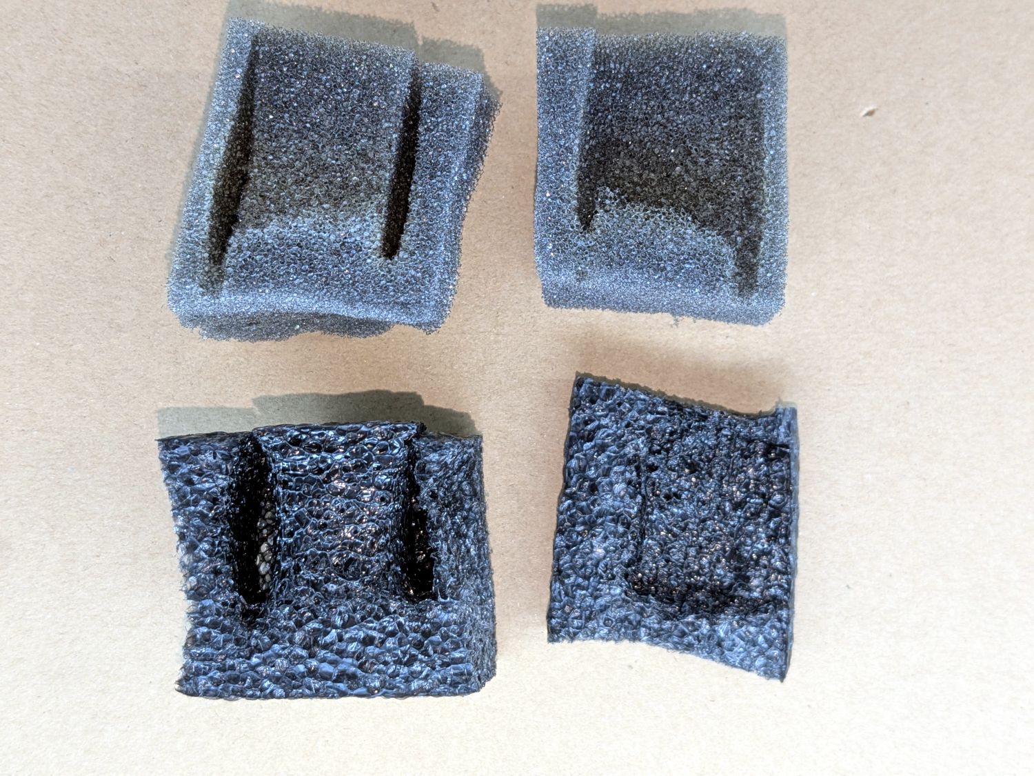

Because there’s nothing like a good new problem to take one’s mind off all one’s old problems, these are slabs from the Box o’ Foam Stuff, about 1.5 inches thick. The cuts were simple squares run at 50% of 60 W at 25 mm/s:
None of the cuts went cleanly through the foam, so I cut through the bottom with scissors to reveal the kerf between the left and right halves. The left halves show the kerfs end-on.
IMO, a laser is not the right cutter for foam packaging around anything spendy enough justify the foam.
