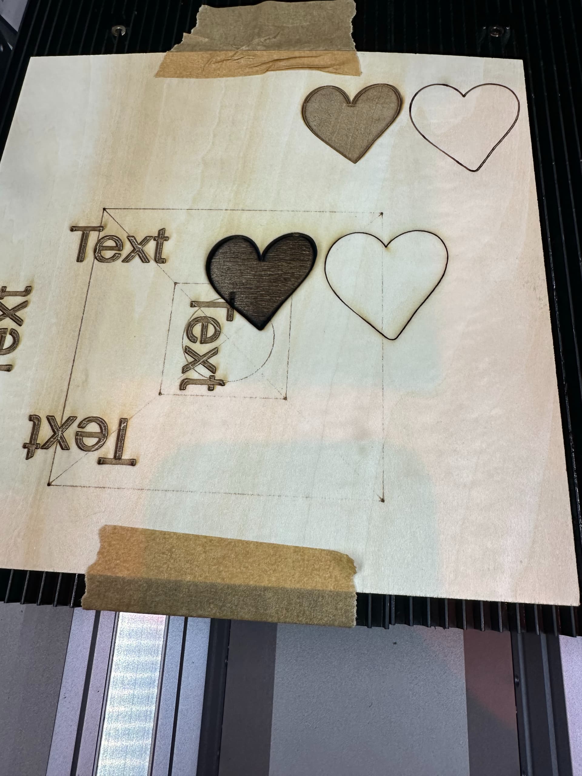

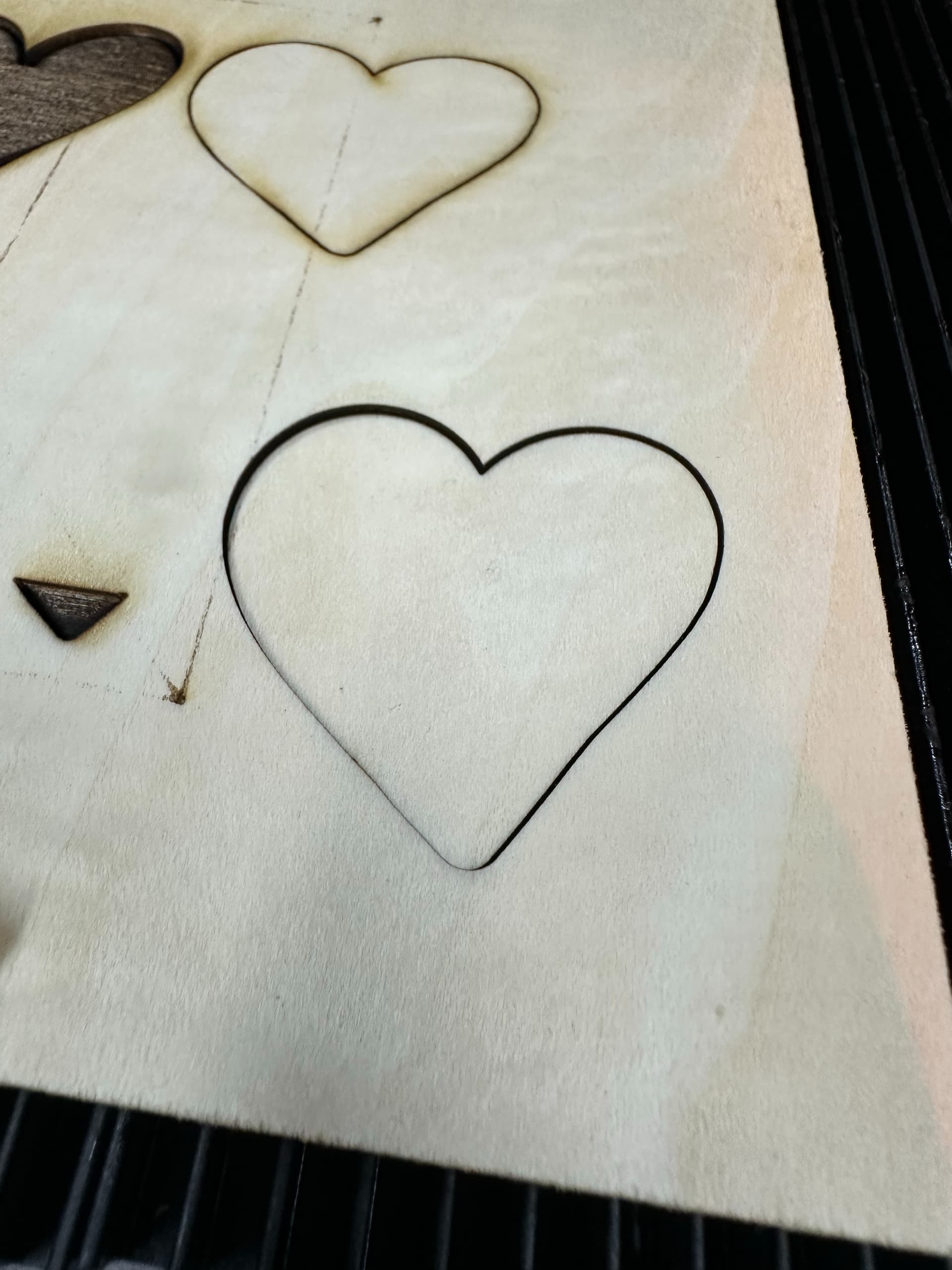

So I changed the profile of the machine in Lightburn and reduced the speed of the engrave. The Cut line is still jumping over the right and it’s still doing some really weird stuff with the boundary.
I decided to try another test which was to run the cut line separately. Again it ran a super weird tiny boundary but it did cut through with the slower speed.
Pic and vid, files attached

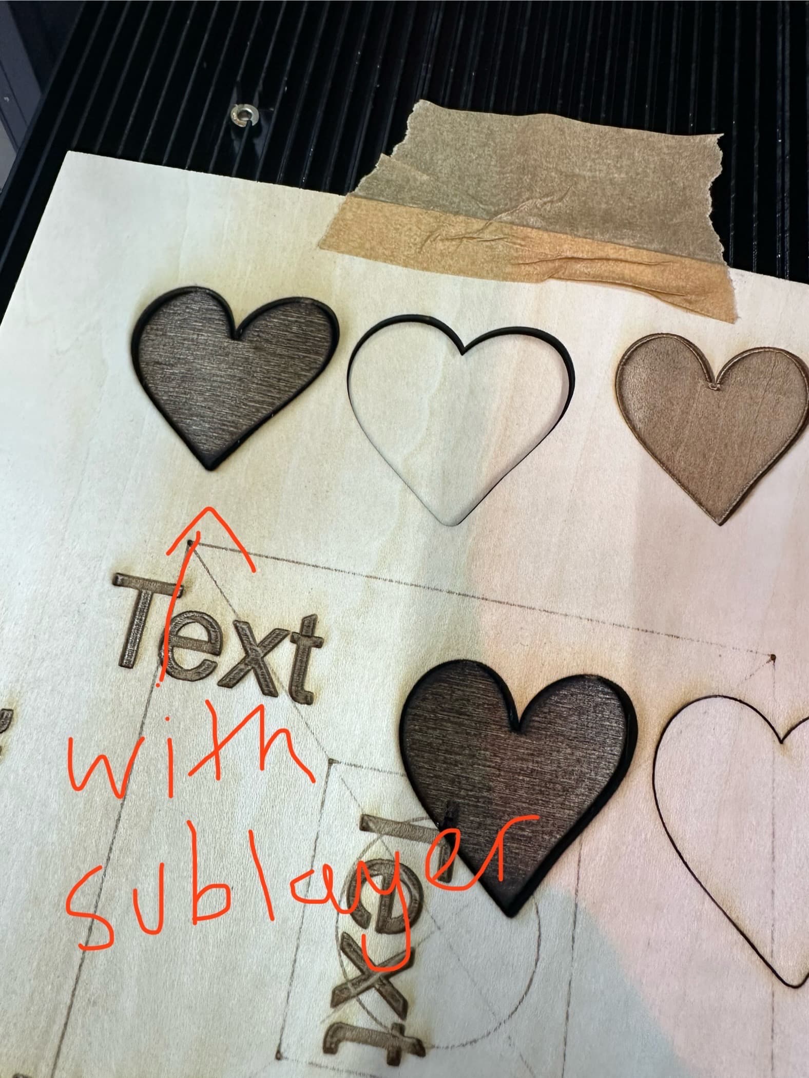

So the latest, hm… While it doesn’t really solve the actual problem at hand, try using a sub-layer of the same with a kerf offset. I’ve modified the heart 4 test to match what it was but using sub layers instead, see how it works.
heart 4 test.lbrn2 (37.2 KB)
Hi @Skreelink so I tried it with the sublayer and it produced the same result. What about some sort of hard reset on the machine? It seems really weird to me that people have had success with settings they’ve shared but my machine is producing something different.

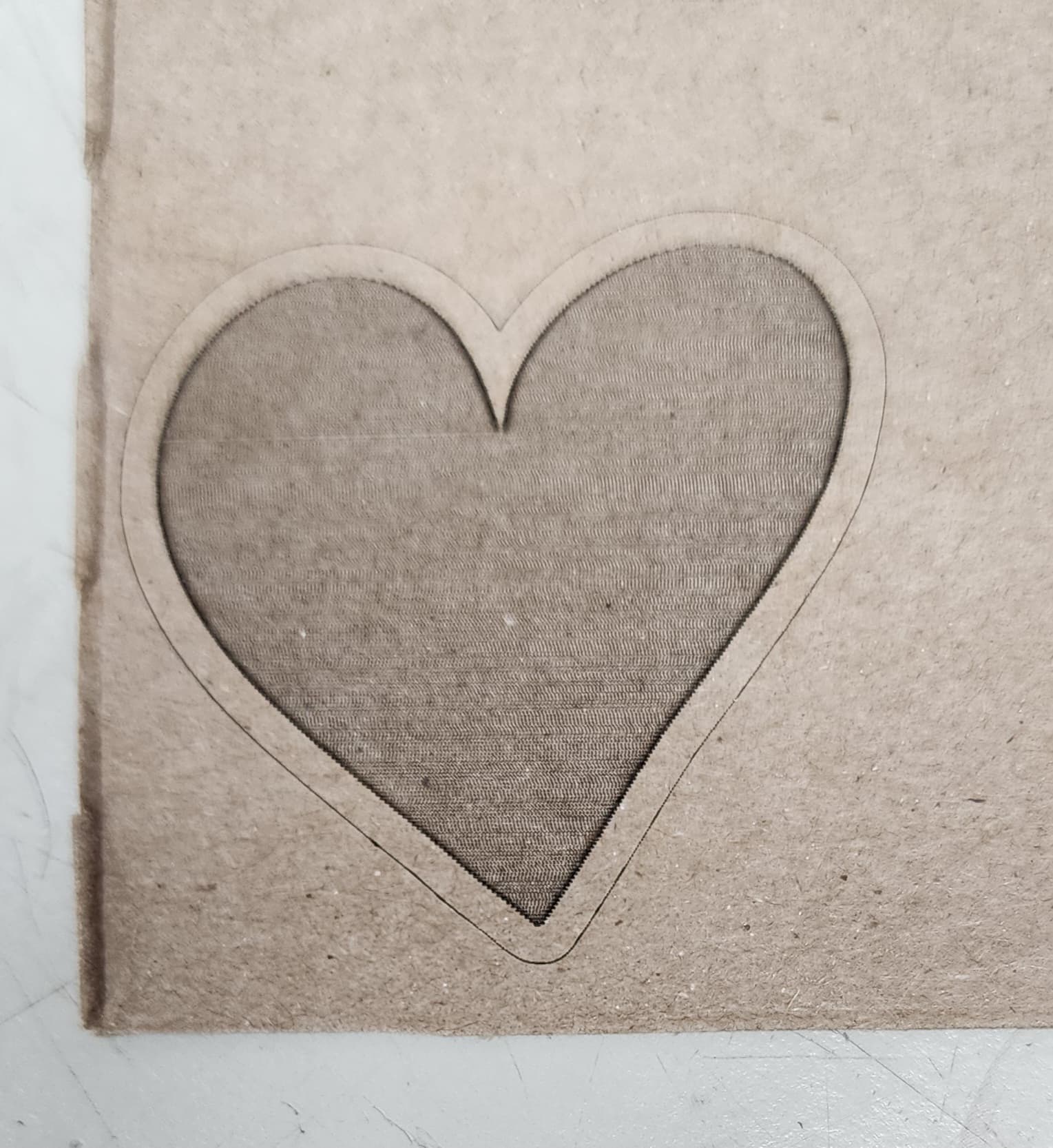

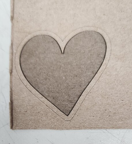

I downloaded your original Lightburn file (the one with the high speeds), and ran it at 2000mm/min and 40% fill, 60% line on cereal box cardboard with the 1.6W laser and it came out fine. Although I probably should have tweaked the overscan to 2.5% to reduce the dark edge around the inner heart, but I wanted to use your file as intact as possible.
FWIW.
