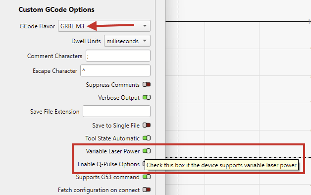

In 2.1 still constant power mode cannot be used with Custom GCode controller. Generated GCode is always with M4 instead of M3, toggle Constant Power Mode at layer settings is ignored. Is this intentional, can it be solved?
Here is example with simple line with sublayers, one with dynamic power and one with constant power. Using GRBL controller produced GCode is OK, but with Custom GCode M3 is not used.
CustomGCode.gc (357 Bytes)
GRBL.gc (401 Bytes)
TEST.lbrn2 (3.1 KB)
To use M3, change the GCode Flavor to GRBL M3 and enable “Variable Laser Power” in the Device Settings:
Which of the three lasers are you setting up here, and is GRBL M3 what the manufacturer suggests to use?
This docs page might be relevant:
Grbl M3 always uses M3 so dynamic power (M4) cannot be used even if Variable Laser Power is enabled, with same file, using Custom GCode with GRBL M3 and variable laser power enabled this is output:

I’im using Algolaser Delta, which has grblHAL based firmware and trying to use custom commands for Air Off and Air On which cannot be used on standard GRBL controller, and Custom GCode is missing constant power for it and also GCode clustering. Also GCode clustering cannot be used with Custom GCode.. Some info about that is in my old post https://forum.lightburnsoftware.com/t/looking-for-recommendations-for-a-new-laser-frame/132980/10?u=ztomic
Joke’s on me, that’s correct.
The “GRBL” device profile and the “GRBL” flavor default to using M4. The “Constant Power Mode” in the Cut settings can be used to override this and use M3 instead.
Do you mind explaining why you would want to use M3 in the first place?
Then, the grblHAL GCode Flavor will provide a better starting point.
It also defaults to M4 for the “Tool On” command.
We are aware of this, and it’s on the list. I’ll try to move it along.
For some precise cuts and engravings I must lower accelerations to 300 to compensate mechanic issues (when using whole area at X axis engravings are shrinked on left and right side so distance between cut and engraving is not constant like in the middle of working area and it is too visible on small items. I have tried already all what I can, overtightening X axis belt, playing with roller tensions and nothing helps except low acceleration), and due to low accelerations on corners or starting points for some speed/power combinations there is no laser output on material so for that cases I use constant power at layer.
I used that for custom gcode, generated GCode using that is attached to my post above

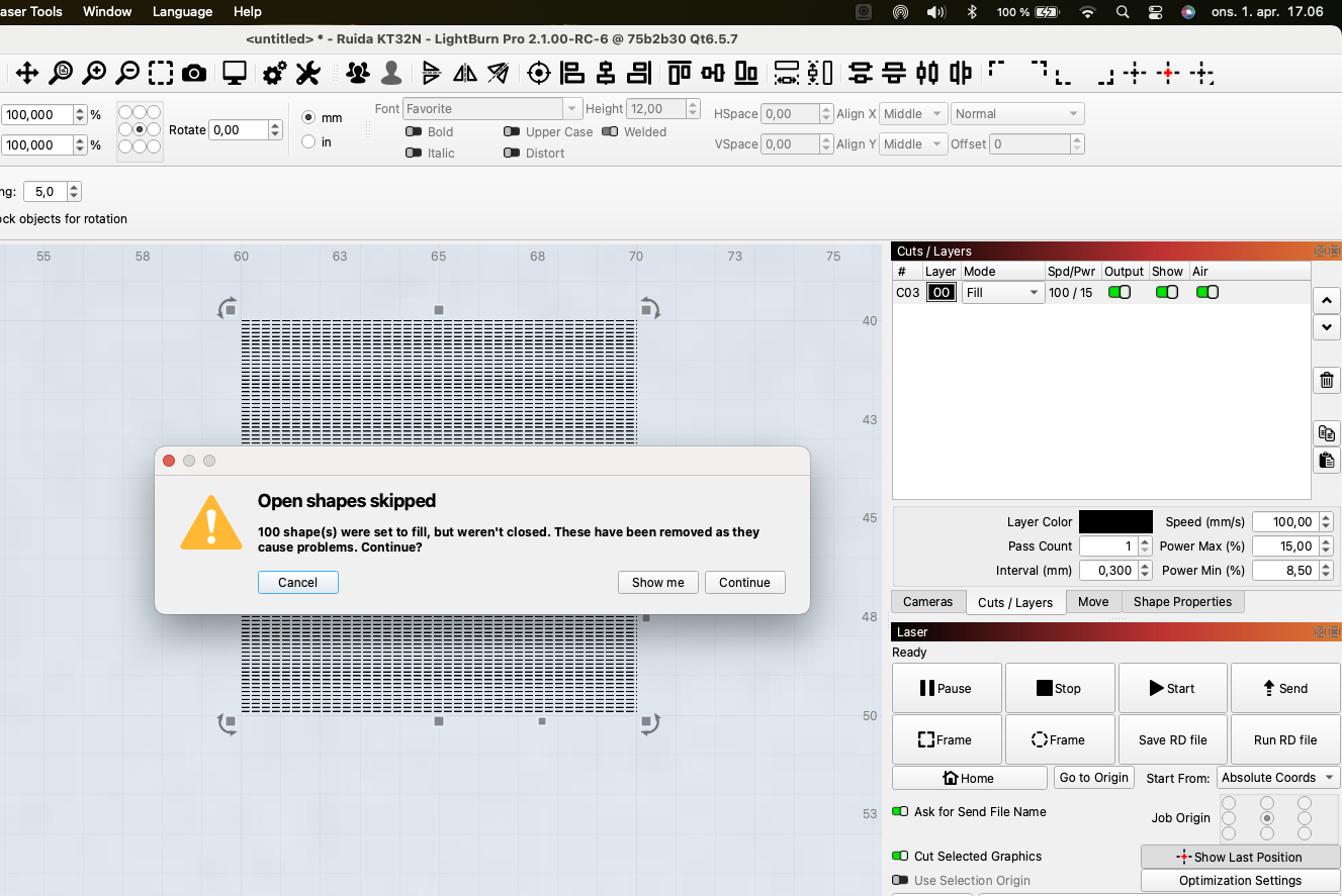

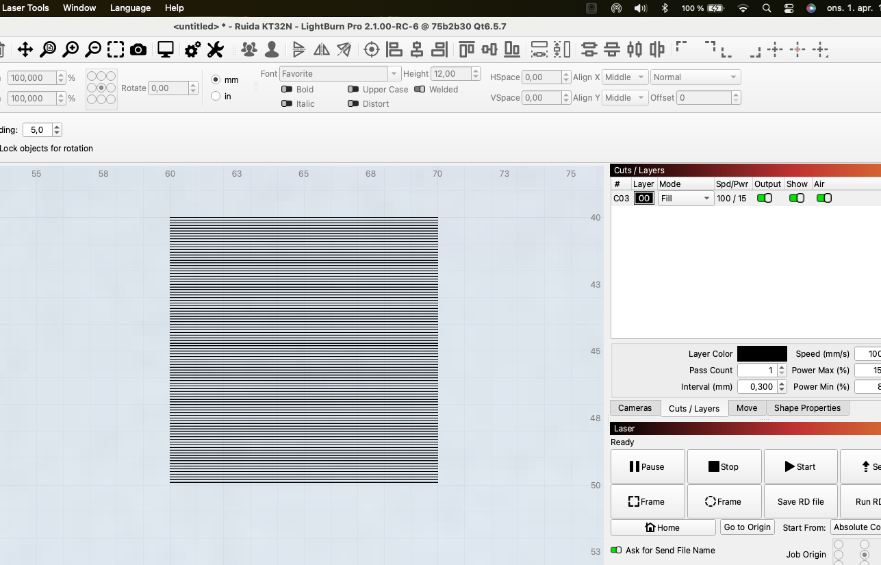

RC6 crashes due to a simple “misoperation”.
100 lines 10mm long, but set to fill and not to line…
An “error” is pointed out but by continuing anyway, LB crashes. This can be repeated.

Fixed for the next update, thank you.
