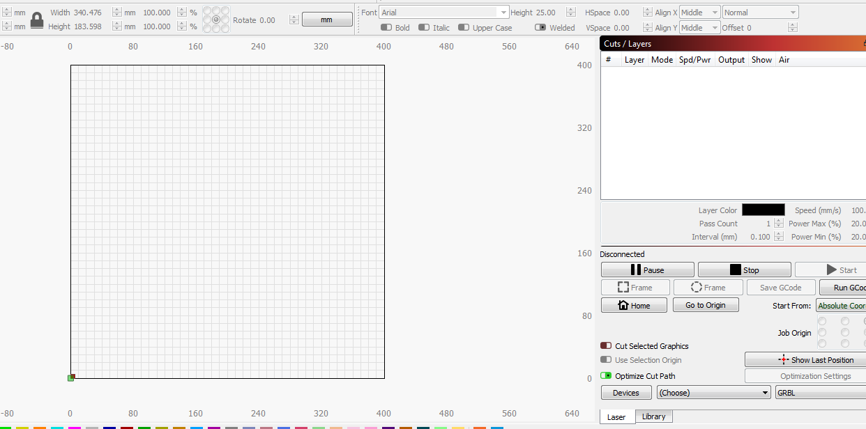

Lightburn will not find my Ortur Laser
I’m guessing “Cancel” just immediately quits Lightburn…

@berainlb the OP can not get to that menu because the OP gets sent directly to the “Setup device” dialog( see picture the OP posted ) and both options( Cancel nor Go Back ) results in exiting from Lightburn… Hacking the prefs.ini might fake Lightburn into starting but why bother when the OP NEEDS to get the device setup in the OS to use Lightburn?
The second screenshot looks like @JLO1 clicked on “Find My Laser” to get the that screenshot. This doesn’t seem to be an issue with LightBurn creating an impossible situation but I’m sure OP will let use know.

I believe you have that incorrect and the OP posted the first shot which states you either hit YES or you exit. The 2nd screen shot is a result of clicking on the YES button.

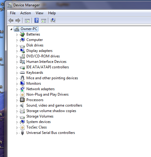

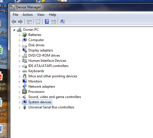

Ok Guys, Here is the latest: The Manual load is done and I am sending a screen shot that shows the port path can not be chosen (nothing their to chose) I checked and the driver software did install on my machine but I don’t know anymore than the laser is still dead to this laptop
can you show us also the device manager on your windows 7 once you connect your laser?
cause if there is no port to choose will means that there are no drivers installed or are not installed properly

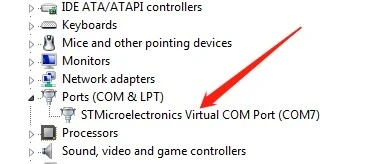

You are looking specifically for Ports. Should look something like this:
You may need to turn on View->Show hidden devices if you’re not currently connected.
Specifically, if you do not see any ports defined it’s likely that you don’t have the driver installed properly.

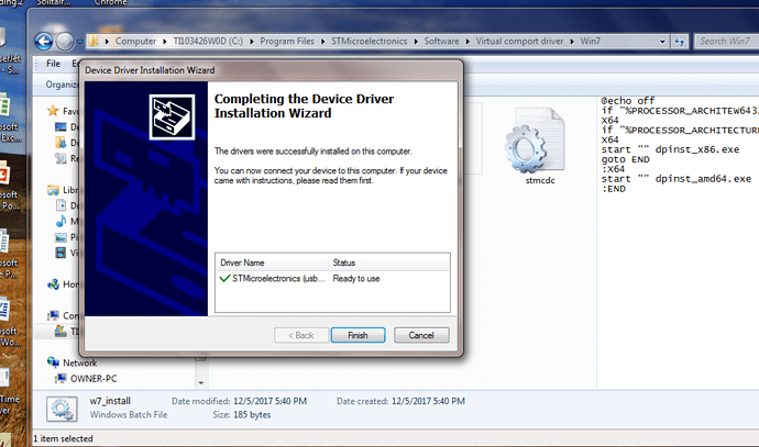

Go back to Ortur website and download the STM Micro v1.5 driver that matches your installation (32-bit or 64-bit). Complete the installation and attempt to reconnect.
Ok Round ? What round is it anyway? I checked the device info and tried to get the laser to connect by no go. I also check the STM Driver and as you can see from my screen shot it is on my machine.
My Device manager does not show ports

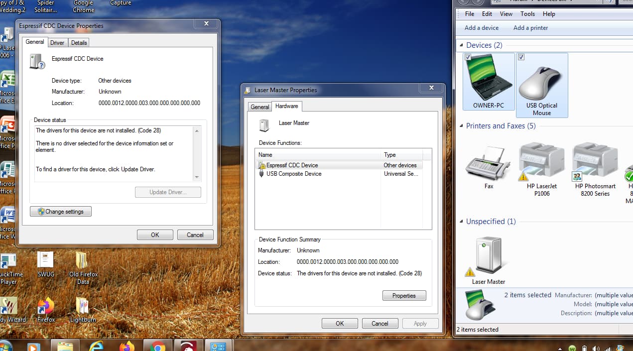

As for the screenshots you’re showing, I’m curious what those are. Is the Laser Master actually the Ortur that you’re connecting? If so, not sure why or how it’s showing up there. The Espressive CDC Device I don’t believe is the Ortur. That’s associated with ESP32 devices. Do you have some other device configured that might be interfering?
In device manager, have you enabled (Show hidden devices)?

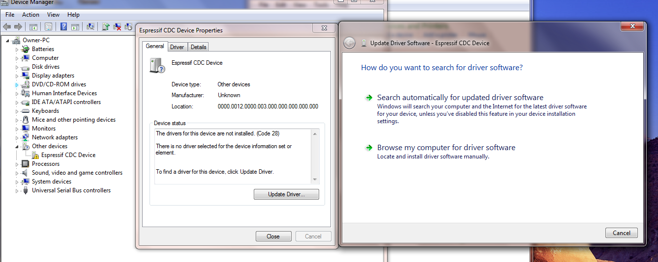

Every time I try something new, I plug in and turn on the laser. More info and picks. The port does show up when plug in, the device manger pic is attached, It says it has no drivers and it went online and tried to find a fix and did not.

Question 9 - I just enabled hidden devices - Revealing!

I suspect it’s the Espressif CDC that’s causing the issue. Unless Ortur has changed the chipset that they use on the Pro. Maybe some Pro users can pitch in here but nothing in the documentation seems to indicate this.
Are you able to completely remove the Espressif CDC driver?
One additional thought, can you check device manager from your son’s computer to confirm how the laser appears there?
So this has been bugging me so after running another post about Ortur connectivity issues I wanted to see what else I could find.
I found a random product description page about 1.8 series Ortur Laser Master 2 Pro S2 that it can support ESP32 MCUs.
Ortur Laser 1.8 firmware, qualified for ESP32 MCU, optimizes the motion algorithm, and increases the maximum stepper motors speed from 4000mm/min to 10000mm/mm
I don’t know if this means that Ortur has changed MCU in these units or if both MCUs are present in the MB. But It’s likely this is the cause of the connectivity issues since @JLO1 has been installing the STM driver. I don’t see anything in publicly available Ortur documentation that describes this.
@JLO1, did your laser come with a disc or a link to download additional software? If so, it’s possible the driver was included there.
Alternatively, there are a couple of widely used USB chips that are coupled with ESP32 but it’s not clear which one you would need. Can you check the “Details” tab of the device properties on the Espressif CDC? Or check on your son’s computer if that is available.
