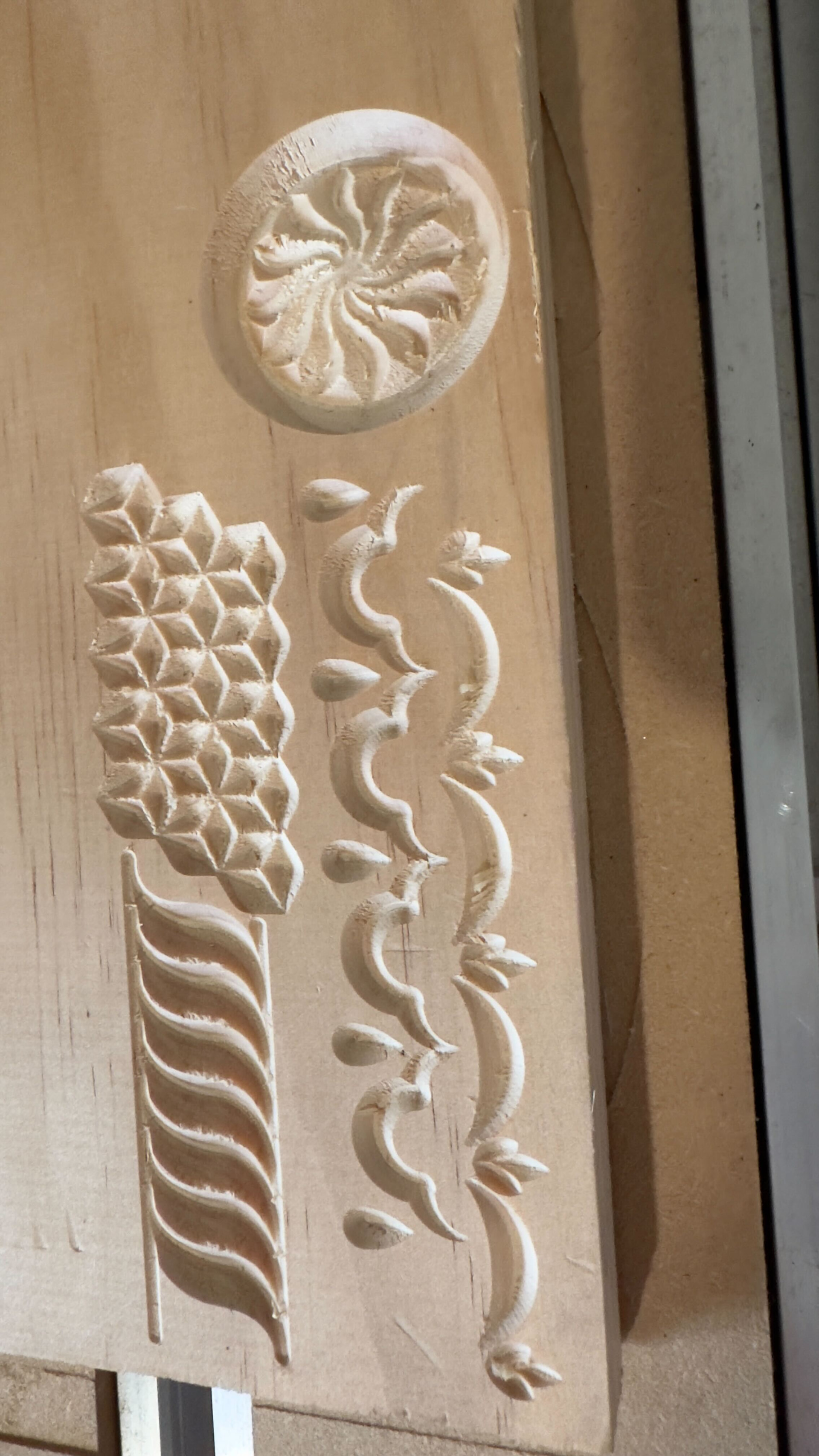

Fluting is running the bit along a line with varying depth. It can produce similar results to V-carving in certain cases, but they work differently.
V-carving keeps the bit between two edges, and varies the depth based on the distance between those edges. Fluting just follows a line and varies the depth based on a depth curve type you choose - Ramped, curved, etc.
All of these shapes were made just with the Fluting toolpath:

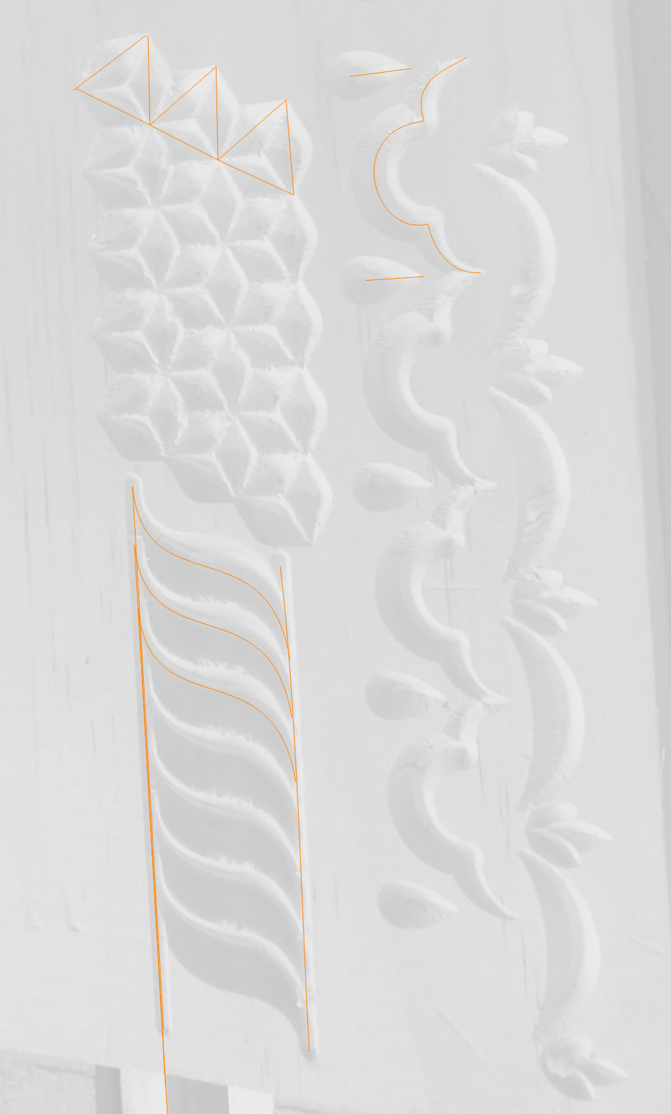

And to give a better idea of how some of those shapes were created:

Thanks Oz, So taking from your description and the documentation page, the ramps (entry and exit) are definable by type (linear, fall, arc, ogee, and smooth) with the flat representing the maximum depth of cut region. Depth of cut being definable by either direct entry OR derived from the max cut width. Is that correct? If so, that’s really COOL, and very close to to what I was imagining!
I’m excited at the chance to give it a try soon.
Yeah, the summary sounds accurate - You can do some really cool decorative stuff with simple lines and some interesting tools.
