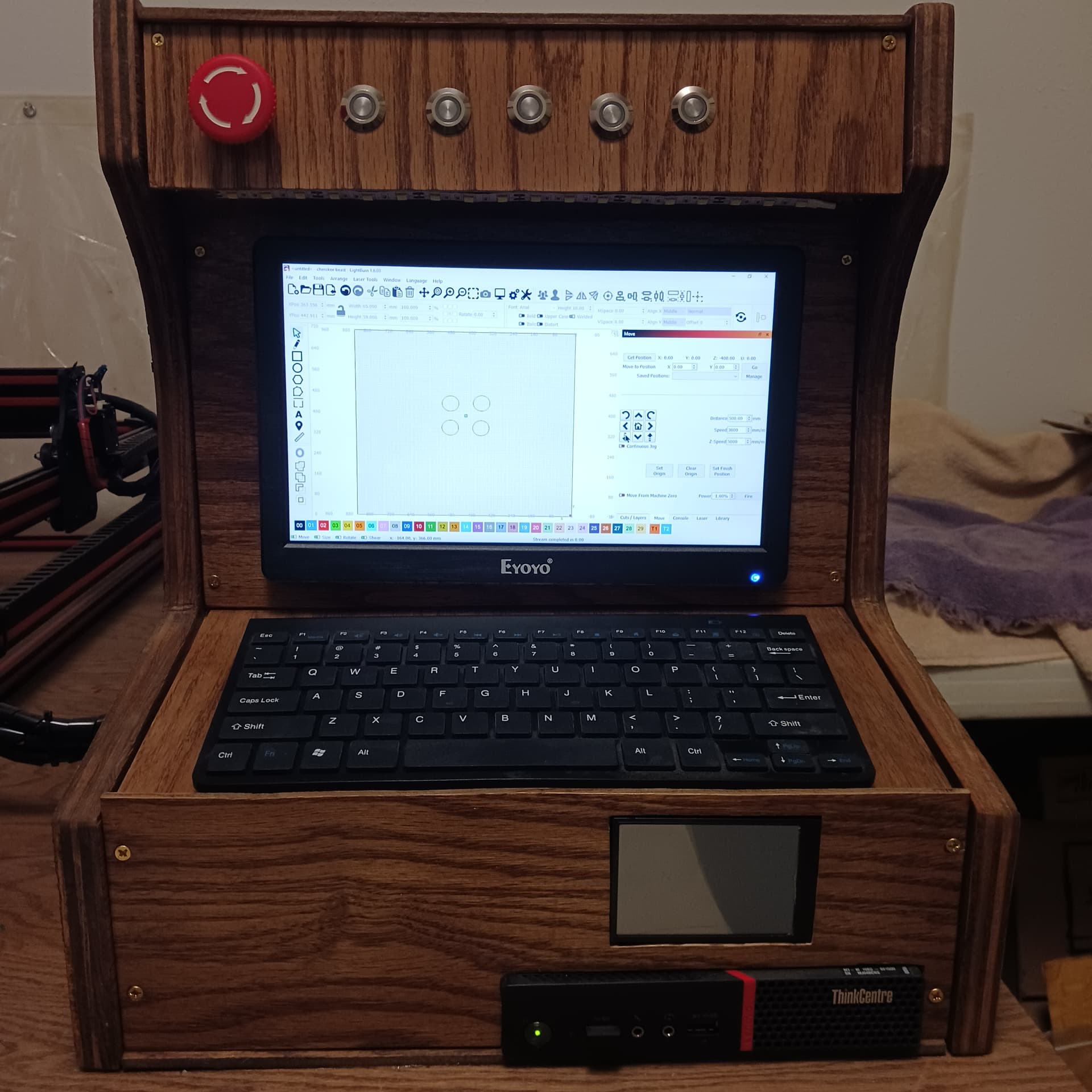

had to!! I plugged straight into usb with LB and it worked fine. best focal point was at 2" for me. Here’s my problem, with only a 12" monitor the image on my screen in LB was only about 1/2" sq. That’s a problem ! My win 10 has a camera program already in it, I never knew that until I plugged in my endoscope. I get a full screen image. So I just click back and forth from LB to camera. Works fine for me. This pic is my console with the 12 monitor. The move control window is only 3/4" sq.

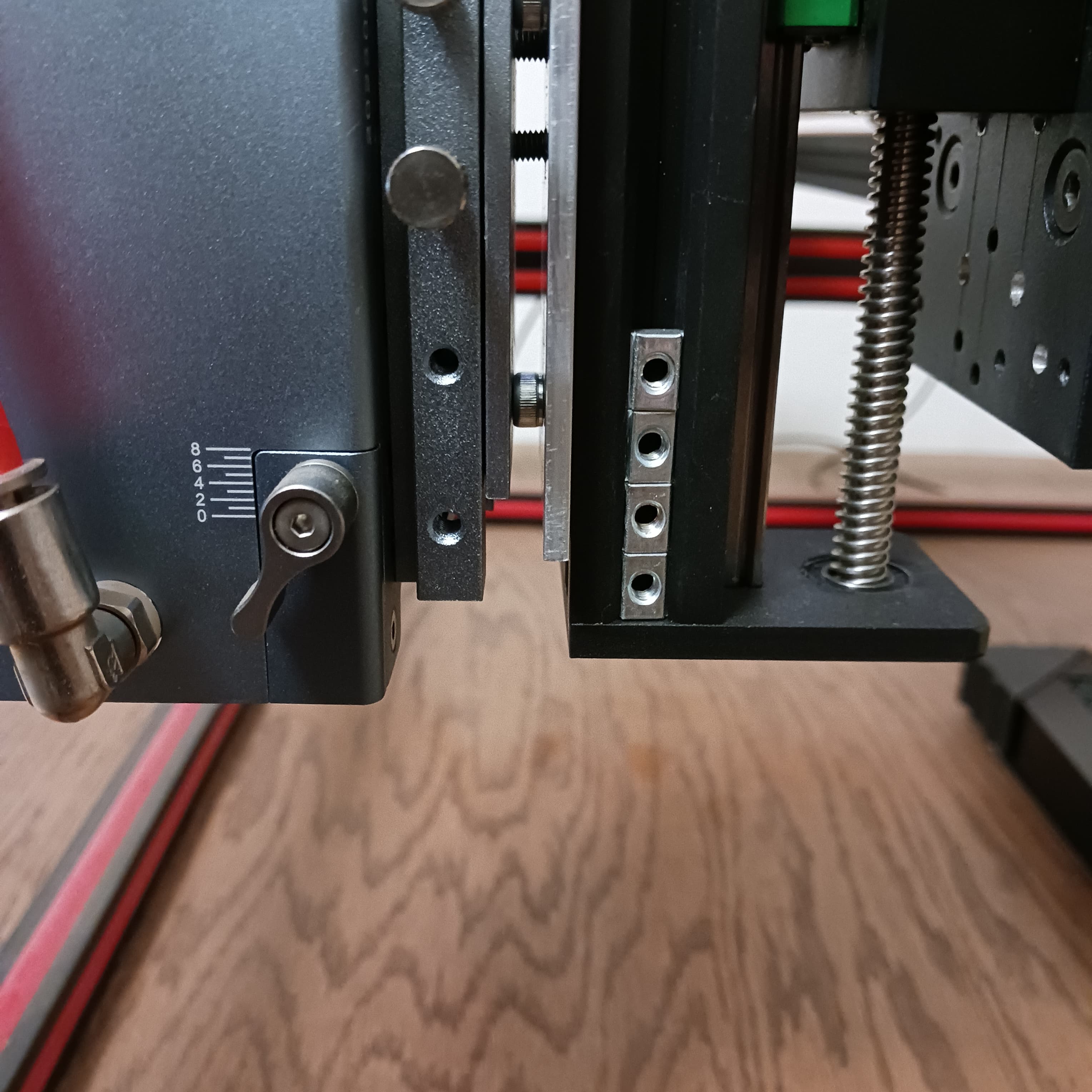

And this one is where I’m going to mount my camera.
Those 4 T nuts came installed in my actuator.
So I’m going to get a piece of alum. channel 1/2" wide by 3/4" tall. I’ll drill two holes through the back side,(1/2" w) and mount to the actuator. I’ll drill one hole in each of the two 3/4" side walls to hold the scope. It should work fine,
I hope !

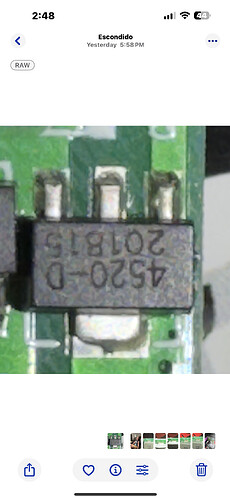

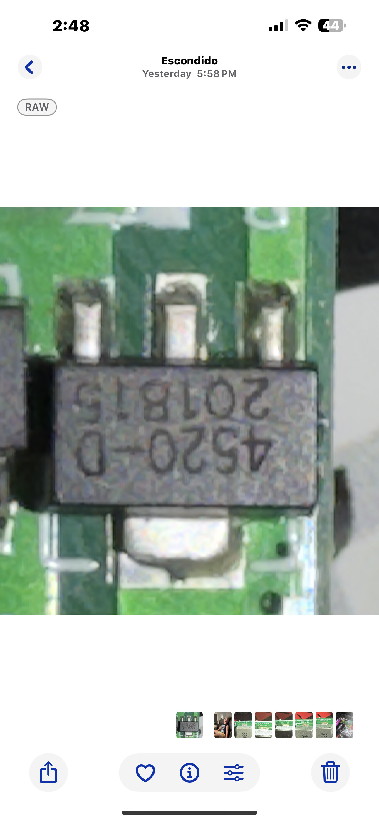

Hey Randy I was sending u a message cause I seen that u have a Zeus laser also. I have the Zeus x 7w and I fried a part was wondering if u might be able to help me identify what the part is so I could order a new one thank u
Processing: IMG_2054.png…
Hello Bryon: What you are looking at, (in your pic) is a “mosfet n-channel” power switching transistor. Used for PWM applications, power management and load switching. I don’t see anything wrong with your transistor. No burn signs, no cracks, little chunks or holes blow out of it. Most of the time you can spot the bad components and sometimes you can’t. A diode laser does not put out a solid beam like a flashlight. That diode turns off and on thousands of times per second. The hotter you run the power the longer the diode stays on per flash. So you might have a timing ic-chip or something else gone bad.
Power is not temperature but rather a measurement of time. So just going by what I see in your pic tells me something else “may” be wrong. And yes I have had many power transistors gone bad with no external signs of damage.

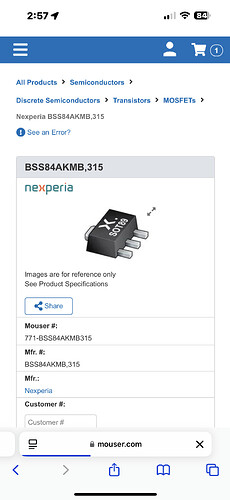

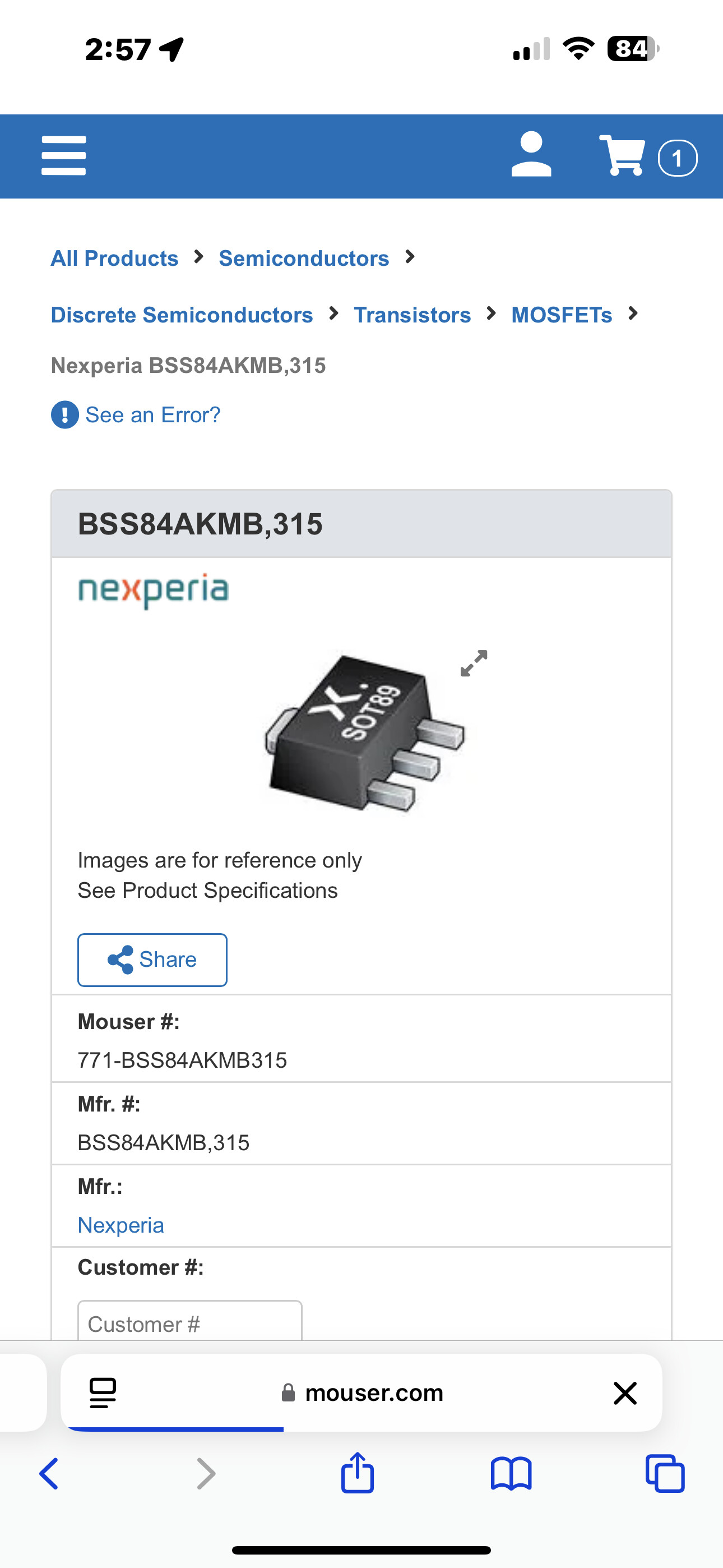

I’m just seeing your message now and I ordered a part from nexperia :persevere: do u think by using this one it will still work? At least to fix this part of it if nothing else.
Thank’s for the edge finishing idea’s randy. No luck finding the diode video…but I’ll find it.
I literally only turned it on for maybe 3 seconds max and after seeing that it wasn’t turning on I opened it up to take out the batteries and smelt something burnt… I know that’s probably all it would take to burn something out. lol but also I noticed that there was a lot of play in the battery compartment enough to be able to shake it and hear them jiggling around. Is there any possibility that could have shorted or burned something out by any chance?also when I opened it up to check the pcb I noticed that the black wire next to the mosfet that burned out came undone so I had to solder it back together. I’m not sure if when I unscrewed it tho if that might have made the wire come loose or if that could be the issue and if so do u know what else that issue could have damaged in the process of it frying that mosfet? Again I really appreciate u taking the time to help me out with this man
