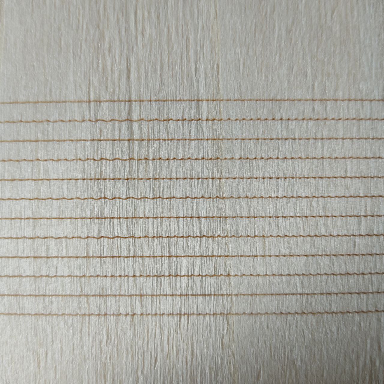

@killrob, here are the lines, 300mm/s
btw, I notice here some swinging of the mirrorholder. I need to improve that.
is what i thought, is a mechanical problem no interference
I´m not 100% sure about that. If you look closely at the lines, the look mostly inconsistant. The horizontal rows in the rectangle look 99% regular.

So I was finally able to do more tests.
First I made scan operations at 90° and got this…
So this looks a lot better ! :slight_smile: It seems the pattern is only made by the x axis.
In the next step I made again 0° engraving with line interval set to 1 mm and got this…
That surprised me a lot! After that engraving I turned the laser off and made some 300 mm/s moves. The Stepper is vibrating like a love toy… :face_with_hand_over_mouth: Interestingly, I didn’t hear that. The faster the stepper, the greater the vibration, so this explains the greater distance in the pattern at 300 mm/s.

The y-stepper also rattles. While the stepper is installed you can´t hear anything. Smooth movements. But when I disassemble the motor and hold it in my hand it clearly vibrates. The reason for the visibility on the x-Axis is probably the longer belt (600mm).The rattling + the resonance from the belt leads to this pattern. But this rattling is still not normal.
I think it is unlikely that the 2nd skr board is broken. So maybe the drivers are the problem? I have tested the 2208 and 2209 drivers, and the Vref ist ~0.7 on both. This should be ok, for Nema 17 steppers, I think.
All steppers vibrate so can’t tell from your description if this is some sort of unusual vibration. If so, then most likely a driver configuration or compatibility issue.
Do engravings come out dimensionally accurate? So 100 mm in design results in 100 mm in the burn?
However, I suspect you may be able to work around the vibration issues if you can sort out the mechanical issues on your X.

By accident I dropped the laser diode head of my Sculpfun S9 on the floor. Thereafter it exhibited the pattern described above. Close examination under a high power magnifier showed that the head was vibrating in the Y direction. To test this I mounted the head rotated horizontally by 90 deg. Now the pattern showed vibration in the X direction. Yes, it was a mechanical problem in the laser diode head.
Desperate for a solution, since I could not wait for the replacement diode head from China, I tried my hand at repair. I carefully dismantled the laser diode head. I found that the grub screw which secured the laser barrel assembly in the bore of the heatsink was missing. I reassembled it, making sure the lenses were tightly secured, re-focussed the unit and put in a grub screw to secure the laser barrel in the heatsink bore.
That did it, the problem was eliminated and the laser diode worked properly, like new. In the mean time my replacement diode head arrived from China(at prohibitive shipping costs), making me the happy owner of two laser diode heads!
If my experience is anything to go by, mechanical problems are a likely cause.
