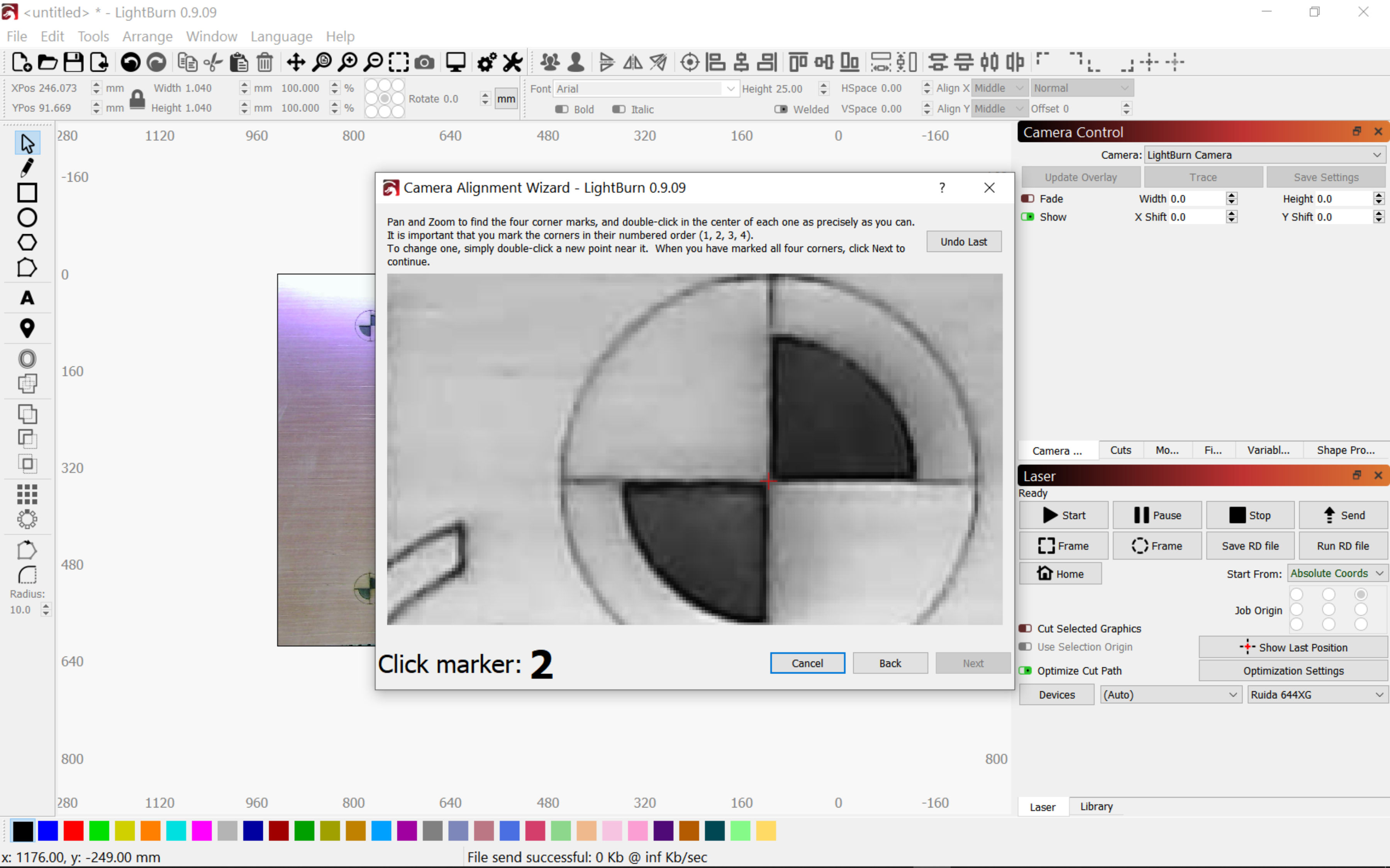

I redid the alignment part at 240. This is what I get when I zoom in.
I haven’t lowered the camera yet. I will try that next.
I will let you know what happens. Thank you for the help!

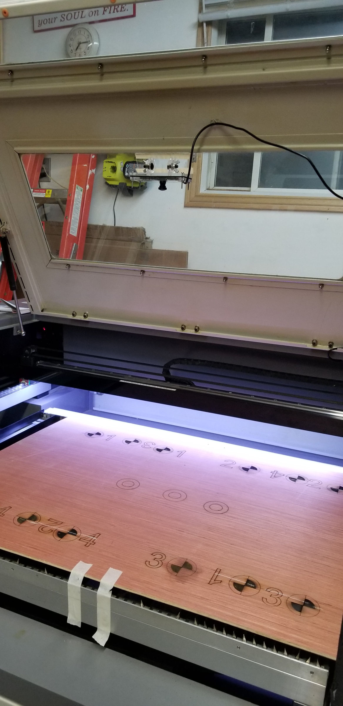

I lowered the camera to the suggested 450mm but to center it to the bed I would have to have the door almost closed - I tried but could not get the whole bed into the image. So now I have it mounted at 640mm (bed (at proper focal distance to beam) to lens face) and I can see the whole bed properly.

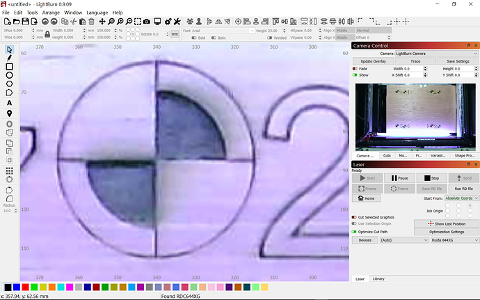

The focus is still not very good. This is the best I can get while doing the alignment - maximum zoom.

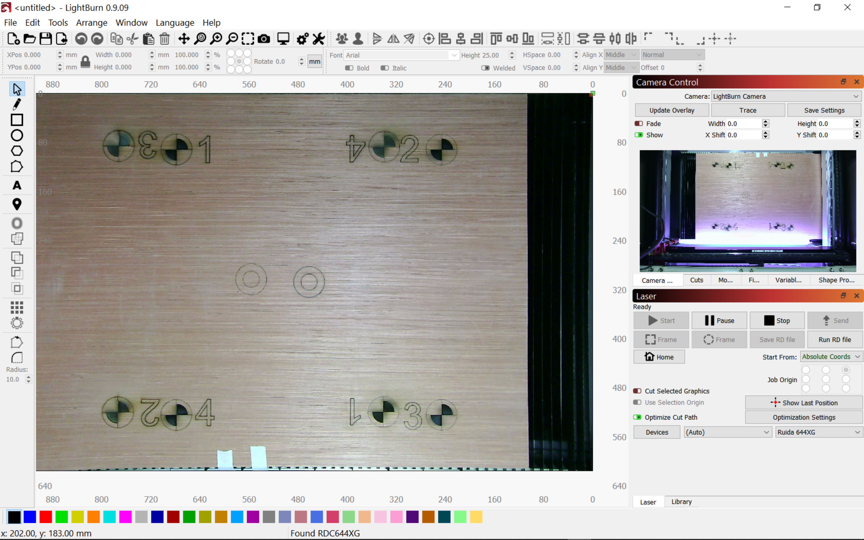

And how it looks with the overlay -
and how it looks when I zoom in on the overlay -
not very clear. And after I do the alignment it is still off by 1-2 mm on both x and y axis on at least 3 of the marks. But maybe this is because of the bad focus? I have tweaked the focus on the lens by very small increments until I got the best I could. But I had really hoped it would be better than this. Not sure what todo about the alignment at this point. I have to give up for today - been at this for 10 hours just today and don’t feel I am any further ahead. Should I have got the 95mp camera? would that have made a difference? Thanks for all your help. Just feeling pretty frustrated.
Also - my numbers when doing the lens calibration are .09 to .23 at different parts of the bed. Even using the larger dots. Not horrible but I would have thought they would be more consistent. I have done this calibration so many times I will be doing it in my sleep I am sure.
The placement we can work ok, but this focus is actually very good - Remember, that marker is about 50mm across. You don’t need the picture to be “pretty” for it to be really accurate for work placement, so don’t get too hung up on that.
I would say check the lid on the laser and see how much it moves when it’s raised. If it has any flex or sway in it, that can cause misalignment with the camera - The camera is looking straight down - if the lid moves 1mm in either direction, the camera alignment will be off by that much, so check that.

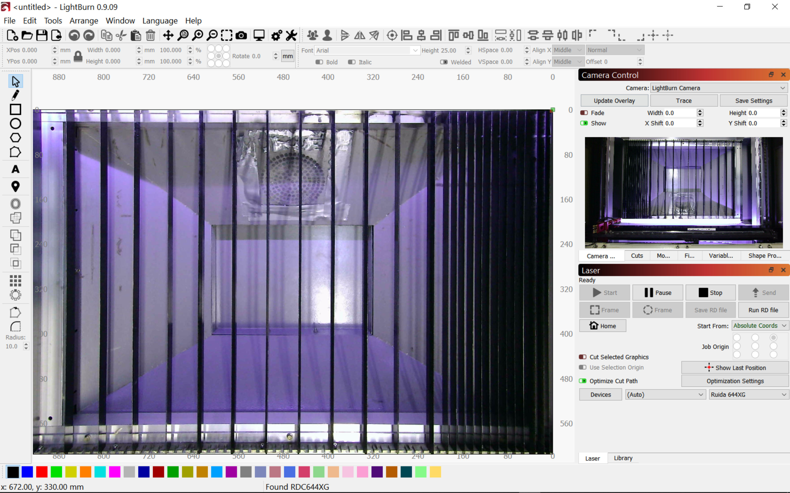

I am having issues with my camera view not centering in the workspace. I bought The LB 8mp camera and mounted it 43.25 inches above the bed. I spent the better part of 20 hours getting the camera calibrated and getting the image to burn and calibrate. Many of the prompts are confusing at best or I cannot implement them because the options do not exist. Like setting to “absolute coordinates” which does not exist in my drop down. What I need help with now is the if I update the camera overlay it only shows part of the camera view. When I did the camera calibration I could only burn the target in the upper right corner (my origin) now the image in the camera is only part of my bed.
Any ideas on how to get it centered ?
Laser is Boss HP 3655. downloaded LB ver 0.9.09
