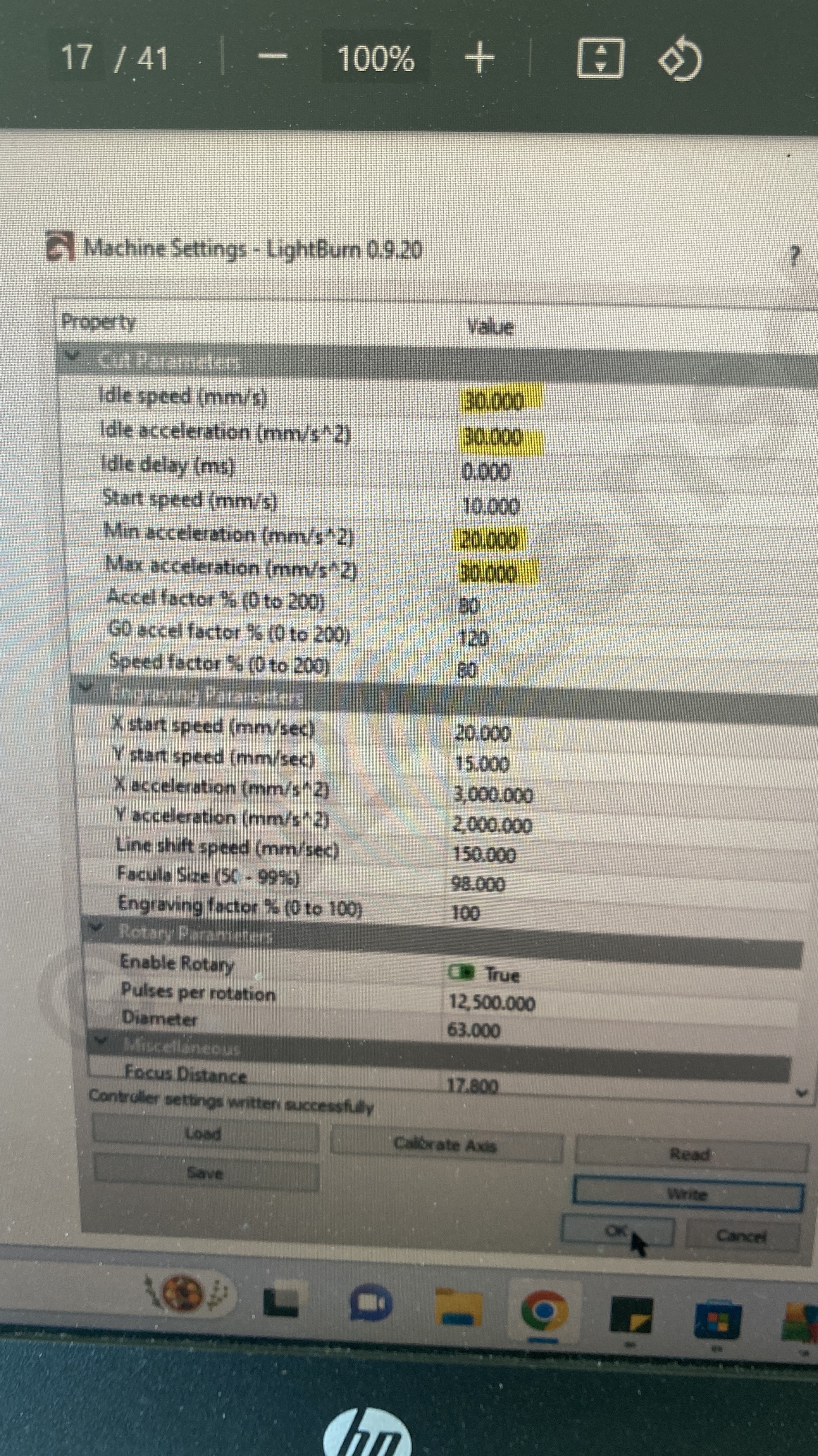

I install my piburn 4.0
Change the machine settings ( backed up the original machine settings )
Next day, I turn my pc on, blue screen of death ! And now I can’t access to the file
I am using a different laptop now
But when I loaded the settings on the new laptop, I see it is still using the 4 changes I made that was suggested by piburn , and I have no idea or remember what the old numbers weee
So when I remove the rotary, how much is that gonna affect my engravings?
How do I get the original file, anyone have it, please share it with me!

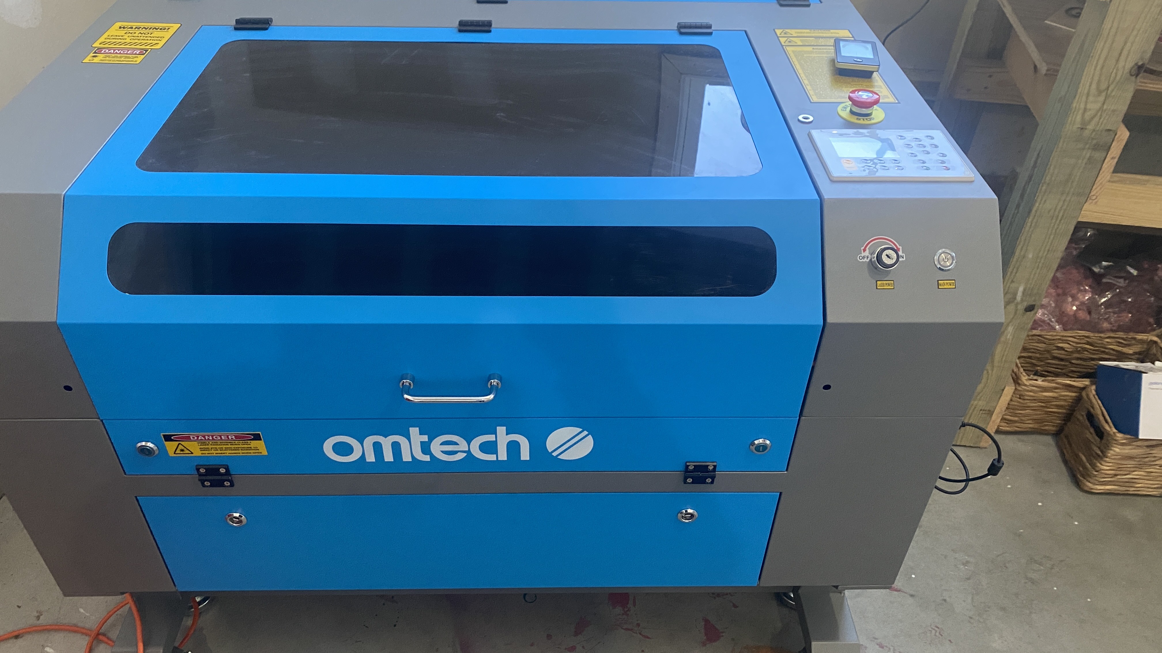

Can you show a picture of your machine?, I think there are quite a few who have this type of machine.

Can you make a screenshot of your machine settings?

I assume this is a new machine?
A 60W tube is 1200mm in length, I somehow doubt your machine is this wide… Even a 50W tube is about a meter in length…
I’m seeing a manual power control, which is worrisome to me. Seem to be popping up on a lot of new machines. Do they tell you how to use it?

Which setup file? He saved the machines configuration… didn’t he?
All he needs to do is reload it. There really isn’t anything to update on the controller unless you have modified the start speed or acceleration values, which is the only thing you might need.
The only thing you really need to setup with a roller is the steps/rotation.. so what are the other three?

…I need to borrow your glasses, I can’t find this setting option in the picture
How long is the tube in your machine?

These 4 suggested settings change by piburn,
I backed up my original settings and of course windows just fails :face_holding_back_tears:
So the highlighted ones on their website ( see photo below ) is the ones I changed
The one I saved and lost
I’m thinking all of these models have the same machine settings
So machine settings file

Try clicking on this post, there is a picture of the machine.

I have theb500 700 bed size one
