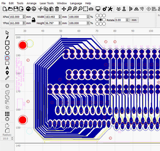

Hi, I have a problem importing PDF and SVG generated from KiCad. Unfortunately, a colleague does not want to work in Eagle, and I am trying to figure out how to import especially PDF files with a printed circuit board image (SVG and other formats also have the same problem). When the PDF file is created, it looks like this:
But as soon as I put the PDF into LightBurn, the whole image is messed up:

LightBurn does not apply Line weight for vector lines in the same way that software for graphic design does.
When controlling a laser, the line weight is a function of speed and power.
I would probably lean toward image files.

That Lightburn result is exactly what I would expect from that image. White = foil, black = etch. Look at that massive white area and ask if it should be there. Lightburn can’t fix a bad PDF.
That said, it appears @RalphU has found a solution to your problem.
