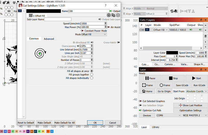

I only recently tried the ‘Preview’ on any graphics that I select within Lightburn and when ‘Play’ is pressed, the button presses but the progress bar stays at the zero mark.
The Time Slider will not move to the right or the end.
Please help!
That’s odd. The values in the duration also seem to be oddly formed.
Can you take another screenshot with the Cuts/Layers window visible?
Also, can you confirm you’re configured for the OLM2 in your profile?

How are you configured for your laser?
Can you provide the following:
  1. Can you go to Edit->Device Settings and take a screenshot?
  2. Push “Devices” button in Laser window. Then click once on the configured laser. Then take a screenshot.
At first it appears to be configured correctly for my NEJE Master 2 (Automatic settings provided by Lightburn)
As I mentioned before, that is another issue that I would like to resolve but my initial query is priority, with the Preview not working, regardless of being connected I have provided screenshots of (hopefullly!) the bits you wanted to see.
Many thanks
I don’t see anything there that would prevent the Preview from working.

Sorry for the late one but i am about to retire and I literally created a fresh graphic by tracing an image with offset fill. When Preview is pressed, the progress bar appears at the far right but nothing happens when play is pressed. If the Progress Bar is clicked and moved left and right, it does show progress of the etch/cut from beginning to end but Only by manually moving it. Play does not provide an animated view of the etch/cut

The Preview worked correctly for me. Are you absolutely certain that pushing play does not actually work? I suspect your playback speed is slow enough where it may not appear like things are moving. Try increasing the playback speed.
