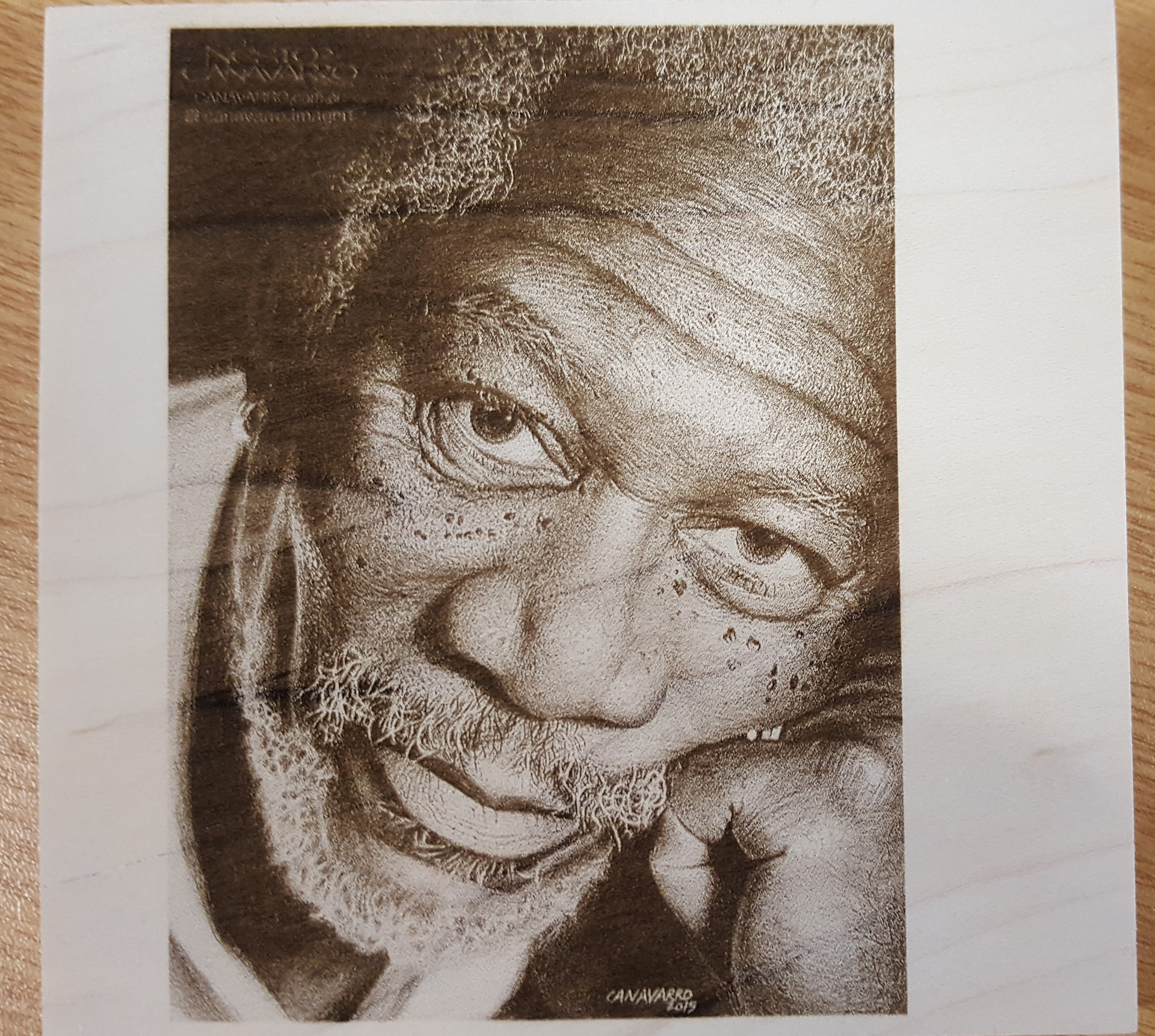

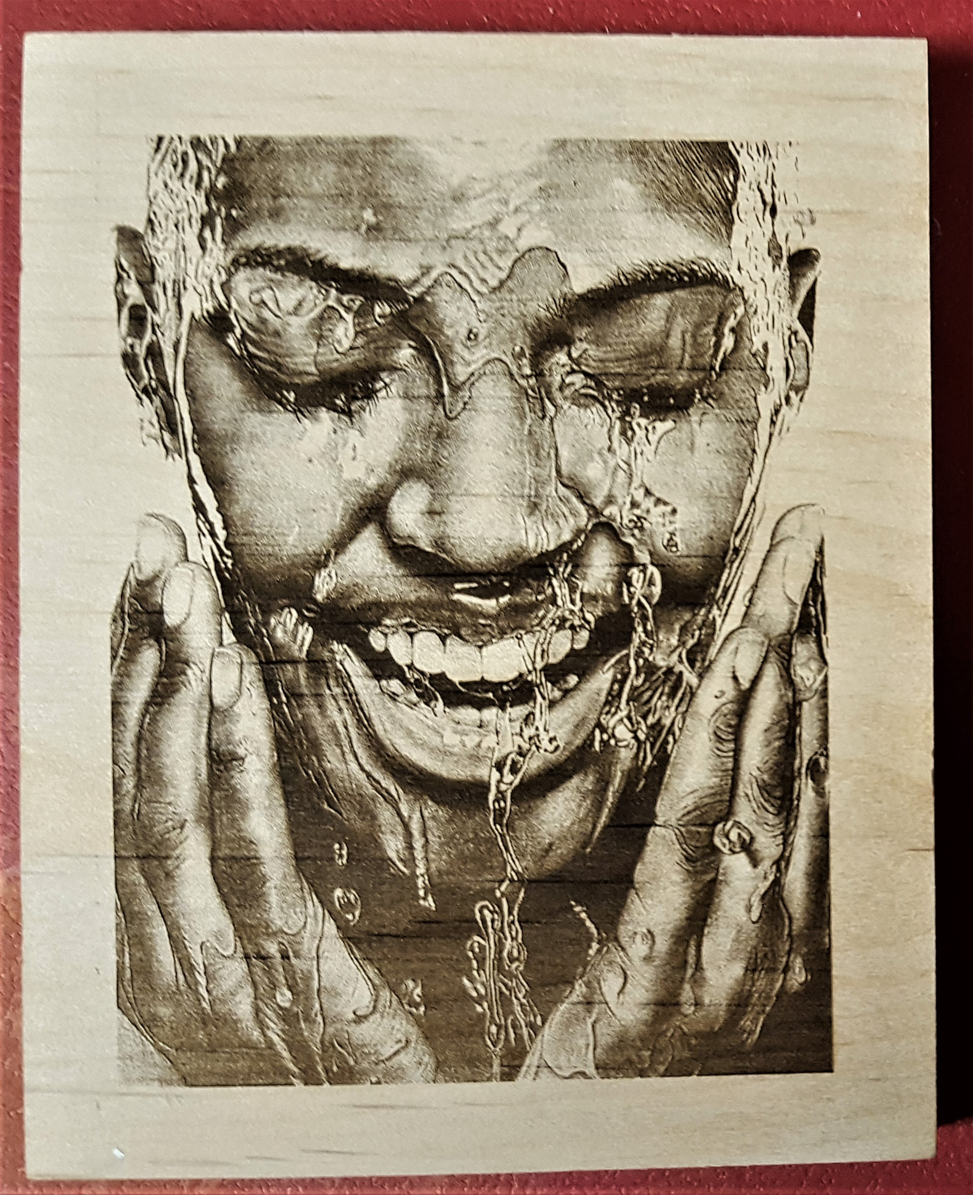

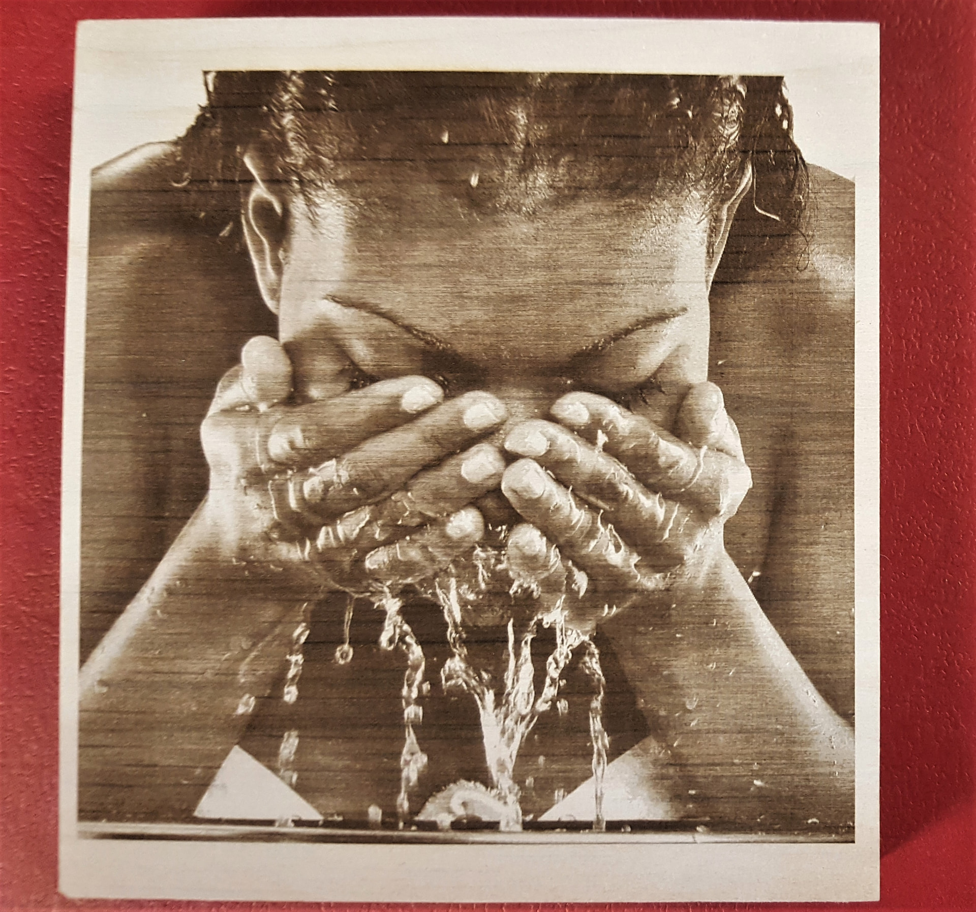

@DBat STAY AWAY FROM greyscale
You require proper wood (Alder)
You require knowledge of Tonal Adjustments
Most Diode and Co2 struggle with PWM
Start simple with Vectors using LightBurn Stucki or Jarvis
I spend HOURS with Greyscale on 5 watt diode
Good results BUT when tuned in to dithers ..not worth the effort
These are greyscale using Alder wood
LOTS of failures dialing in
