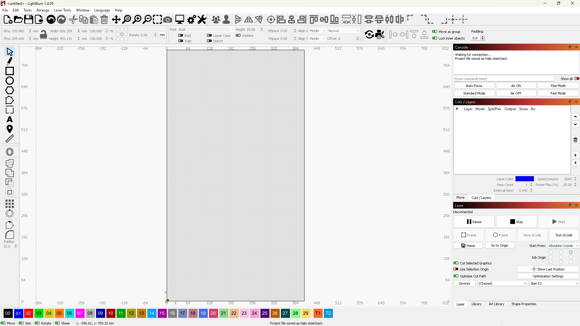

Had to look. So it is! My laptop is 1920x1080, but doesn’t seem that wide. Must be an optical illusion. Maybe because I’m looking at the forum on a portrait phone screen.
When I spent my days behind a desk, I had three monitors. Invaluable real estate for multi-tasking and complex workflows. Spreadsheet and email split on 1, blueprint on 2, 3D model/render on 3. Sometimes I miss it.
You might also have your font scaling turned up. Mine is 100%, but many run 125% or even 150%, and that ends up costing a decent chunk of screen real estate.
i was going to say too, in that image a lot of the top toolbars were taken away so all is a looks more roomy and streched
I like buttons! I have my font set to normal but tool icons set to “larger”. Interesting to see how people choose to set up their workspace. What a great piece of software!
