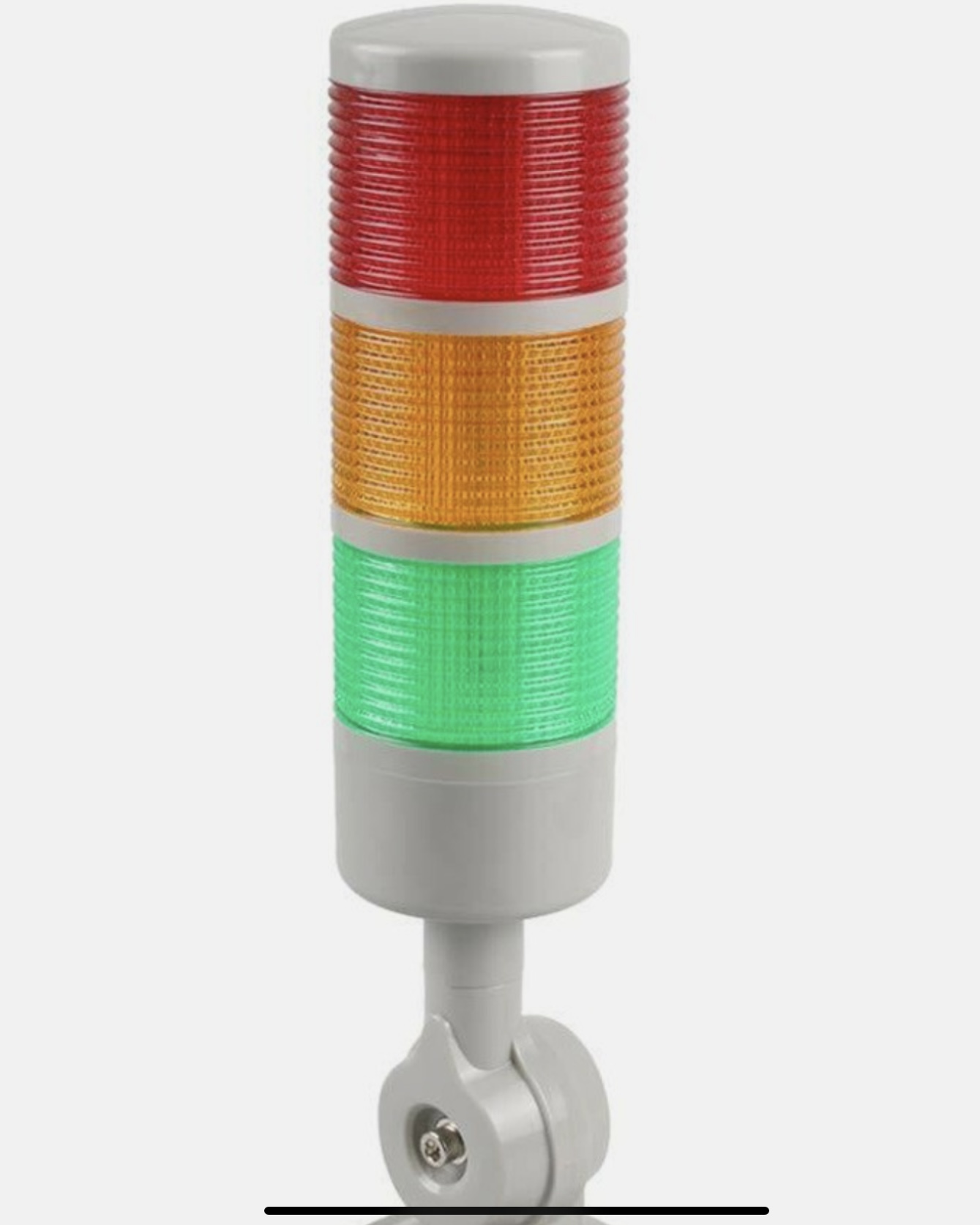

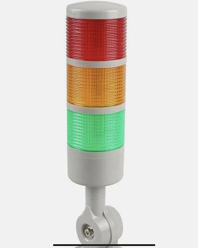

Next project is to install a three tier Status Lamp indicator
My laser has a built in water chiller, with alarm outputs so the Red will be the
Water Alarm
Yellow will be Door ( lid) open/closed
Green will be LASER ON…
(kinda like getting the New 65 Mustang convertable…I had one)
Ya have to get the New 8 Track Tape deck installed, and Pin Strips to make it look cool !
So cool now I have to get a second to put outside the door :slight_smile:
I think Jim may be getting the 12V and Grounds confused…
I know mine has a common ground and 12-24v feed for the colors (OH and a buzzer).
So I know I will have to break out each LED in the light as separate wires to hook to the Chiller and Ruida Controller… all doable… just need to make time…

Just a quick note…
if you are thinking of a Status Light…

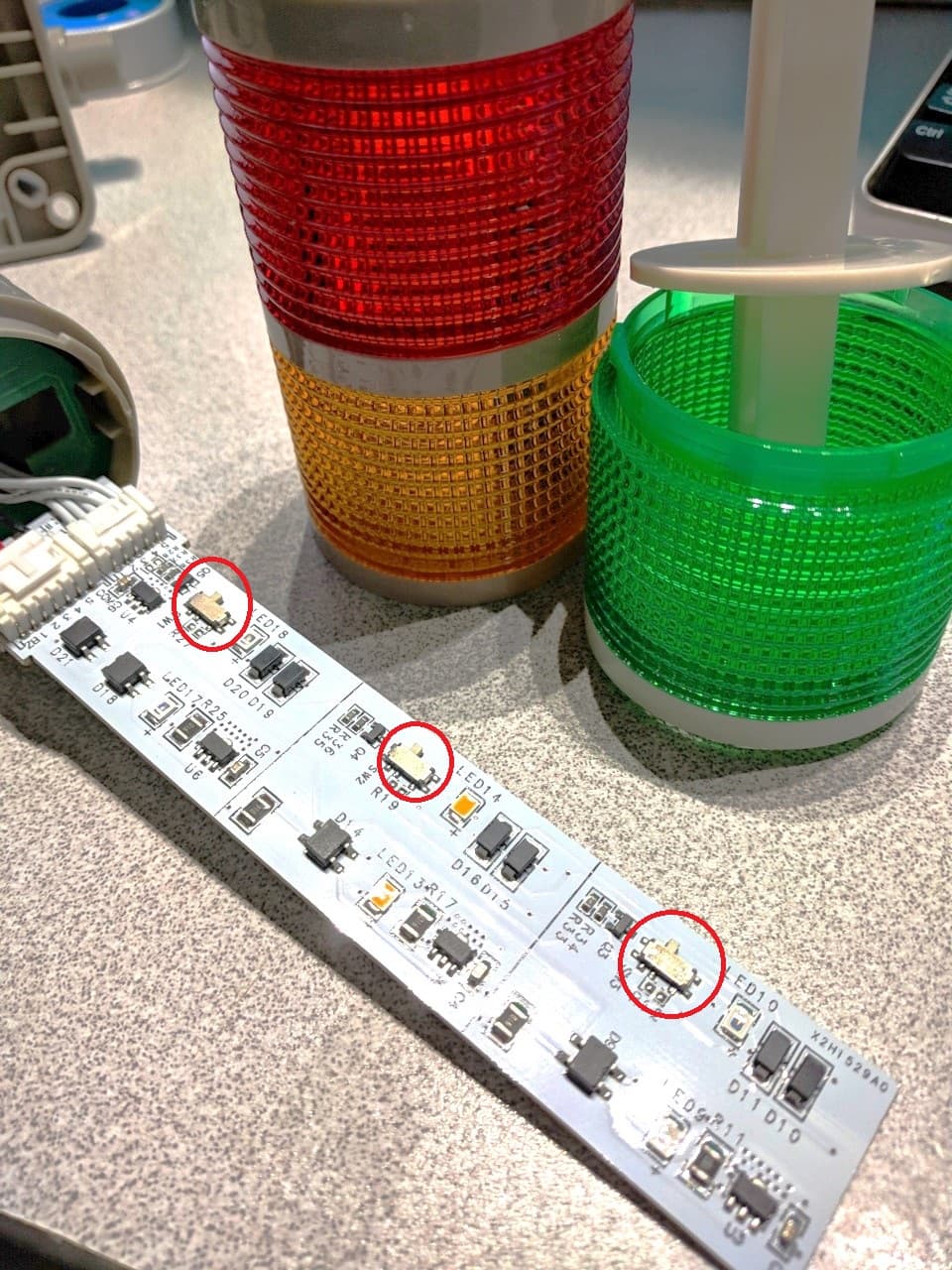

This morning I opened up the unit I bought off ebay in a effort to rewire
and found ‘switches’ on each tier color…
Flipped them and the Lights BLINK :slight_smile:
Kinda nice feature, unexepected, but then the chinese brand no instructions… .expected !

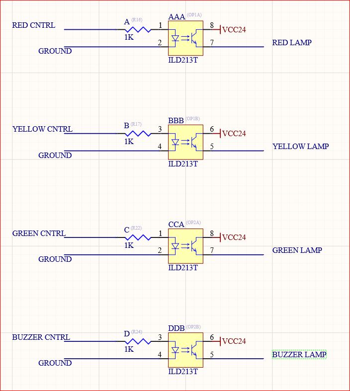

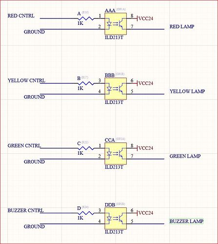

I plan on putting some small opto-isolators on each lamp to give independent
12-24V / Gound wires to allow wiring up for 24V feed or Ground Control.
Plenty of room inside the unit…

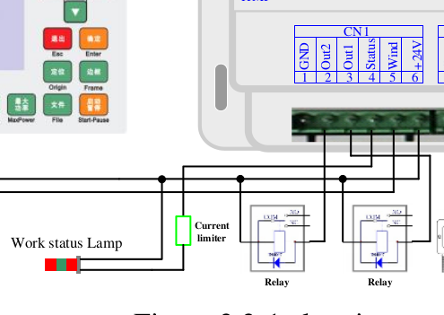

All of these functions are available via the Status, Out1 and Out2 sinks of the Ruida.

Yes… Sink… this lamp has 12-24v input for each lite…
need to use a few optos and give some independent control over the Pos /Neg…
plus there is some active ckty on this lamp that will need power so I also need
Supply input to power the lamp
24V power
Gnd Ground
All easy stuff…
Generally speaking, when using open collector like this, the load has the 24V and the open collector completes the ground. The load can change what the opto sees as ground if the power is switched to the load, instead of the completing the ground path.
I’d connect the lamp to 24V, then to pin 6 of the opto – pin 5 to ground. This is how all the Ruida documentation is laid out.
I run these directly, sans any optical isolators.
Good luck

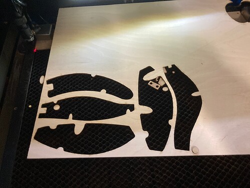

Wow. I wonder what I’m doing wrong? I have seen none of these issues with my ThunderLaser Nova 24. It cuts acrylic as smooth as glass as well as other materials. Still using the honeycomb that was supplied with the machine…
J
I agree, but this lamp uses a common ground and each color needs 24vdc input…
if it was reversed… golden :slight_smile:
Share your secret for no flashback on the bottom side …
Maybe its a coated non reflective honeycomb.

I’ll be having three lights near my machine also:-
Water heating
Steam building
Latte ready
Thought there would be a mention of Coors Light :wink:

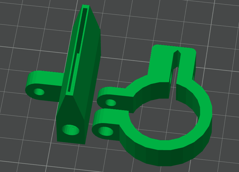

I have another project going… gonna try focused air on some cutting…
Low pressure High Pressure , pushing some air ‘across’ the part instead of down the cut line…maybe enough to just move the cut vapors out of the cut channel to let the cutting be a little more effective… Theory only…
this may keep the cut a bit more polished!
Should prove interesting… I’ll 3D Print the part when I get to work and try the 2.5" lens with some 10mm Cast acrylic…
More to come…
If this has any improvement, anyone needing the .STL files let me know…
Happy to share…
If anyone has done this let me know…it fits a 25mm barrel

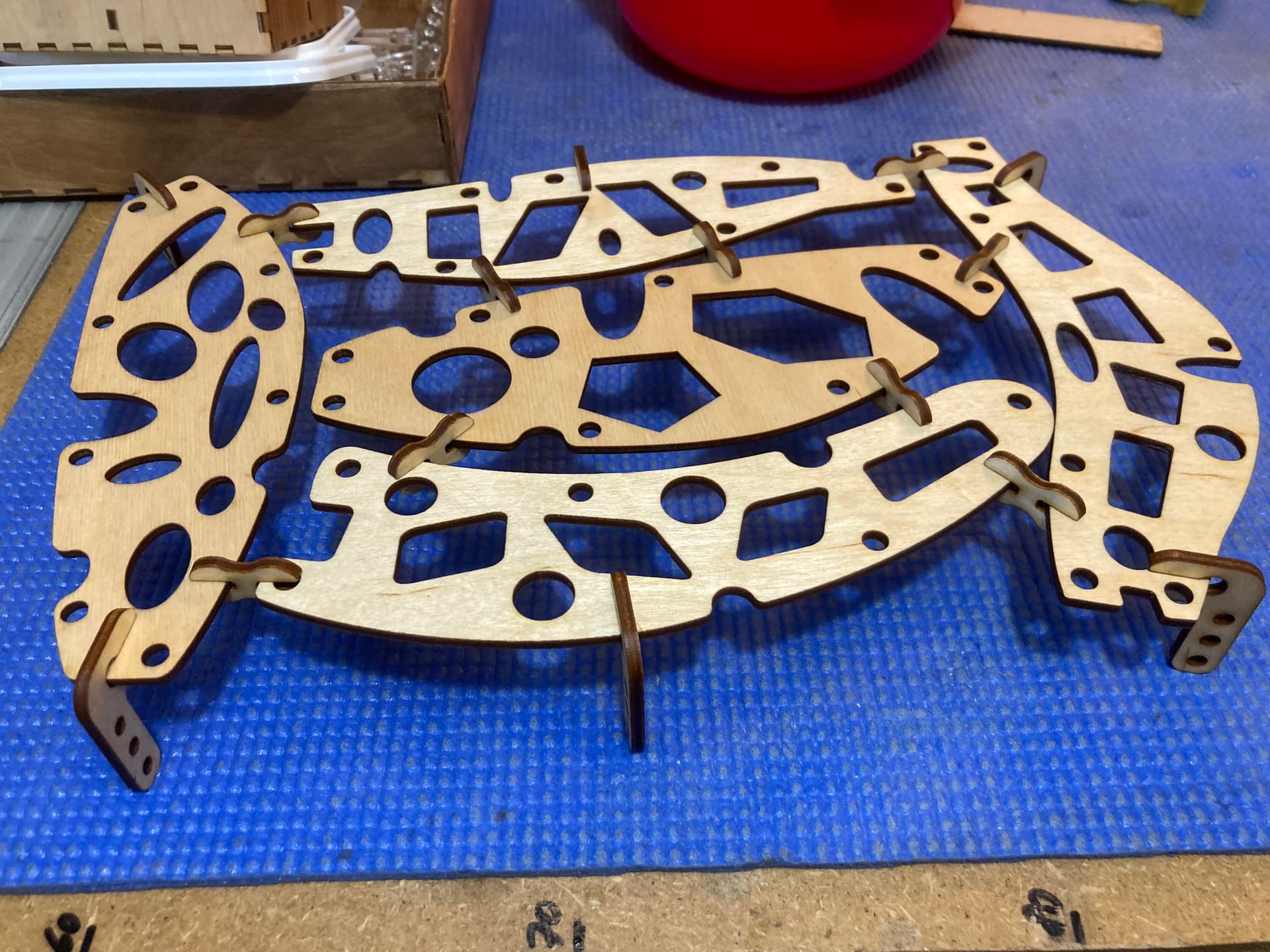

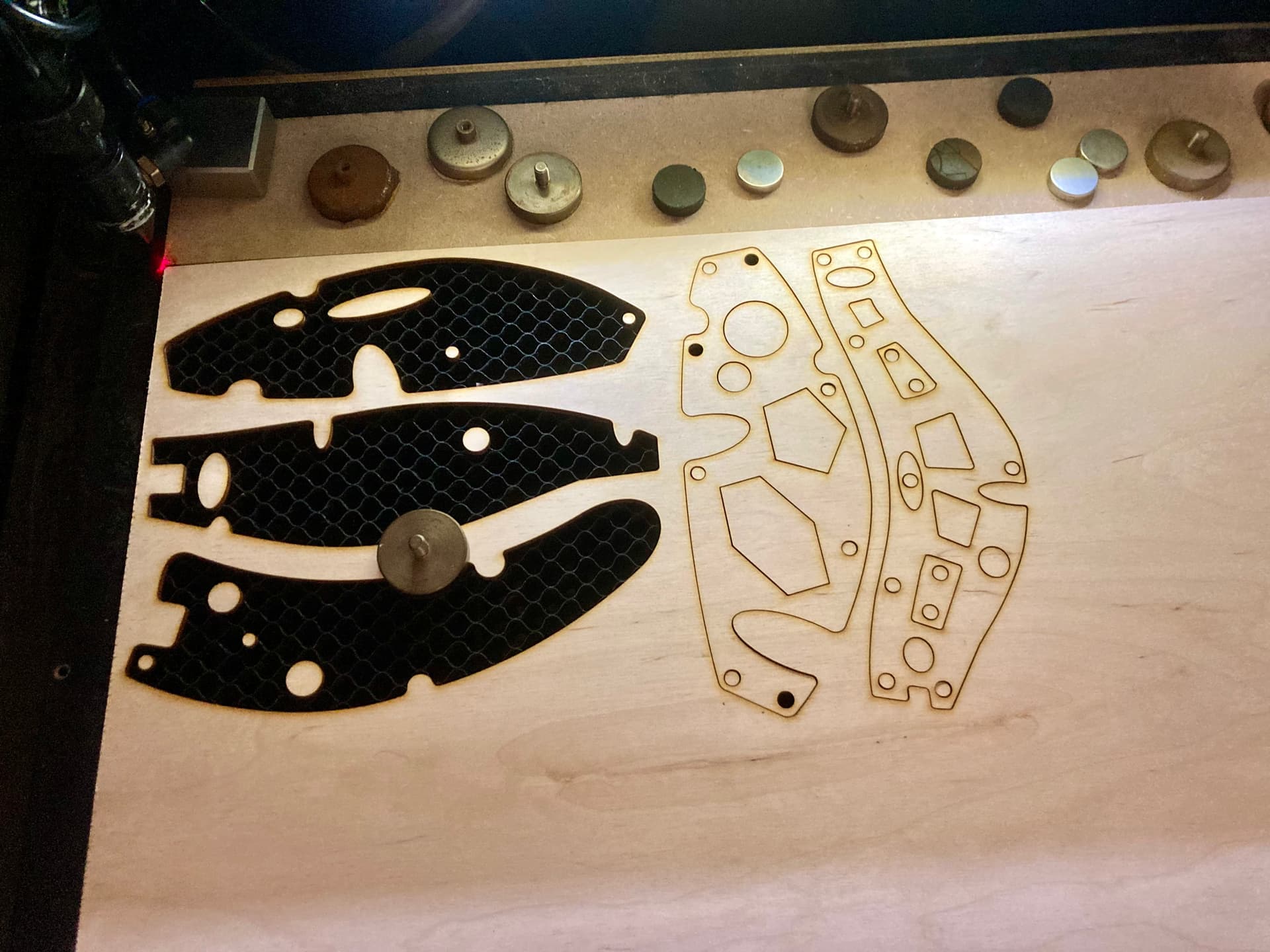

Here are pictures as promised, not 0.8mm but of 3mm plywood cut directly on my Honeycomb, right now. The reflexions from Honeycomb can be clearly seen, but again the result is very useful. You could dry off the items with alcohol if you think.
It’s front, back and parts
What speed n power are you using ?
What are those parts ??
I used 20mm/s at 30% min and max power, that corresponds to about 5mA (forgot to check if it’s still true)
The parts are used to place flower decorations, above containers/vases of different sizes. It is custom work and it was fun to discuss with the flower lady how it should be used and work.
Did you sand them any I see some burn marks along the edges but none on the,parts /…
Was there air assist?
