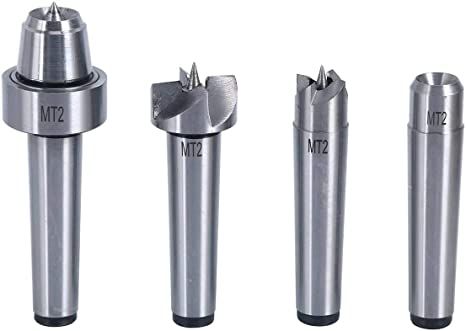

I just looked at that, this is what I meant about a spar drive, it goes into the headstock

Those look like they have a taper (R8?) and even if you shortened the shaft, the taper would prevent a good flat grip by the chuck jaws. You would get a better grip on the wood instead. You would have no need for the spar because there is no turning torque resistance on the wood dowel.
You might simulate the spar by using a butterfly bit with most of the shaft whacked off.
I have plenty of M2 spar drives. The difference is an R8 has a taper of around 3.5" per ft where as an M2 has a taper of around 0.6" per foot.

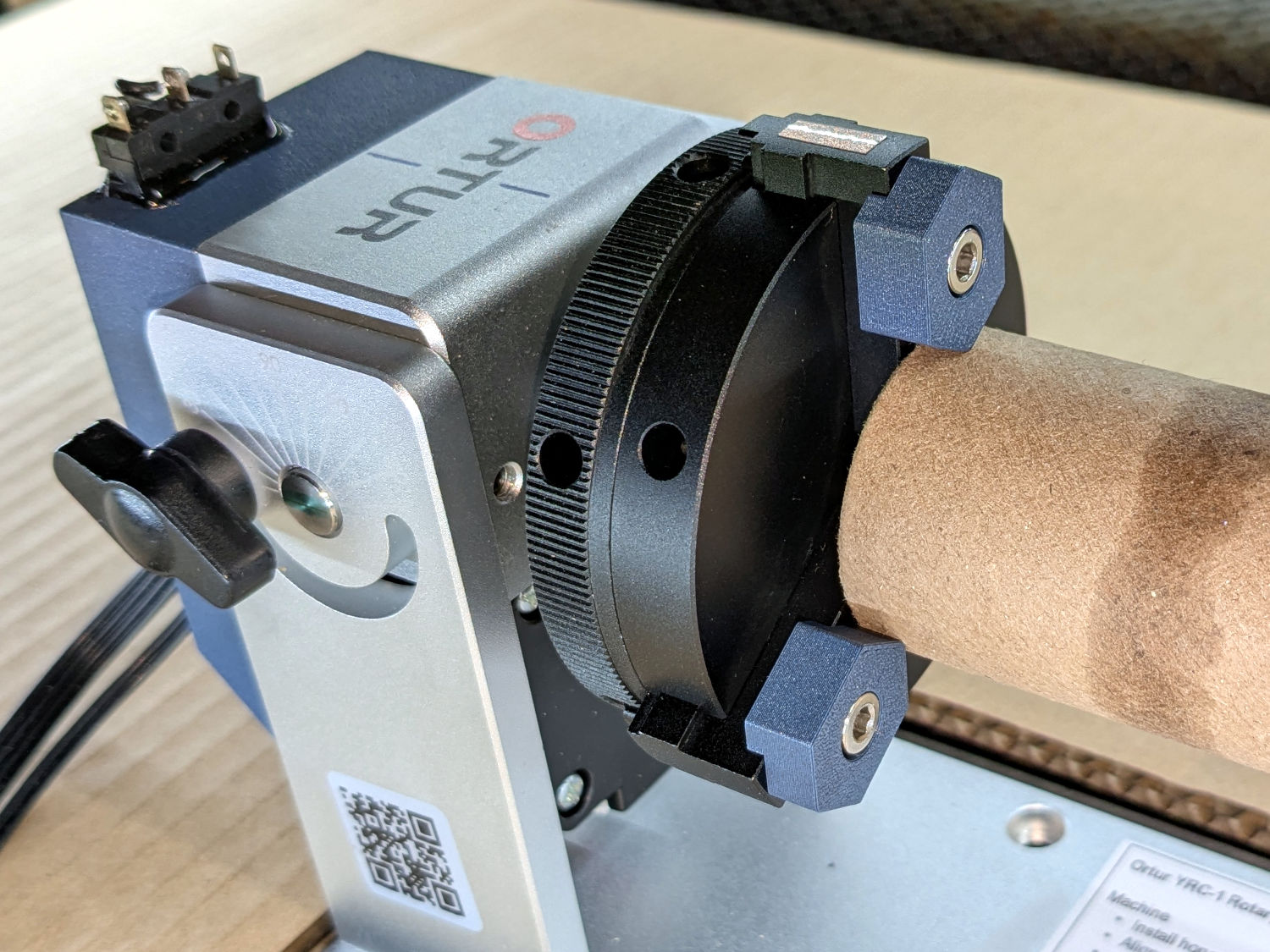

My chuck has plastic jaws, and I suspect the rest do as well. You will not be able to clamp like you do with metal jaws. I still think you will not need a spar. The 3-jaw chucks are self-centering.

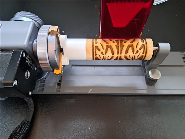

The jaws don’t do much work, so little bitty 3D-printed ones suffice for the Ortur YRC-1 I hacked into my CO₂:

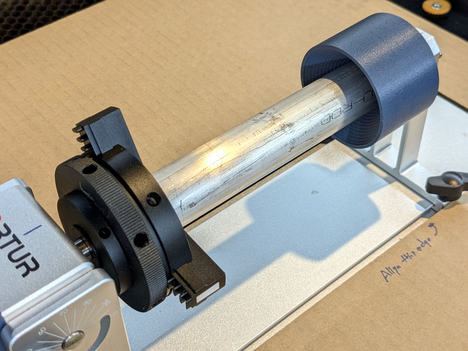

It has a tiny tailstock benefiting from a larger cup center:
(That’s an aluminum rod for sizing; I know bare alumInum shrugs off an ordinary CO₂ laser. :grin:)

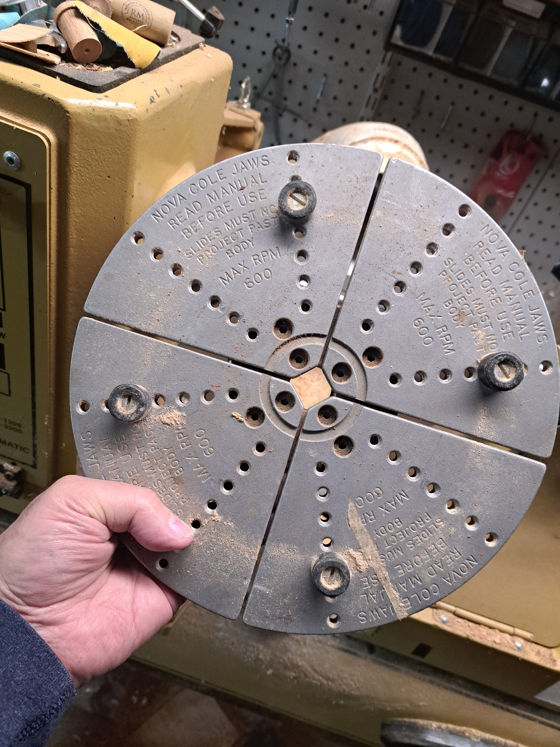

This is a set of cole jaws for a wood lathe which I don’t use since I made myself a vacuum chuck.

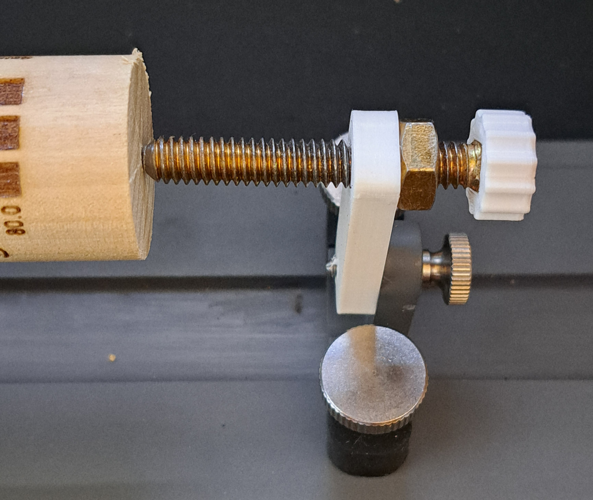

What is the advantage of this over the tailstock in the previous image?
p.s. Is that white plastic Starboard or Seaboard?
I believe is to increase the distance to the bed.
The other one had a little wabble because of the center pin I made to use as a live center
This one I’ll never have to level the wooden rounds that I will be engraving. Everything will always be perfectly centered, squared and level. Plus, it’s a lot easier to place and remove the stock.
3D printed PLA. Should be ok, there is hardly any torque involved.
I thought the bolt was brass but when I had it on the lathe I found that it was steel.
The suction cup or the rollers on the AtomStack tailstock leaves a lot to be desired. But it isn’t fair to compare this item with a full blown lathe.
The Atomstack comes with an extension for the bed, easily fits 12" (30mm) or more
