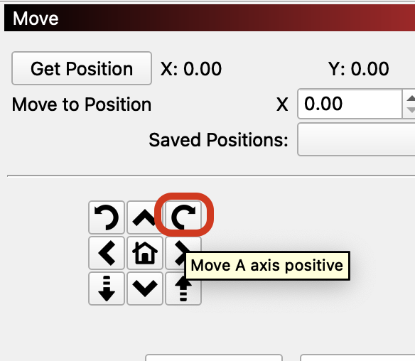

I suppose, you are referring to this button in the Move window. Is that correct?

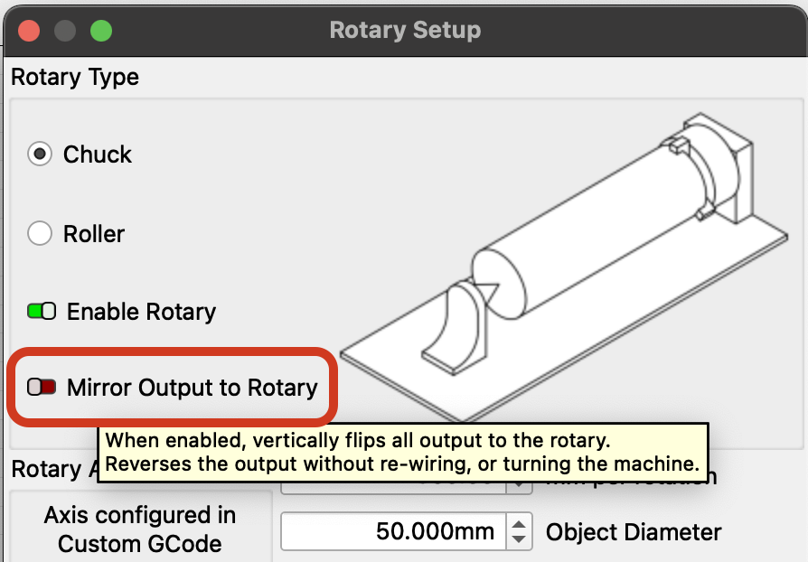

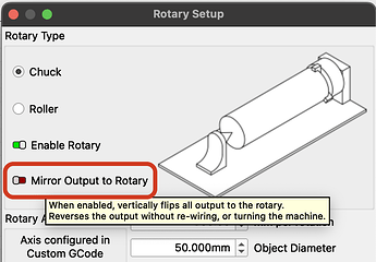

What’s the status of this setting in the Rotary Setup, and does switching this change the behavior?

No, the other rotary jog button, to the left of what you have circled. the CCW direction. The button you have circled I’m referring to as CW direction, and it works fine.

I’d be curious to know, if the behavior changes, when you toggle the ā€œMirror Output to Rotaryā€ option.

Status of ā€˜Mirror Output to Rotary’ = OFF
When flipping to ON, the cutting output is mirrored vertically (along the rotary axis as mirroring line) which is normal as I understand it.

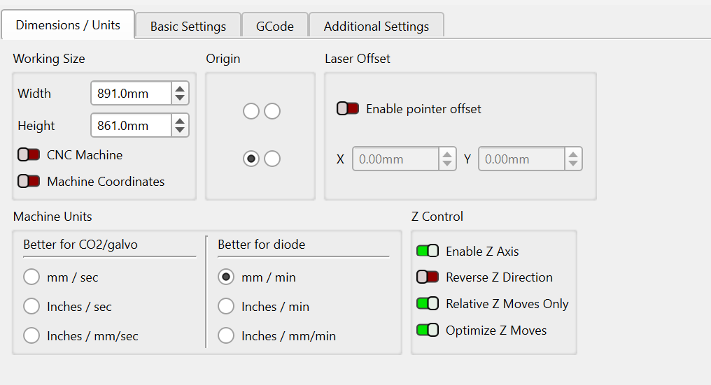

in case you need device settings-
