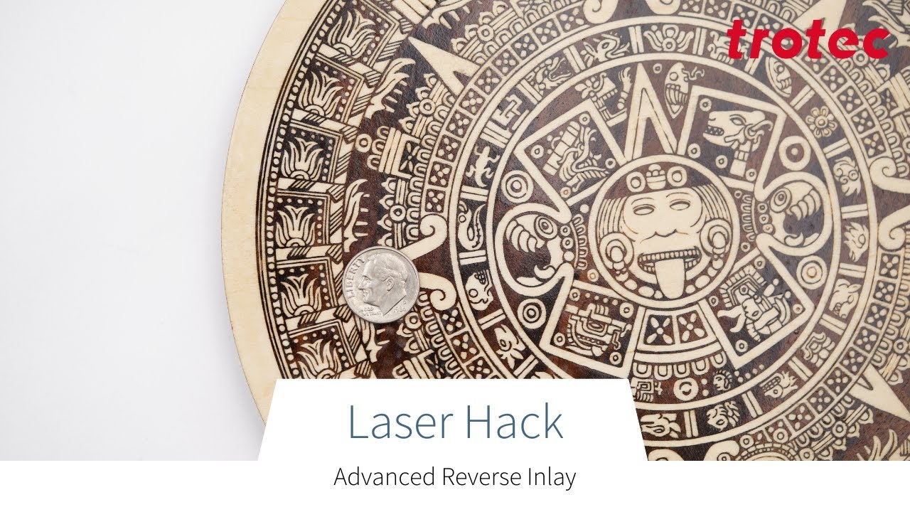

Been wanting to try an inlay… Do you do it like this trotek video?
What type of wood works best from your experience?
Material that gives a “hard” edge when processing. Eg. I have had good results with HDF/MDF and hard veneer is also fine. It is also ok with one “soft” material, it must then have an ant’s hair more in kerf and a hammer :wink:
